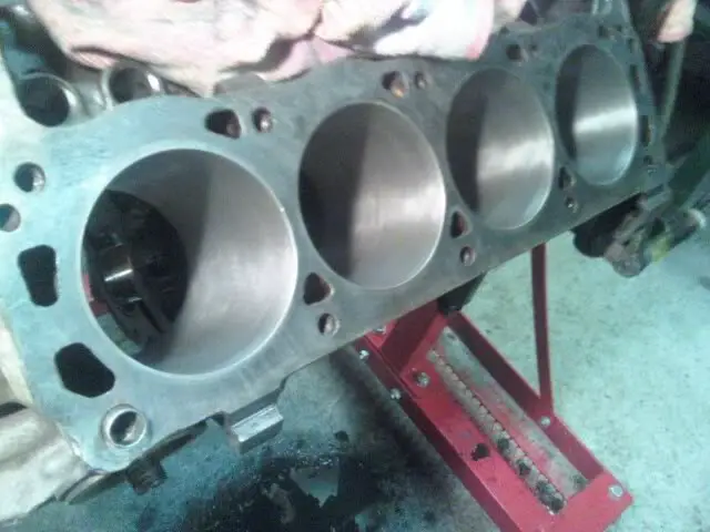

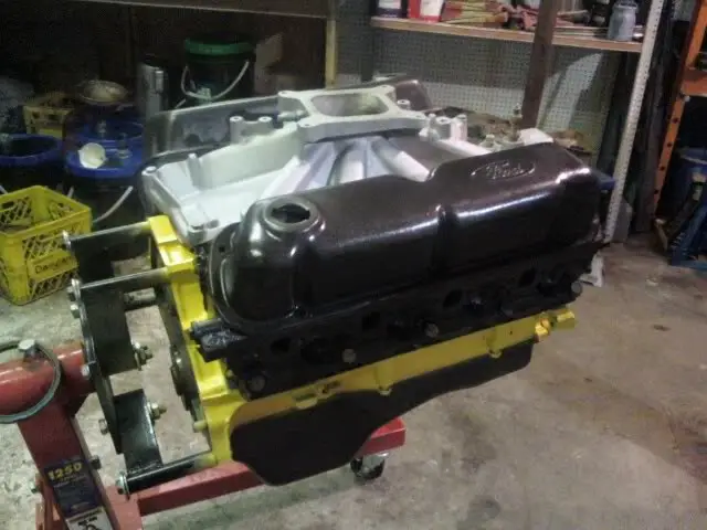

I found a 1980 302 v8 block complete, out of an f150. Tore the motor apart,bore and stroked it to 347, went forged crank, h-beam rods, K.B pistons, high lift cam, roller rockers, 10 thou deck on the heads with new tit. springs and valves, ported the heads on both sides and did the chambers. edelbrock top end, torker2 manifold marine issue(bigger water jackets), 900cfm carb,electric water pump,block hugger exhaust headers, remote oil filter and dual point ignition because I like it that way !!!! LOL rated around 450 hp in a small block :D and ran 3 " pipes off headers to rear on dual setup with x pipe exits on left and right just before back tires.:D and some chrome tips
Now......New motor built.....Tranny ??? I went with an AOD from an efi fullsize bronco 4x4, I modified the tail-section to accept the WONDERFUL NEW-PROCESS 205......and custom drive-shafts built front and rear with custom mounts ( high tower mounts to keep it close to body, I have a 4" body lift into it as well ) for engine and tranny and an extra one on the t-case going to frame rail on left side for strength.....;)

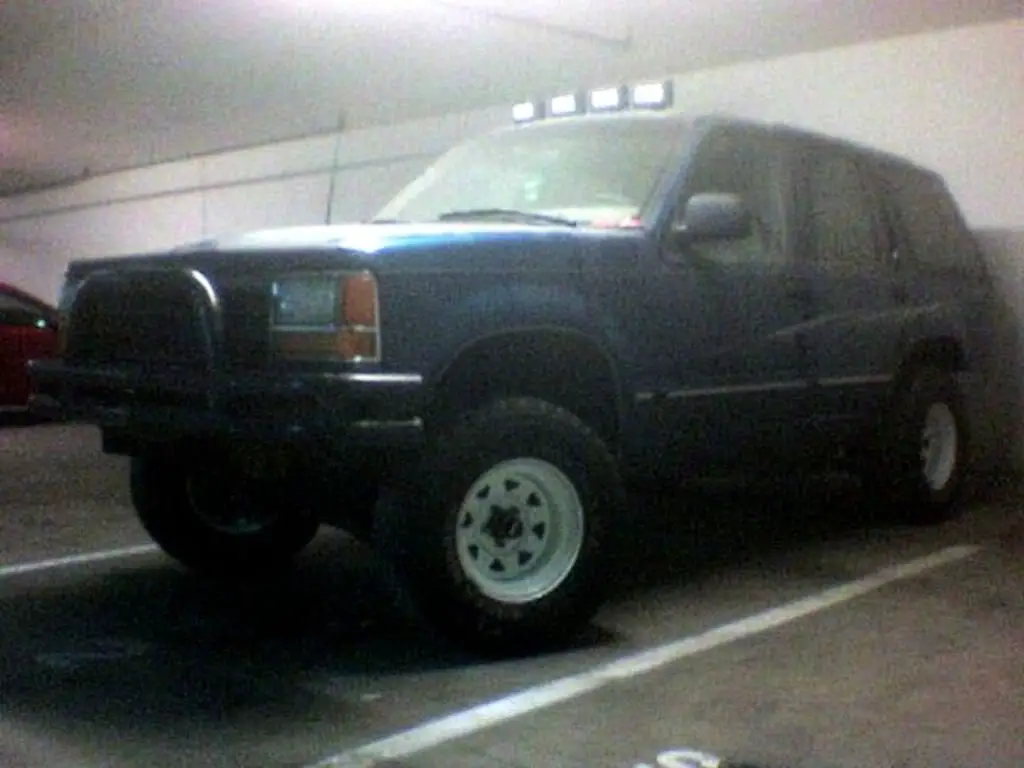

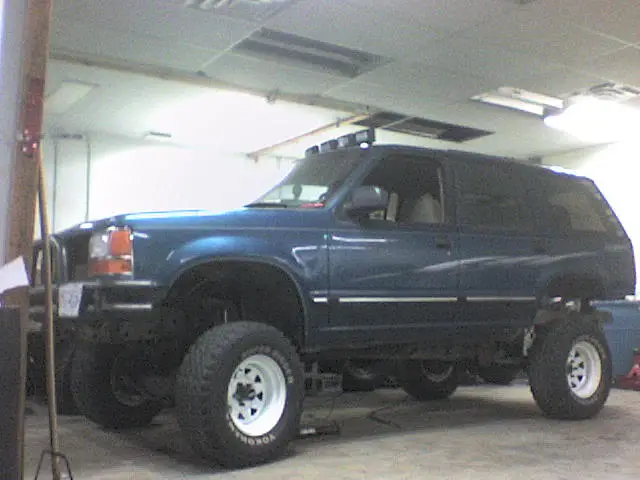

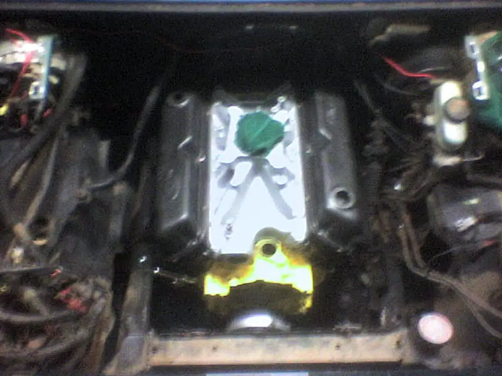

ok, still sorting pics, ran down to parkade and snapped some pics for all to see for now...
http://s1188.photobucket.com/albums/z407/nastyexploder/
let me know what you all think ????????

looks like you have some camber issues in that first picture. otherwise ...
very, very cool:thumbsup:

Click the bottom link to get his bigger pics. Usually to show the actual pictures here, copy the link that has the img tags. But anyway the truck looks good.
April 16, 2009
33
Victoria , B.C
92 Explorer 4x4
yes, i do, LOL waiting on superrunner steering kit, doing new ball joints and putting in adjustable camber sleeves. should fix the problem.

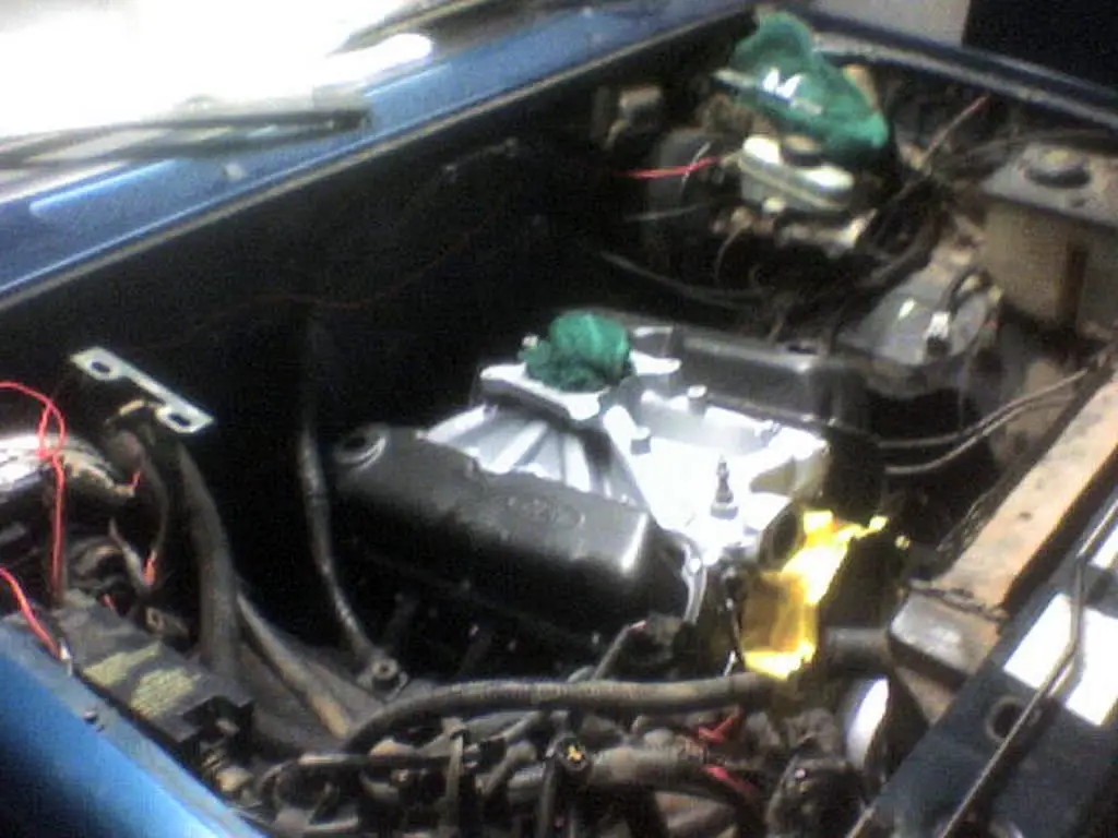

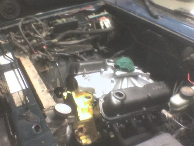

Looks sick. Under the hood is the best part:thumbsup:
April 16, 2009
33
Victoria , B.C
92 Explorer 4x4
Thanks, the motor is the best part......i agree LOL

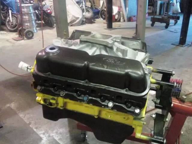

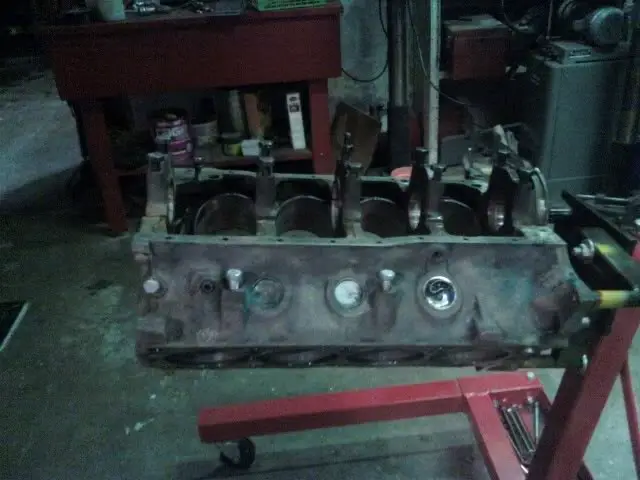

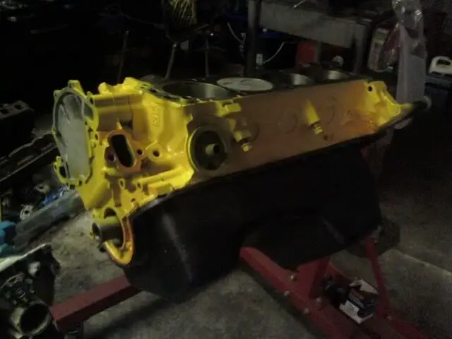

just some more pic's i found, the one with me next to the truck is an OLD one, 1 month after I got the X from friend at work back in 02. 1st thing I did was the body lift of 4", kit from performance accessories, it is a good kit. I did modify it thou, better grade 8 bolts and huge washers and 1 hockey puck for every mount, was a 3 inch kit now a 4".
I wheeled it as it was for two years, blew the headgaskets on both sides :rolleyes: and drowned the truck twice :nono: , never did hydrolock on me and mostly made it home from bush. Then I started to get that famous lifter noise from the 4.0 :rolleyes: , worse and worse it got, I was not tearing it apart again to fix it so........JUNK !!!! only time i left it in the bush was when the passenger side studs in the disc all came out after a bit of a bump, the wheel went down a hill 700ft or so....lol :eek: but i was able to stop the truck from 60 kmh pretty quick LOL. Then I did not do much to it but let it sit after i gutted it and stockpile parts for about a year and a half. My Dad and I built the motor together as a father son project he is almost 62 I am 28 so it was interesting as we both have our own way LOL :rolleyes: The blue Blazer is my in-law's, gone to chevy heaven. I am still looking for the motor build pic's they are pretty cool, show's all the custom work being done, porting before and after shots and all that kinda stuff.

found some more pic's, I can not find the one's of new parts before they went in block, nice shots they were.......
with all the views my threads had, there is not many comments ????? good or bad I am not sure......LOL:D
the AOD trans is painted a light grey with same yellow on pan as block and the t-case was rebuilt and painted same yellow as well.
