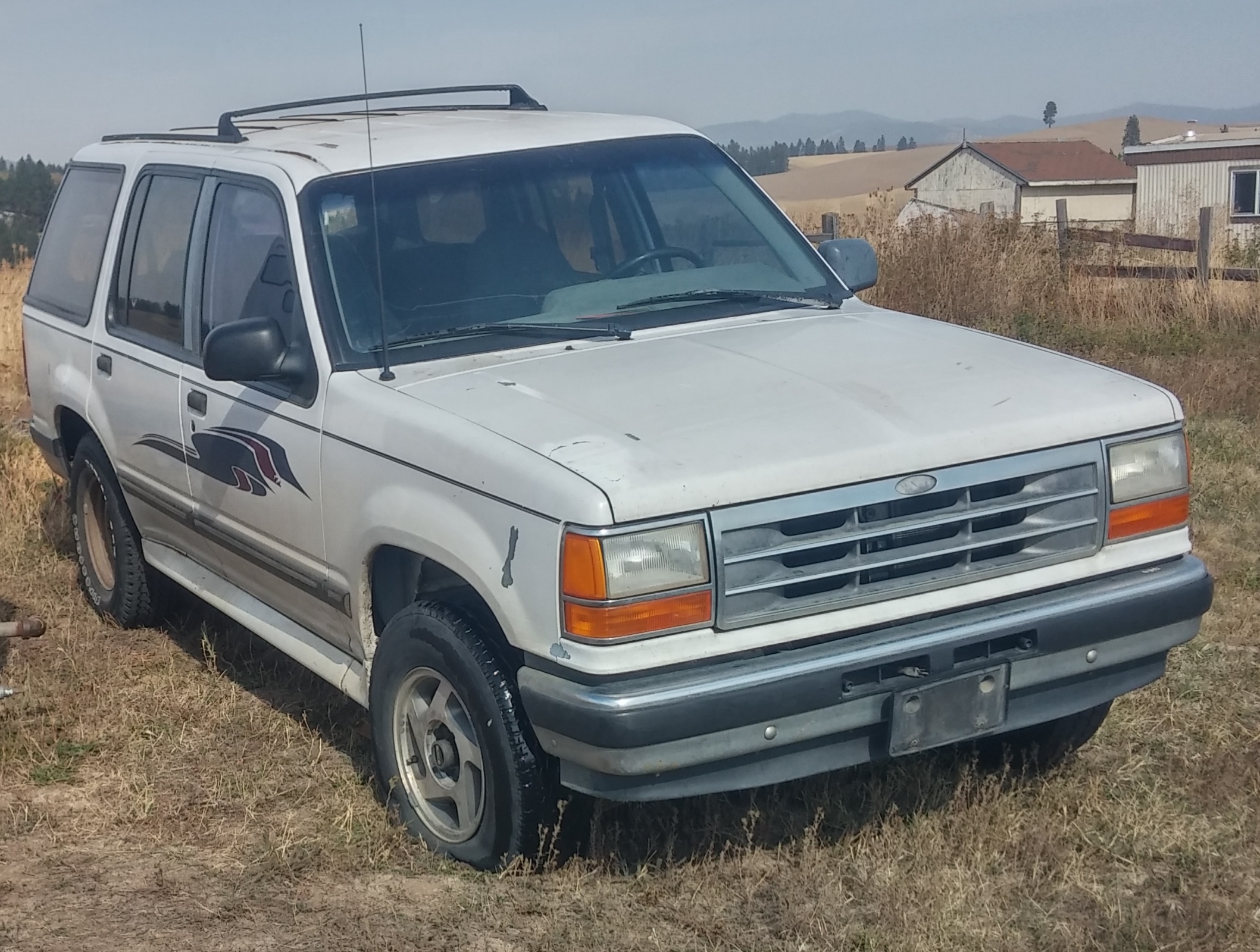

How it looked when I first saw it:
https://dl.dropboxusercontent.com/u/464376/vehicles/1994 Explorer/Pictures/2015-10-02 12.08.04.jpg
Looked good. Straight body with only minor accident damage to the right rear area, looked like something rammed right into the tail light, which got replaced. Mixed & matched tires with the front ones having obvious ball joint/alignment issues. Most of the tires were from 2001, aside from the factory spare. There were oil drips on the ground which I quickly found out were from ATF puking out of the loose power steering cap, many things inside the engine compartment on the driver's side got hosed with it. The fluids looked fine and were all separate. Coolant was low but not rusty or cloudy (though, it could be all settled) Oil was dark but had no sediment/particles on the dipstick and was not milky. The transmission fluid is in dire need of help though, really no pink/red color left and has a gritty feel.
