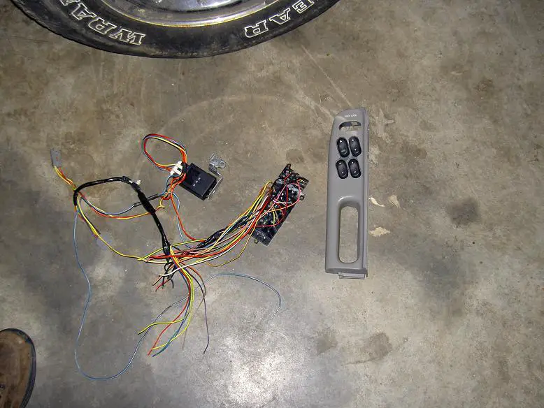

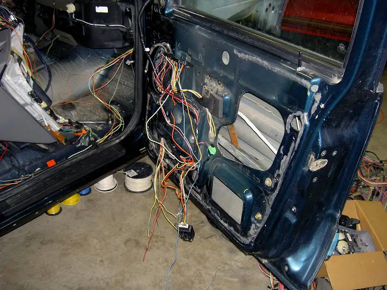

Below is a picture with that auto window module, the black box, from my 93's LF door. The modules found in mid 90's Taurus's are easier to come by, and they wire in the same way. There is a thread or two in here with step by step instructions. At least one company makes a kit for about $25 that includes a module like those.
Ah, thats great and a good add for our "what could have been" project
Thanks for the info on that....very helpful
Cool, the wiring isn't too bad, the trick is to look at your current wiring, there's about five wires there.
