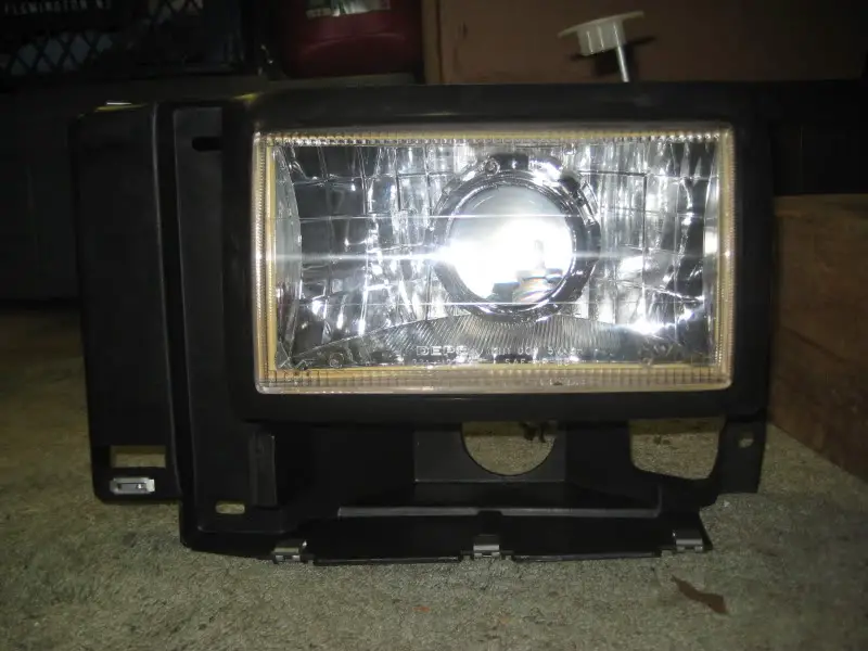

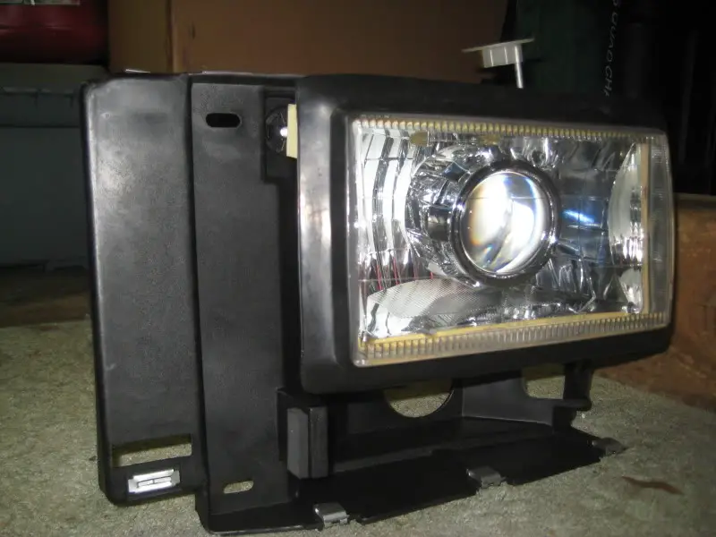

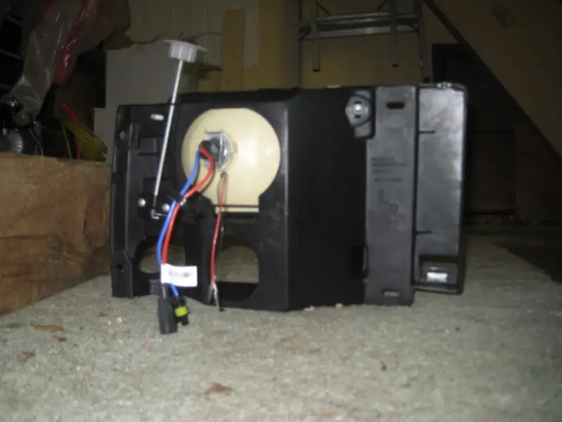

So far I've tweaked both projectors, opened both housings, and have one side just about done. I won't seal it up until I can mount the headlight on the truck and check the rotational alignment, then I will seal the lens on...
As far as I know, this will be the first 91-94 explorer with projectors....

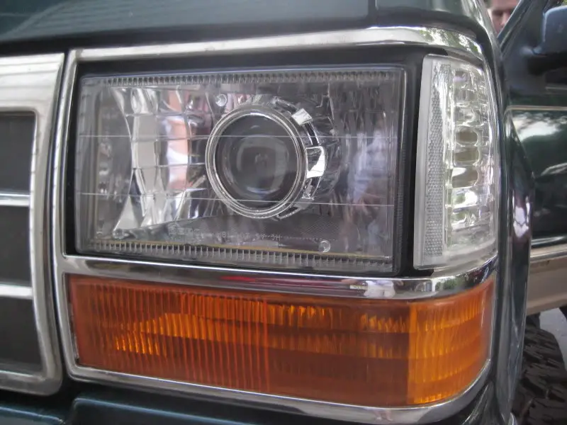

I know of at least 1 other guy who did them into his stock fluted headlamps, but great job on a great looking retrofit. Can't wait to see your installed pics and pics of the beam to show those guys with the retrofit bulbs just what they are missing.
wow, what a waste...
ok, rephrase... I'll probably be the first to do it correctly :D
I can't stress how friggin awesome these look...anyone want my old silverstars? :P
I thought that was your truck, LiKuiD. Looks awesome, great job dreddog.
HID done right is a beautiful thing:thumbsup:

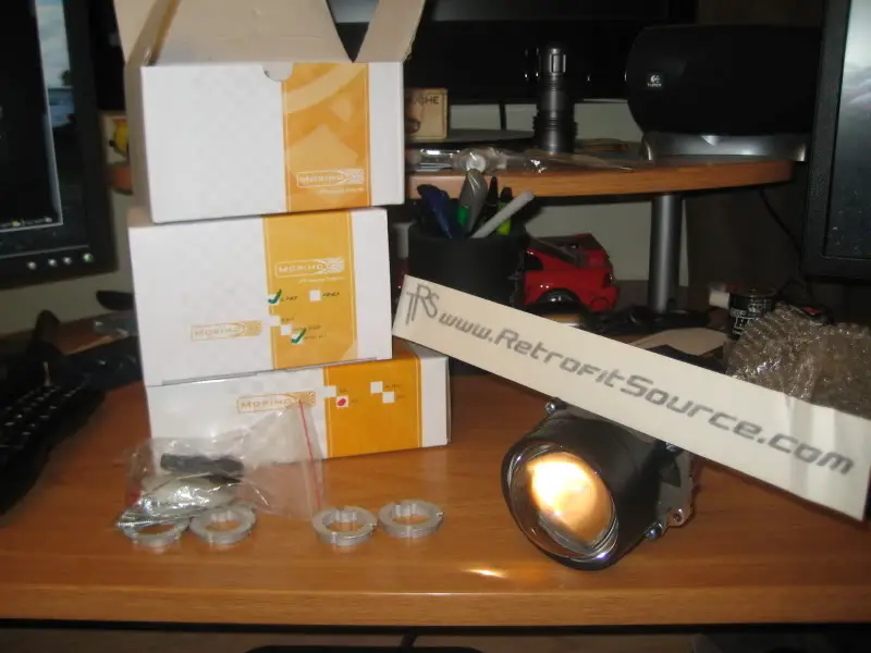

The next set of projectors I'm retrofitting are a set of hella E55's which use a D2S bulb.... The only downside most people see about the MH1 is that it uses a H1 bulb, but the morimoto bulbs are OEM quality, and the beam from the MH1 is actually wider then the MD2S...
The projectors/bulbs/ballasts/harness and misc odds and ends cost 270+ free shipping
The headlights I believe were around 150+ free shipping... I couldn't find any place that sold just the headlights.... See thread

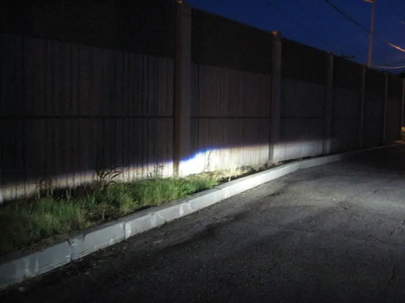

the MH1 will leak a little light out, the only way to fully fix this is cover the gap in aluminum tape before putting the shroud on. Honestly, its not enough to bother anyone, it just gives the housing a little bit of a glow....
I think the explorer does this less then my bronco though. In short, its nothing to worry about
