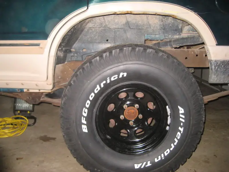

33x12.5R15 BFGoodrich All terrain A/T KO's on 15x8 Cragar soft 8's

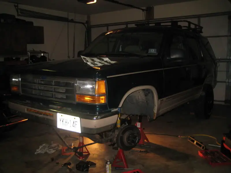

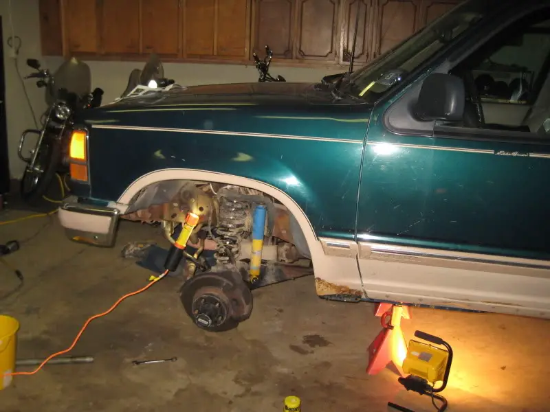

So today the 4" rough country lift was started.....
V8BoatBuilder, LikuiD and I started around 8:30am and finished around 9pm.... The front is virtually done, one of the brake lines in the procomp pack doesn't fit. Otherwise its almost ready to have the new cragar soft 8's and 33's put on....

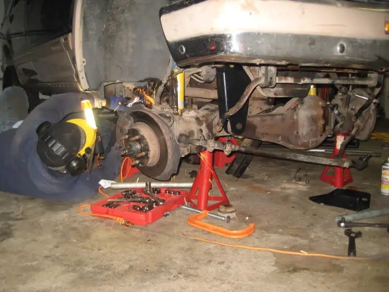

Getting started

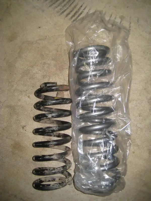

Compressing the old spring, LikUiD on the left, V8BB on the right

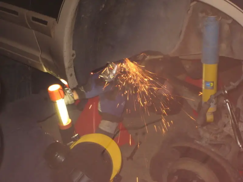

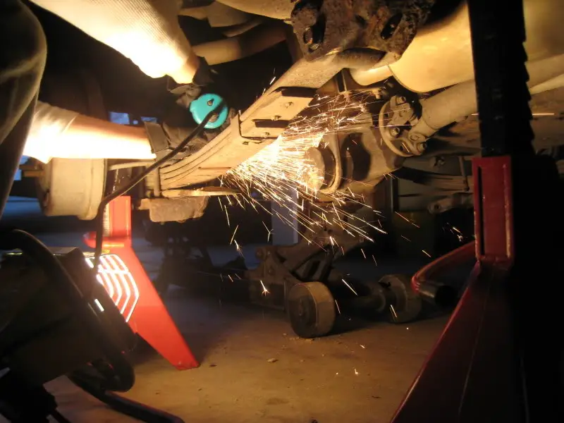

V8BB grinding the hell out of something....

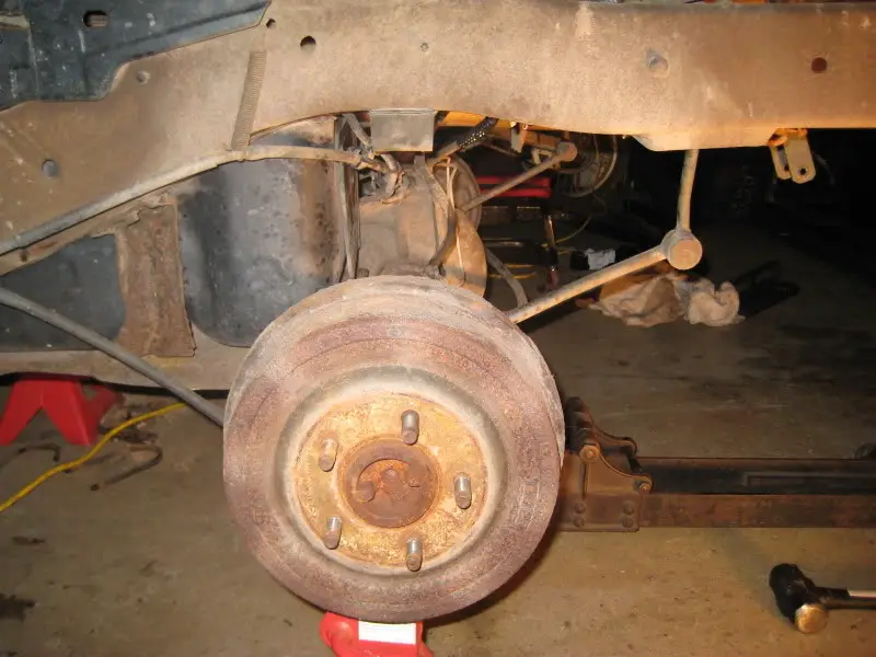

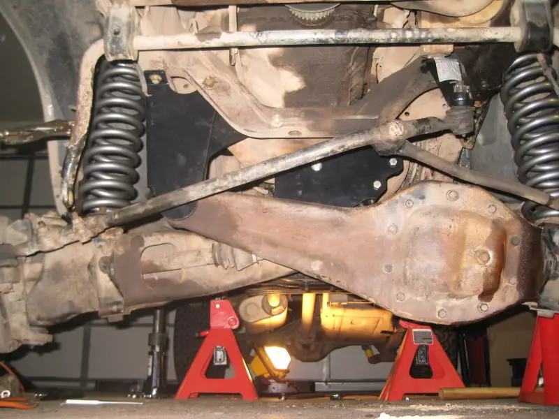

Upon getting the rivets out of one of the TTB brackets, the air chisel kicked up alot of concrete dust
Brackets on
Coils in

(I was grinding off the pass-side beam pivot mount rivet heads and a cross-threaded bolt on the pass-side RA mount)
Lookin' shaaaaarp!!
Ah, I wasn't paying close enough attention ;)

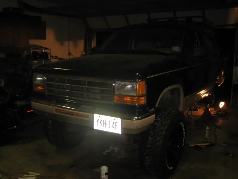

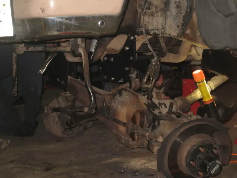

So the front is pretty much wrapped up, it just needs one brake line on the pass side.

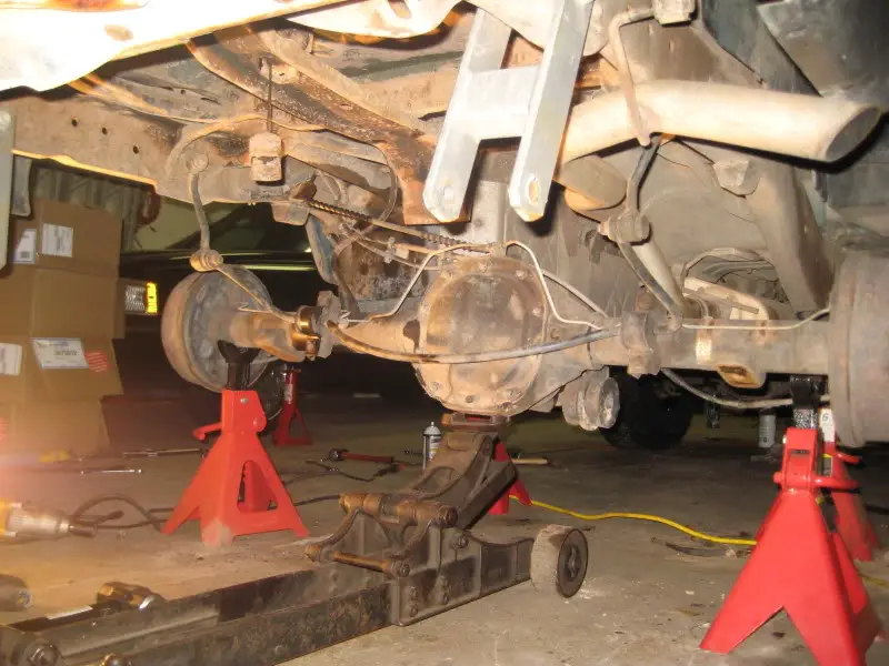

Started on the rear, its almost done, except the axle isn't centered on the leafs so it will have to come apart again to fix.
Cutting U bolts
Ahh, the sweet pictures of success. Big thanks to my brother and Aaron for all their help!

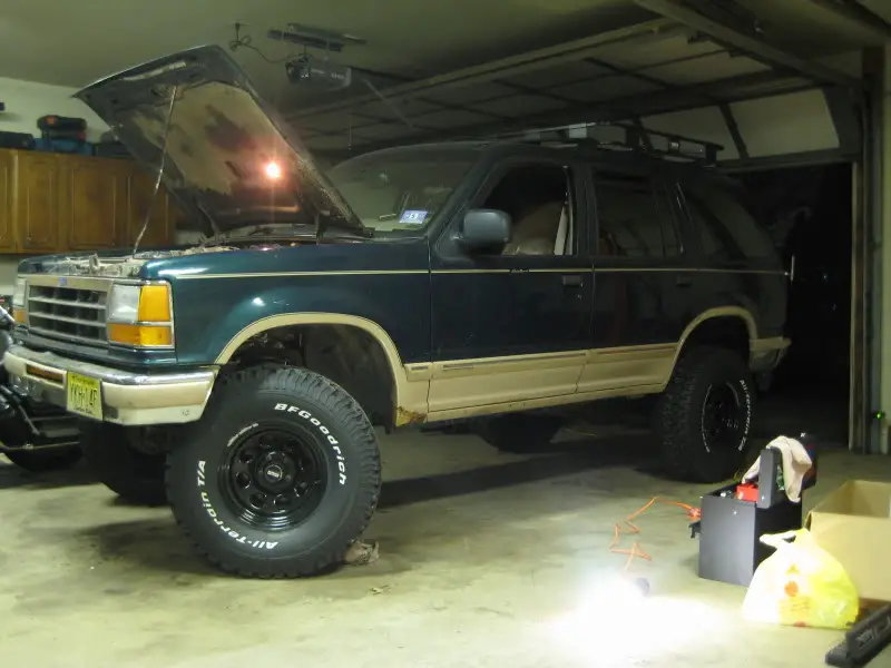

Great thread. This is just about the same thing I'm planning on doing to my 94. So looks like you did a 4 inch lift kit in the front and SOA in the back? Did you use the stock springs or keep the AAL with that? Any problems with axle walk?

Bats - I actually bought a new leaf pack for the rear and kept it SUA. With the new pack I got 4.5'' of lift. I wanted to see how much I got out of them before I went over otherwise it would be too much of a rake. We'll see how it settles though. I'm sure itll be SOA in the future...
