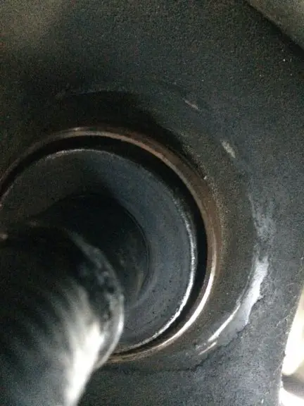

Been fighting a clunk and squeal from the drivers side for most of the last year until I realized there was no anti-rattle clip on the drivers side inner pad. Wonder whether it fell off or last mechanic just didn't install it. I got one from napa but the flat part or tongue was really short compared to the one on the other side. I got it on there and braking felt great and even for about the first 50 miles, now it's squirrely, feels like it grabs hard and lets go at speed pulling hard to the left fairly consistently. What's the wisdom with these, if I find a new clip that mirrors the other am I likely to be back in business or is all this indicating like a problem with the caliper? I'd have changed it by now instead of asking but I lost having a driveway so I've got to plan my maintenance out more. Thanks in advance!
