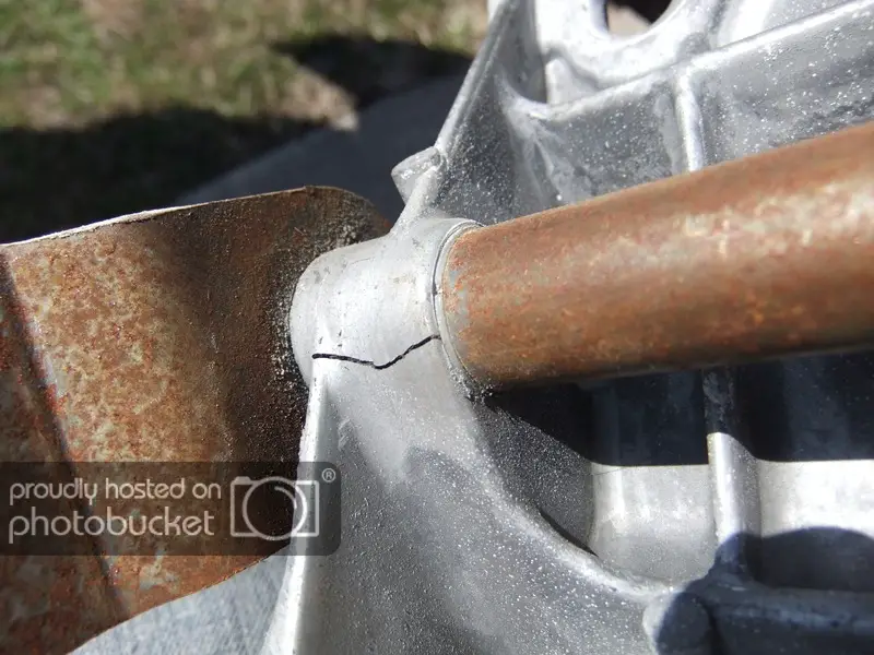

Just a thought:
Try looking under your dash at the clutch pedal assembly, it may have a crack in it.
Happened to me a few years back.
Here's a post on it.From (EvilTheCat).
How to: - Replacing clutch pedal assembly
