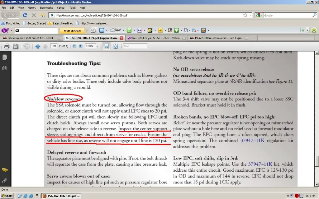

As I read through some of the documentation I came across some things to consider. Maybe there is a chance that the VB endcap bores are worn. See below:
Again this would aim at defective VB rebuild but can be verified by getting a line pressure reading.
Here is a location for testing the EPC and the line pressure.
When I tested the line pressure on mine it was a 7/16 socket - not sure about the EPC test port tho
-Mike
