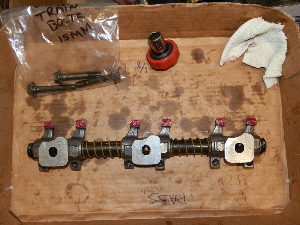

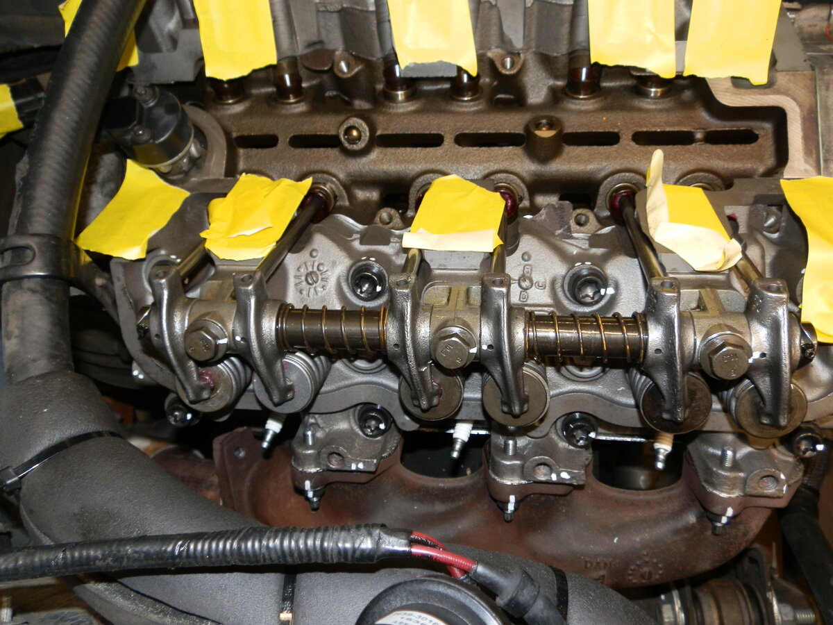

Also, there is a certain amount of L/R adjustment built within the rocker rail - and it isn't mentioned in any rebuild articles I've read.
I only found this out hands on - read on...
OK - so you can loosen the (3) hold down bolts and adjust the (3) "hold down pads" L/R to ensure that the rocker faces are hitting the valve stem tips dead on.
There is enough adjustment available that if the rocker arm rail is installed without any concern to this adjustment, the face of the rocker can be as much off as to cover only half of the valve stem tip. I saw something close to this on my engine - direct from the factory.
Centering up the rocker face/valve stem tip should help lower the valve train noise as well as the wear on the face of the rocker arm.
Regardless, the OHV/Rail design (based on the 1960's FE engine) on this engine is noisy straight from the factory, and
even after a complete rebuild that included new pushrods and rocker arms.
It's a truck engine...
Hope that helps -
