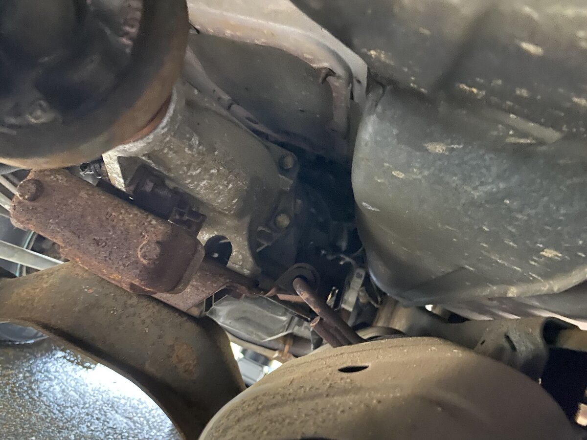

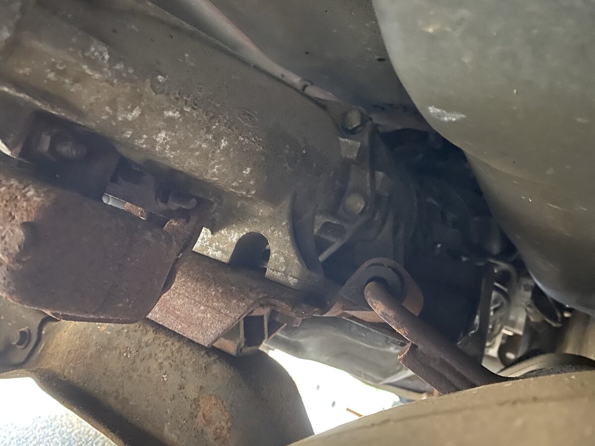

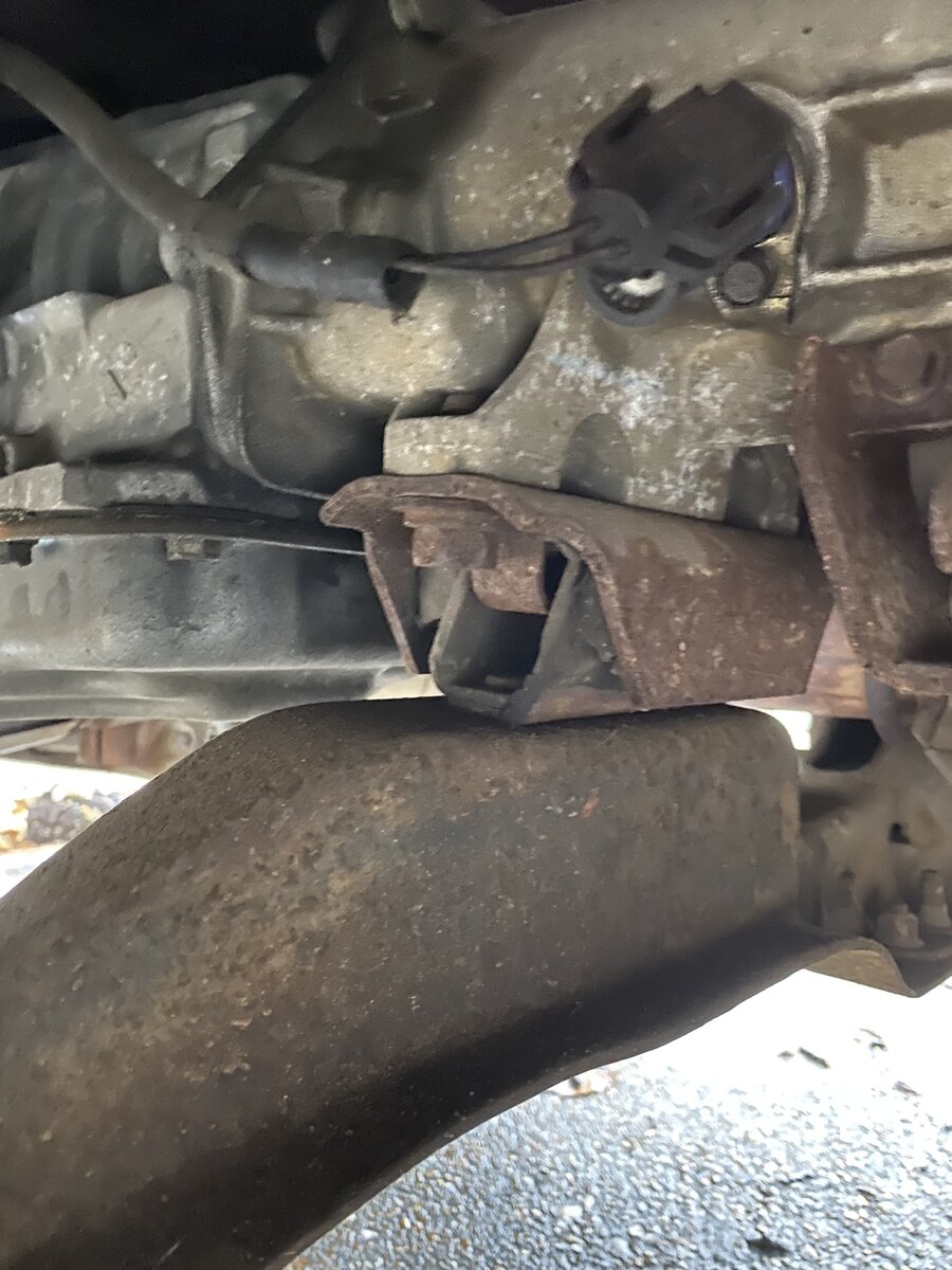

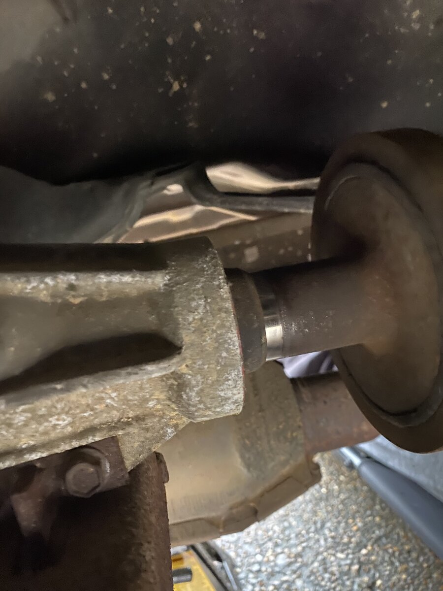

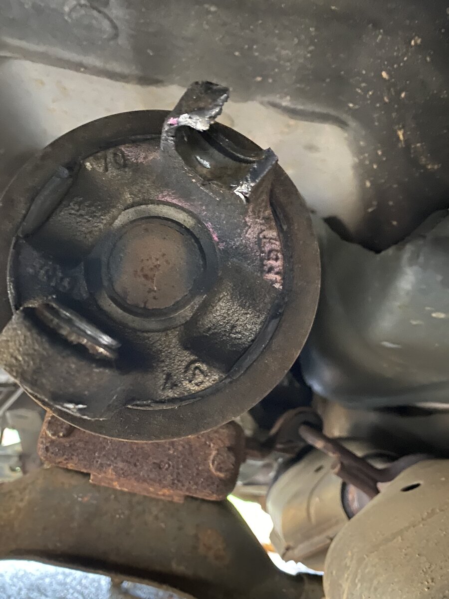

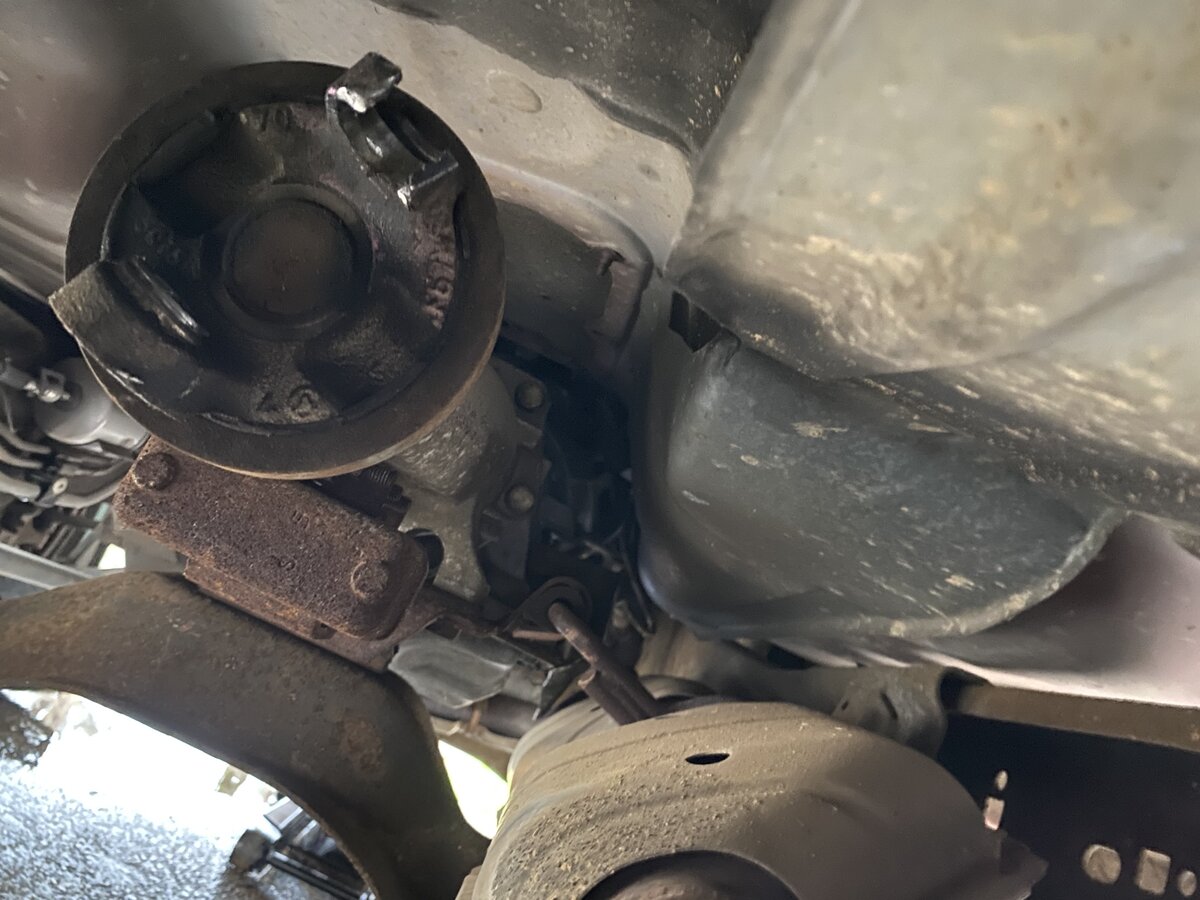

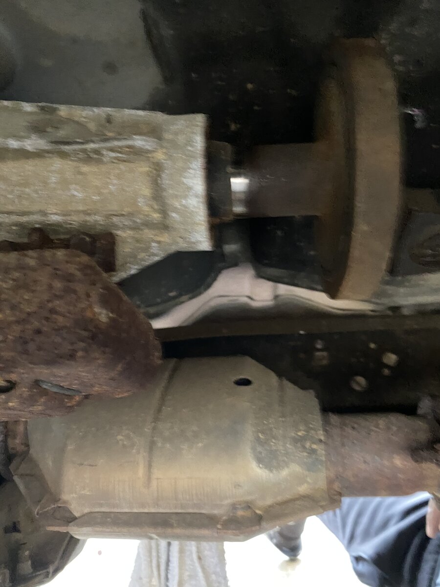

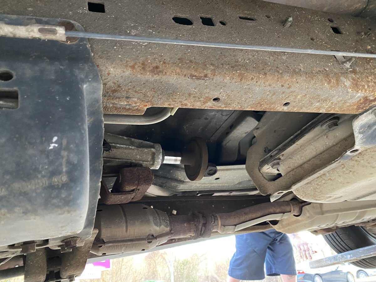

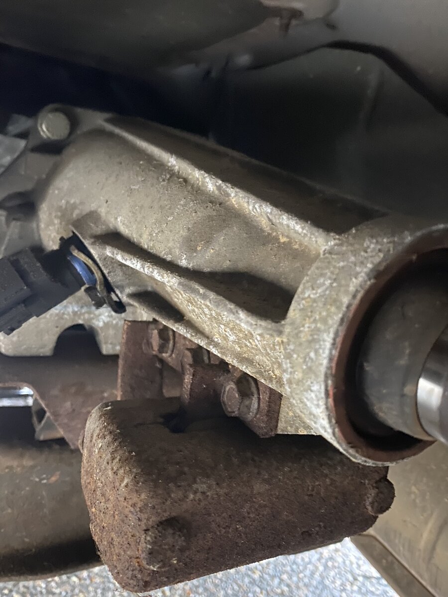

Can you post some pictures of the transmission and slip yoke?
That is what i had already taken. I will get some better pics either in a min or tomorrow.
you dont have a tcase, being a 2wd. unless they still did dummy cases like the bii which afaik is not int he x too
Pretty sure i do. That is what the slip yoke goes into i would assume. Might be called something other than a Transfer Case but think thats what it is and what the haynes calls it.

interesting its called a tcase. think its the tail shaft housing, if im seeing/thinking about the right part

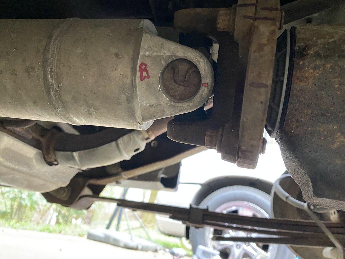

On a 2wd that is the tail housing or extension housing. Does the car roll with the driveshaft removed?
I will test that out this weekend and let you know. Trying to finish my mk4 GTi and that will be done tonight.
