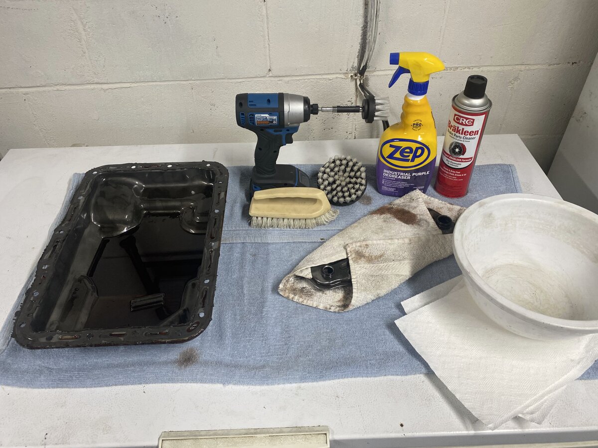

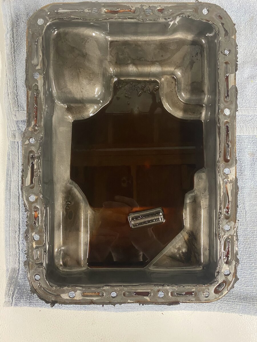

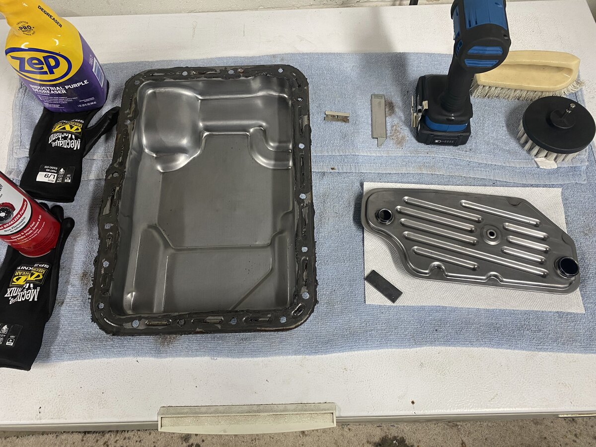

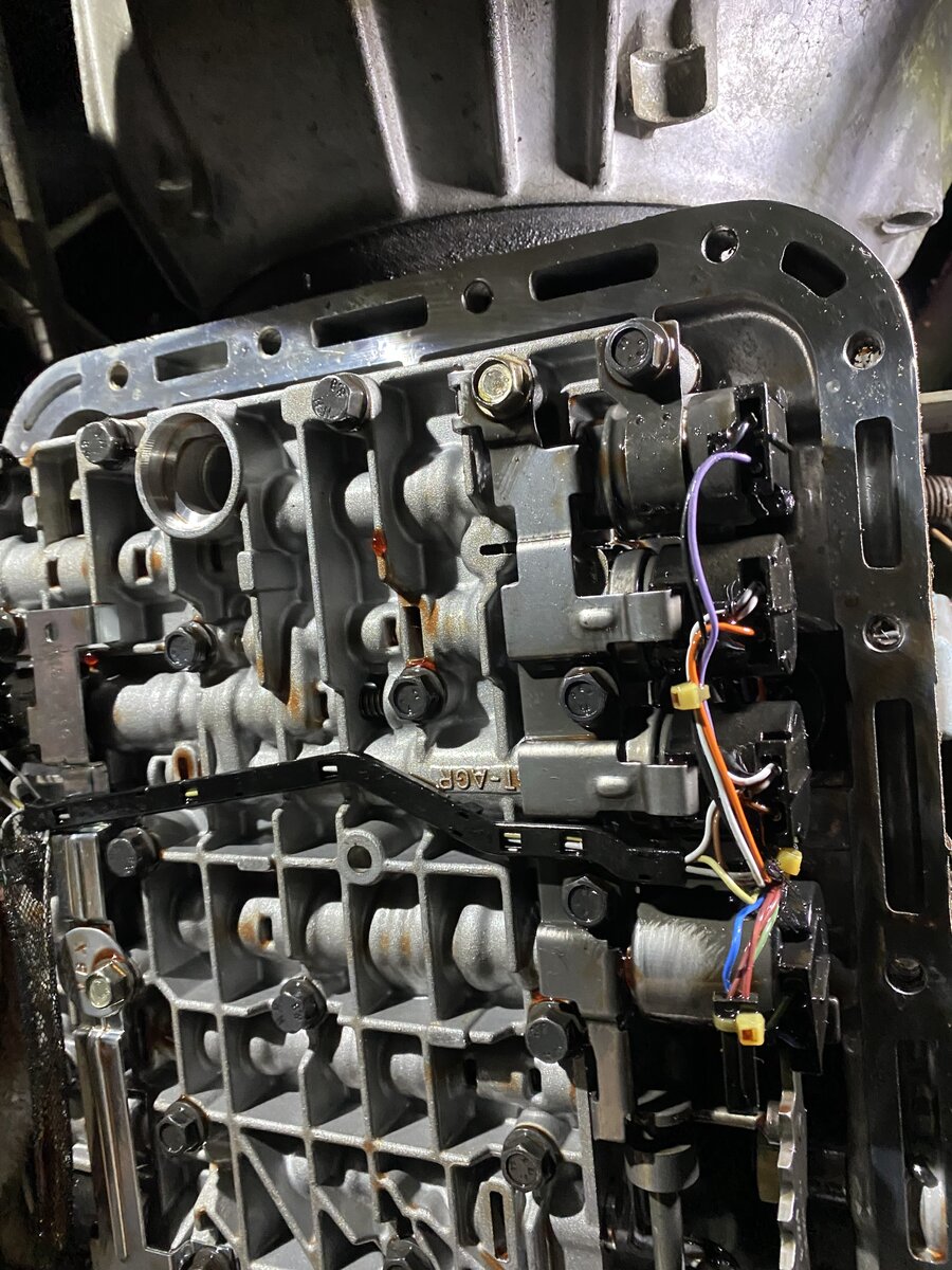

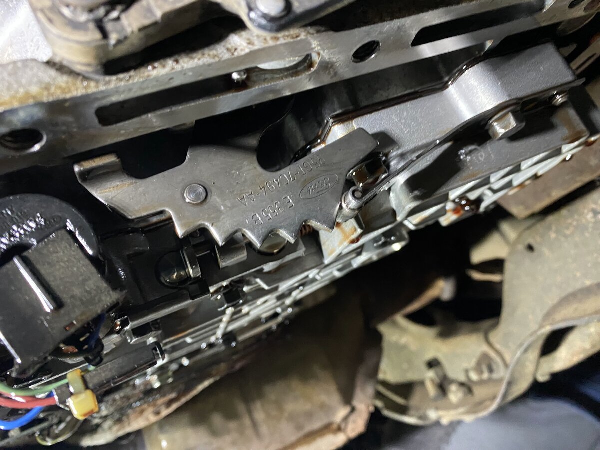

Pulled the pan of the tran, removed filter. Drained fluid obv, took pics of condition of trans w/o the filter on it. Still need to remove the old goop from the rim of the pan, and stopping to get new filter tomorrow and gasket. Double checked and have the 2WD filter and proper gasket in cart at AZ.
Plan is to test the solenoids and if those test just fine, install the new filter, gasket, fluid, then crank and let it idle for a bit, either still on the jacks or w the rear wheels off the ground at least and see if i get some wheels spinning without a load on the rear diff, and if so, put the rear down and see if the issue is 'fixed' or if i then need to look at the rear diff. Rebuild or grab a whole damn axle from the junkyard depending on prices.
Will ofc finish doing what the haynes book says to do before doing the plan listed above. hadnt looked at what those steps are if they are different from what is listed above.

cleaned.jpg dirty w tools.jpg finger swipe on magnet.jpg have to finish later fight me.jpg IMG_0242.jpg IMG_0243(1).jpg IMG_0244(2).jpg IMG_0245(2).jpg naked 2.jpg naked.jpg pan.jpg shifter close up.jpg shifter side cleaned no filter.jpg shifter side w filter on.jpg sNoid side no filter cleaned.jpg underside no filter cleaned.jpg
love the bungee cords and foil!
Looks like regular clutch material
No glitter or shiny bits in the fluid? No metal bits on magnet
Lol if it works it aint stupid right?!? No glitter or metal on the magnet. Fluid i have still but didnt take a pic of. Took a vid of it pouring out of the pan in like 10 diff little streams as i found it pretty lol. Fluid was red coming out of the pan in the streams and dark in the catch pan i had. No glitter or big chunks of any metal.
Have new filter and seal/O-rings getting picked up from AZ today so when i get home ill put them bad boys on, follow the steps in the book to button everything up and see if i got lucky and a new filter and fluid solves my issue or if i get to have some more fun troubleshooting after that.
These transmissions sometimes break a band and lose 2nd. There is a bracket end in the pan if that happens. Forscan also has good data on this trans, you can see a bunch of parameters when you start it up. A lot of data for '96, probably almost as much as a new one!
