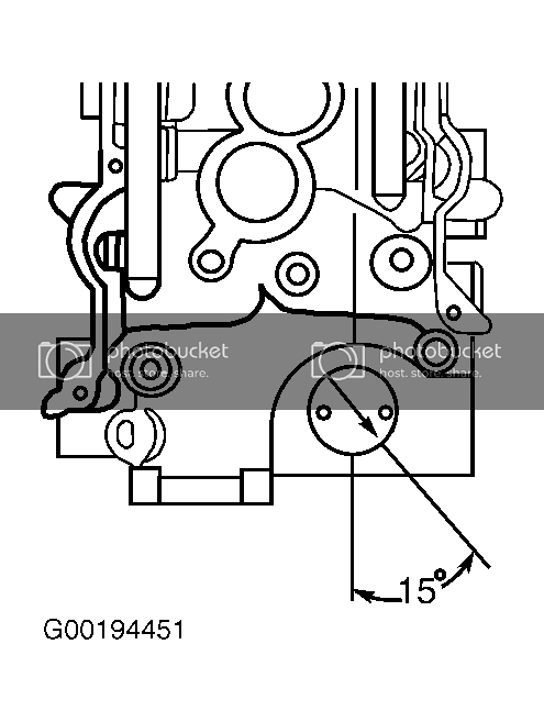

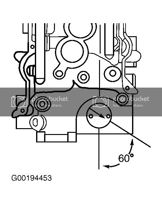

This is my first post on the forum, so forgive me if this is an issue that has already been identified or addressed. I have pulled and rebuilt the engine from my 96 explorer sport. I bought the special tool and went to reinstall the camshaft synchronizer. The issue is that I have photos of how the sensor was oriented before I removed it, which does not line up with what the Haynes manual says. Here's the Haynes diagram:
However, when I use the special tool, the angle shown in the Haynes manual is more like 15 or 30 degrees if I match up the sensor to the photo I took before removal:

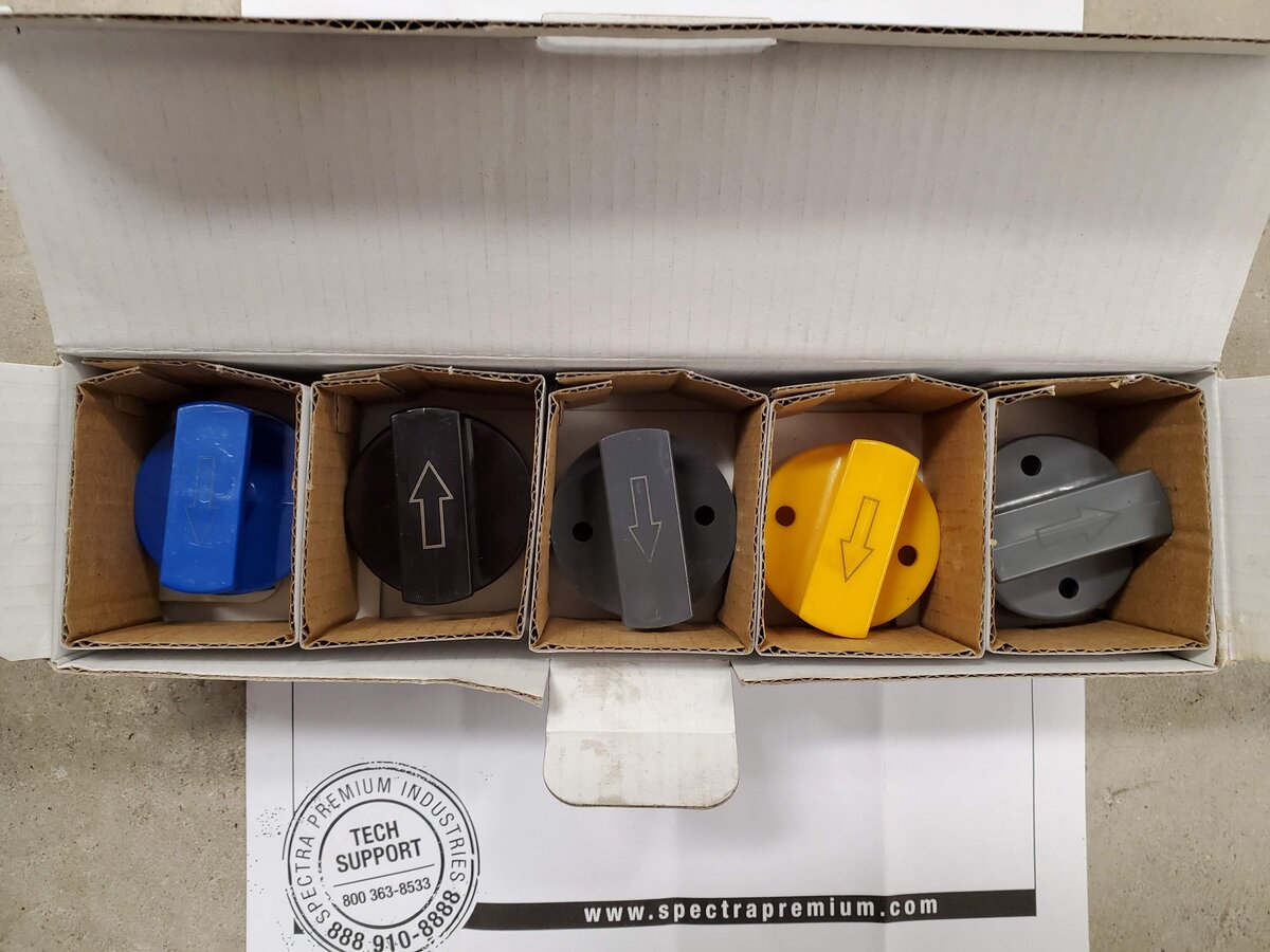

Has anyone run into this? Here's the tool I bought and used (yellow):
