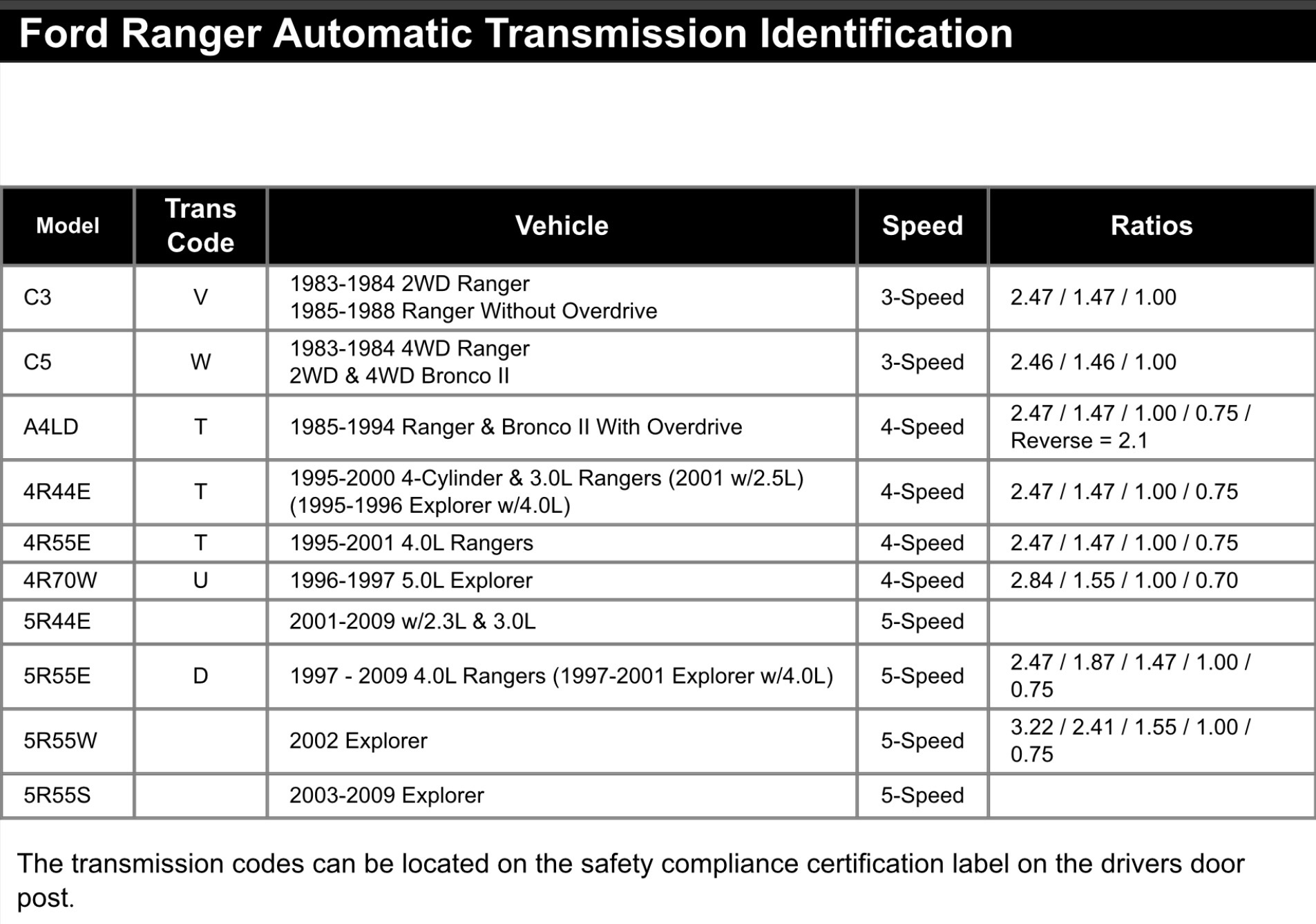

Also, which automatic is in this truck?? rockauto says 4r44e, I've had 5r44e come up when searching for new ones.
