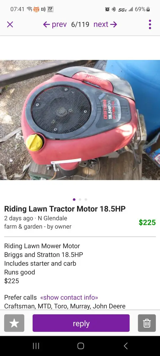

Now my wife is saying that the power steering didn't give her any problem Friday. I'm going out to Wal-mart shortly and get some power steering conditioner to add to the system. I think there is enough room in the reservoir for a bottle full or almost. I assume that one would use a whole bottle. I need to put off the pump and use my time swapping engines on my Murray rider 17 hp B&G OHV that last weekend I forgot to top off the oil then ended up throwing a rod. Anyone have a wore out 17hp B&G OHV that needs rebuilt. I have several spare parts. I'm serious and not kidding. An engine could probably be shipped FedEx for reasonable. Or if @Josh P sees one around his area, he could bring one with him on his next trip to north Alabama. But he probably doesn't see to many around his area seeing that they don't have hardly any grass out his way.

They exist here in Phoenix
