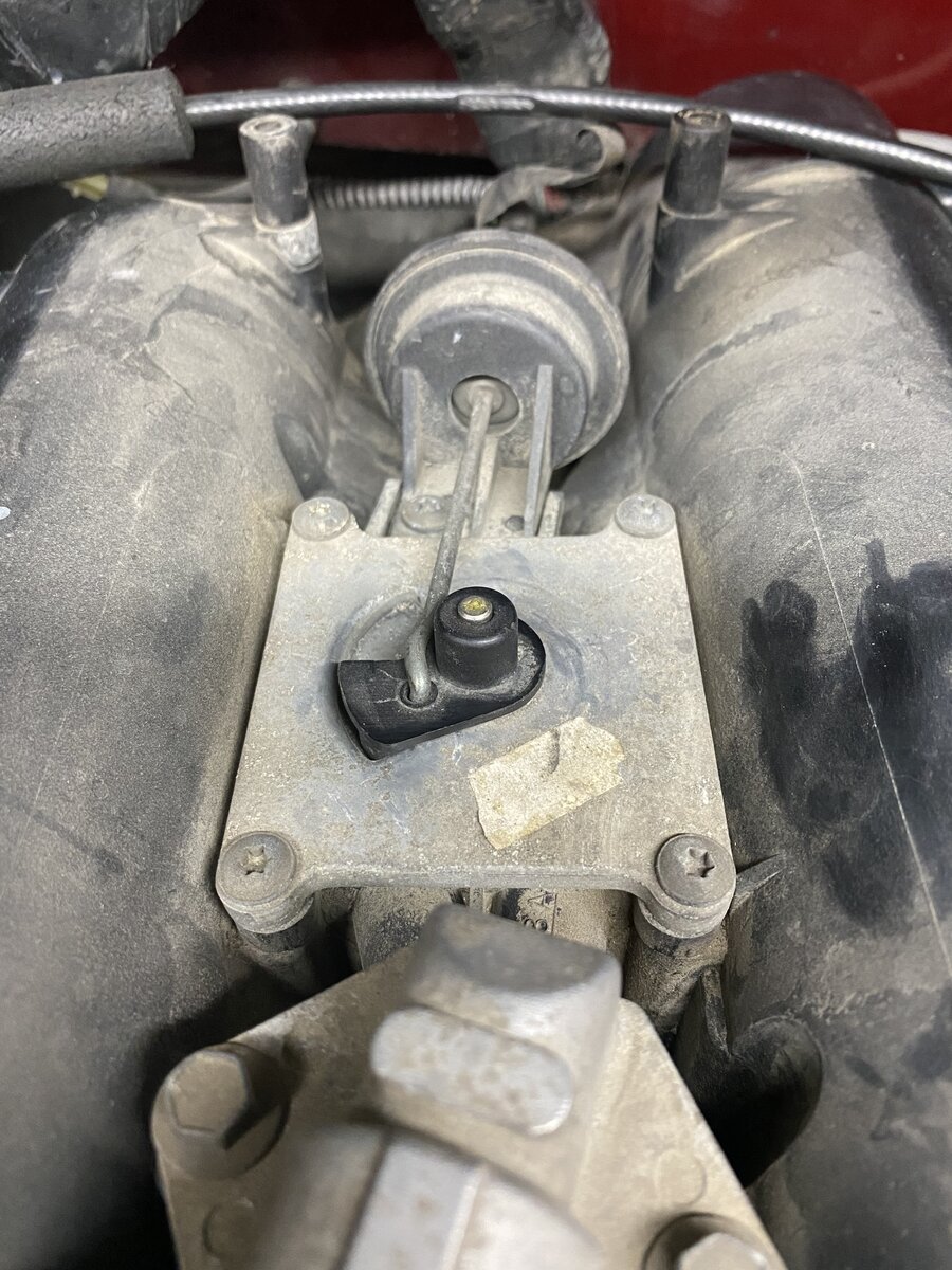

I have a 1997 explorer 4.0 sohc that has no heat . I’ve done the bleed procedure to no effect as the heater hoses have not heated up . I’ve replaced the blend door and actuator previously so I know it’s not that and also sent the automatic climate control has been rebuilt . Does anyone know how to test the heater control valve or to bypass it . I’m ok if the heat and AC only works if full on . Also wHat does the device in the attached picture does . It’s righ behind the iac valveon the intake manifold

That's the VIS Variable Intake System. Changes the runner length of the plenum.

I knew there was a butterfly valve on the underside to redirect air...but, have never heard exactly what the purpose was. Anybody with a detailed explanation?
Just changes the torque curve a wee bit, or so they claim.
