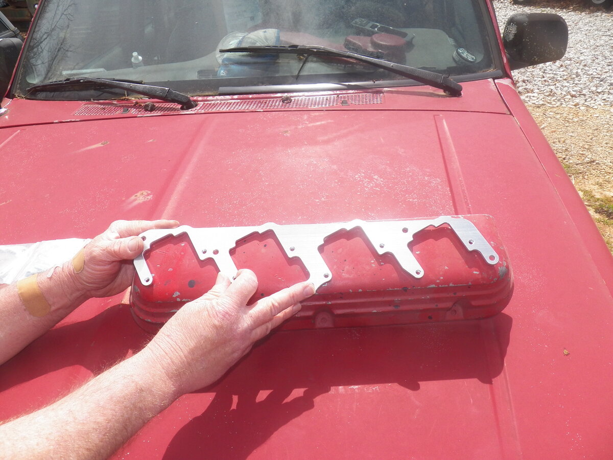

A 98 5.0 lower intake should not have an egr hole only the 96-97.5 trucks had the center hole for the egr gasses to pass into the upper intake. There were like 3 different lower intakes on these things. When you get the upper off we will know more. Many of the intake spacers I have run over the years were cut from phenolic a hard type of plastic. Nowadays I see them in phenolic, plastic and even aluminum!!
