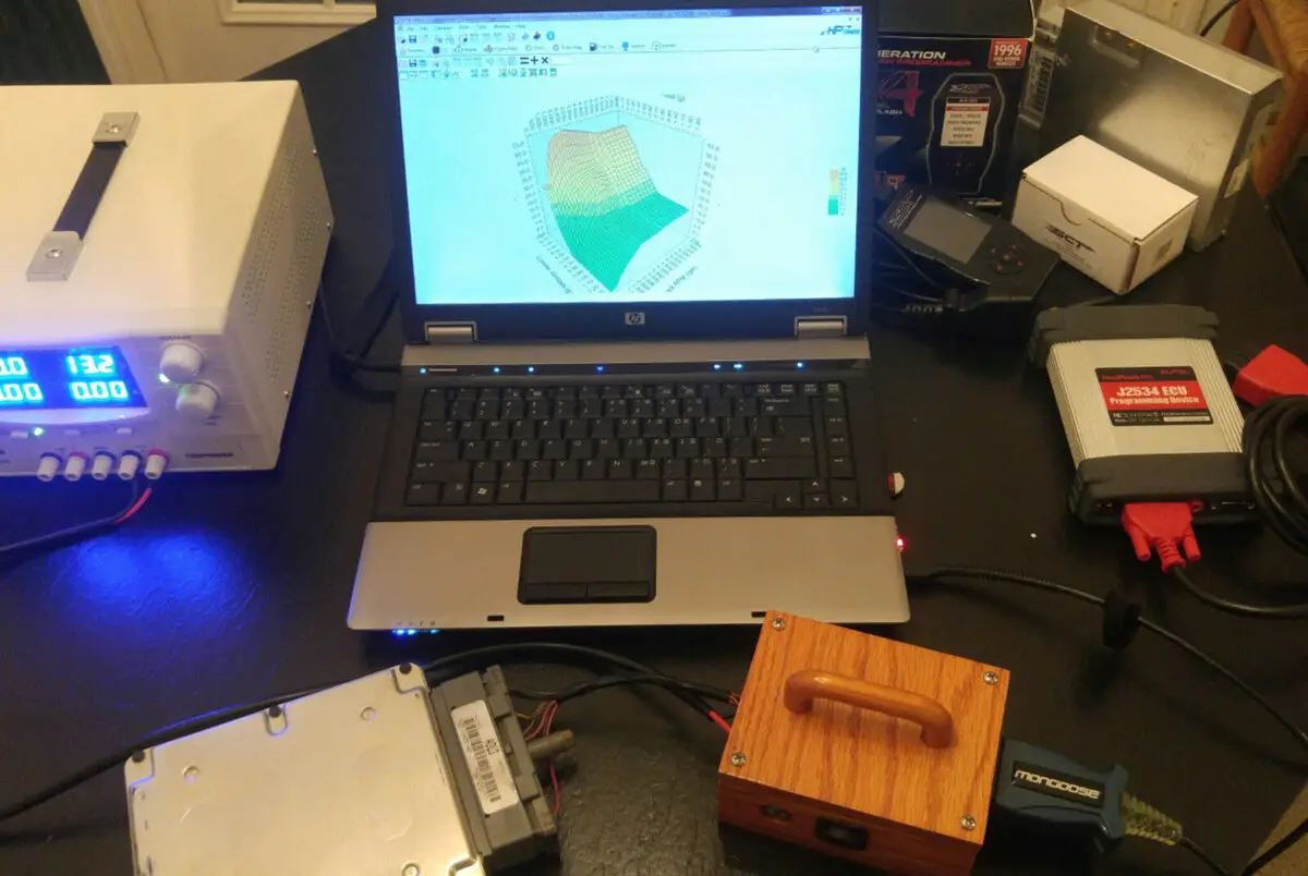

Below, picture of PontiSteve's programming set-up
Thanks, Jamie for the info!

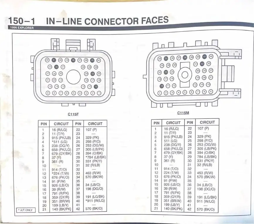

ADDED 6-15-23 ADDED 6-19-23 Not entirely correct compared to '98 and '99 Explorer C115 connector chart
97 Explorer connector c115F
Pin # Circuit-----Color-----function-----104 pin PCM #(99CV)------ Circuit number
1-----16 (R/LG)?----Ignition coils +12 Volt power ?
2-----11 (T/Y0)-----Tach ?
3-----915 (PK/LB)--DLC SCP data bus - CV C103 pin 3 pin 15 (915)
4-----511 (LG)------Brake On/Off (BPP) switch input CV C206 pin 8 pin92 (511)
5-----238 (DG/Y)--Fuel pump monitor (input?) CV c102 pin 5 pin 40 (238)
6-----658 (Pk/LG)--MIL 99CV C102 pin2 pin 2 (658)
7-----679 (GY/BK)--VSS input ?+ or -? 99CV C173 pin7 pin 58 (679)
?8-----37 (Y)-------KAP +12 volt C107 pin3 pin5 pin55 (554)
9-----361 (R)------Power hot in start or run KOP pin71 (361)
10----29 (Y/W)---Fuel gauge to fuel sender pin 9 (29)
11----914 (TN/OG)-DLC SCP data bus + pin 16 (914)
12----224 (TN/WH) Transmission control switch (TCS) pin29 (224)
13----676 (PK/OG) Case ground? CV VSS (-) pin 33 (676)
14----91 (PK/WH) (CV VT/WH) Canister vent solenoid pin 67 (91)
15----926 (LB/OG) Fuel pump control pin 80 (926)
16----39 (RD/WH) Engine coolant temperature indicator pin 42 (39)
17----791 (RD/PV) Fuel tank pressure sensor 99CV(RD/VT) pin 62 (791)
18----351 (BN/WH) Reference voltage (VREF) pin 90 (351)
20----199 (LB/YE)Digital Transmission Range(DTR)sensor pin 64 (199)
21----140 (BK/PK) ?back up lamps? C105 pin8
22----107 (P) DLC 99CV (VT) Flash EPROM power supply pin13 (107)
23----BLANK BLANK
*24----329 PK starter circuit
25----298 (PK/OG) ?back up lamps? 99CV (VT/OG) C102 pin 1 no pin in 104
26----253 (DG/WH) Oil pressure switch *not sure of route, instrument cluster?
27----305 (LB/PK) Not used, will double check
28----394 (OR/BK) air suspension NOT USED
29----BLANK
30----331 (PK/YO) WOT AC cut off, NOT USED
31----32 (RD/LB) stater circuit ?NOT USED ?
32----BLANK
33----463 RD/WH ????
34----570 BK/WH ground
35----BLANK
36----34 (LB/OR) +12 volt for O2 and EGR sensors
37----198 (DG/OR) AC high pressure cut out NOT USED
38----BLANK
39----191 (LG/BK) Vapor management valve
40----911 (WH/LG) Overdrive indicator lamp
41----BLANK
42----570 (BK/WH) Ground

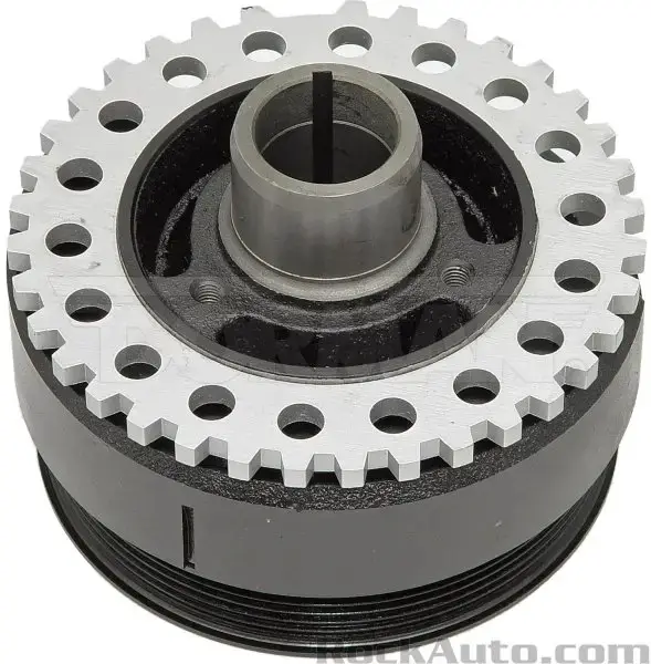

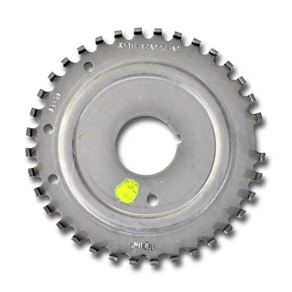

Explorer 5.0 crank pulley/harmonic balancer/36-1 tone ring.
1999 Crown Vic 4.6 tone ring (36-1=35)

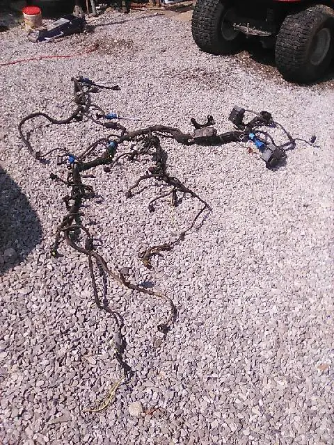

4.6 power-train control harness from a 1999 Crown Victoria

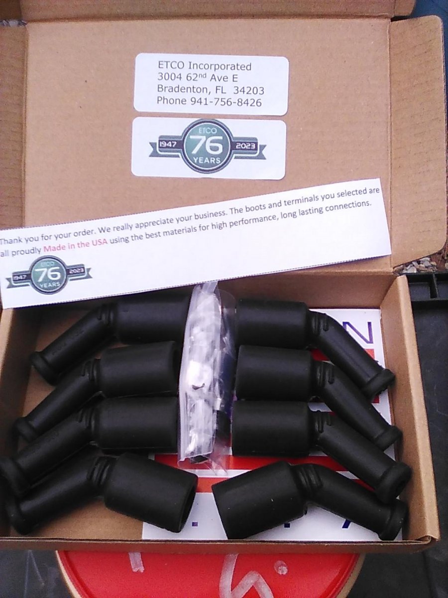

An LS boot set for the coil end of the spark plug wires

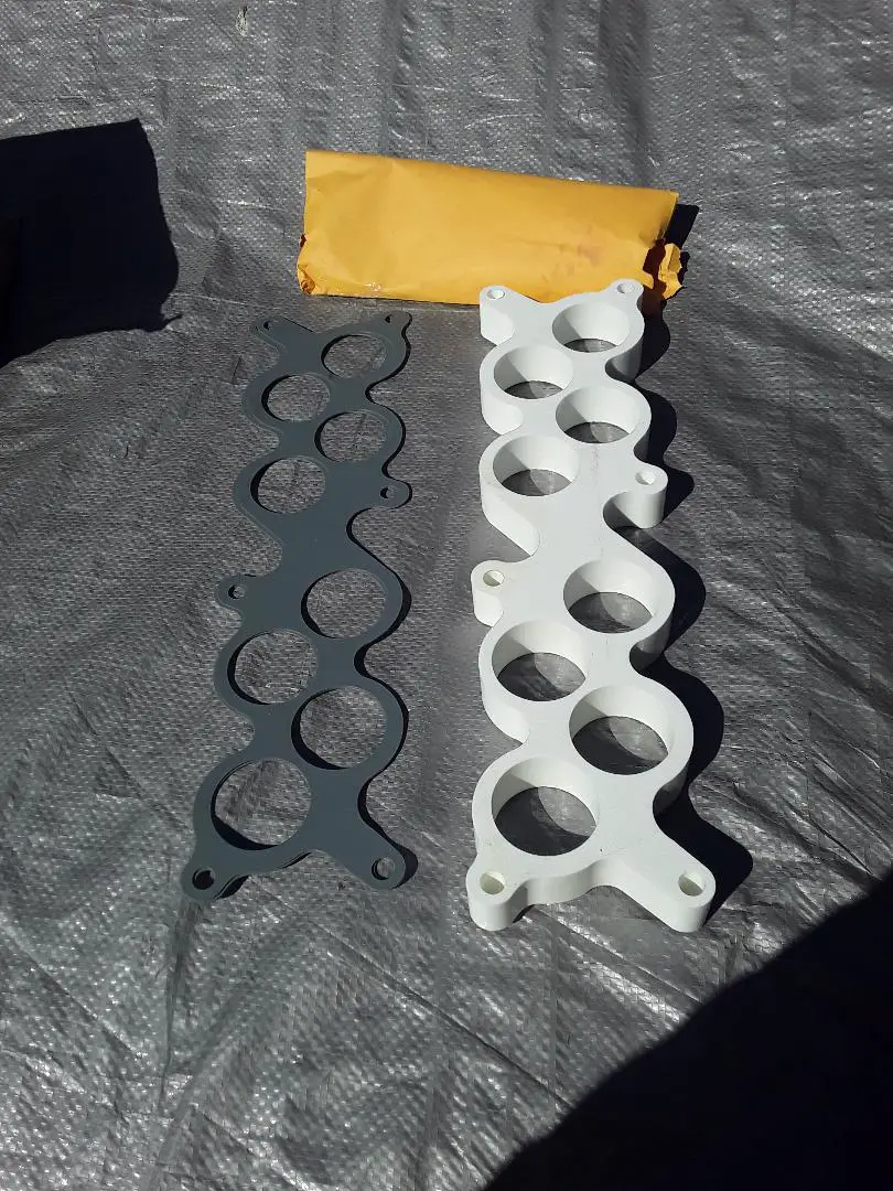

A 1" inch intake spacer to make room for the coils under the upper plenum.
I have one made of Delron but I might have to have an aluminum 2" CNC'd

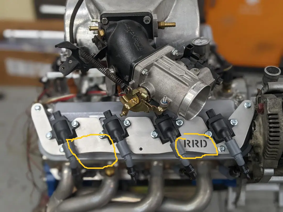

Aluminum to make coil brackets
Thursday 6-22-23 I took a piece of 5054 aluminum 12x24x3/16", a 5.0 valve cover and a 7.3 coil to the local CNC fabricator. Last spring I checked out his work over a 3 month period. I had him do various small jobs for me. It as a variety of little jobs including finishing up one for me in an emergency the day my old Argon regulator blew up on me. During the different visits, I was able to check out turbo's that they are CNCing from scratch, some steel projects, a large work table that they fabricated to fabricate a very cool totally hand-made chassis for the owner's 55 Chevy truck. I trust them with my parts and to do good work. I showed him 2 pictures of theses 5.0 coil brackets and he is going to make me something similar.
I'm going to have 5.0 inscribed into the brackets. Left circled area for the drivers side right for the passenger side.

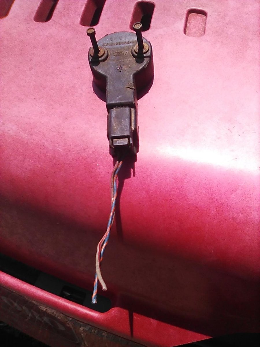

You will need the 1999-2001 Explorer 5.0 cam synchronizer, the main unit and the top sensor. The shape of the "flag" for the sensor is different from the 96-98 model.
I hope that goes well, the COP bracket etc. Let me know how much that group weighs when it's done. I'd like to mount mine onto the VC bolts along the bottom side. My FMS VC's have two upper surfaces, and I don't want to cover the top which is flat. So I'd like the coils on the side surface, which is near vertical.
@CDW6212R I need to see the inside of a 1999 to 2001 5.0 cam sync to see what the flag looks like. I must have one if I have a sensor off of one. I bought a few used ones back in August 2018.
That's good, the stock Ford part should be good for 150k miles. The three I have had to deal with were all over 175k, one I just lubricated with oil and it's been okay for about 30k(my Mercury). I still don't think there is a reliable aftermarket version, so if you have to pay $250 on eBay for example, that's better than $400+ for a Holley or other top EFI system brands(plus those would all have a unique sensor and its connector).
@410Fortune @CDW6212R After Jamie or Don or anyone else, show me the insides of a 1999 to 2001 5.0 Cam sensor assembly, I will go out to the "scrapyard" 15 miles from here and see if I can locate one and I can pop the top on one and verify that it is in fact correct for that year. I looked inside my '97 ones just yesterday and saw the flag was a half circle? I should have took a pic, I was going to offer 2 '97s for trade for one 1999 to 2001. Monday I'll edit this post and add a picture of them.
96-97 has 3 wire and half moon flag
99-01 has 2 wire and a tiny flag
Thanks, Jamie. Did you just take that pic or have a file photo? Thank all of you that help, for helping me. It's too bad that the wide "flag" couldn't accurately be cut down to the skinny flag.
i found that pic here on EF when I googled 2000 5.0 camshaft synchronizer :)
Never a problem We enjoy watching you!

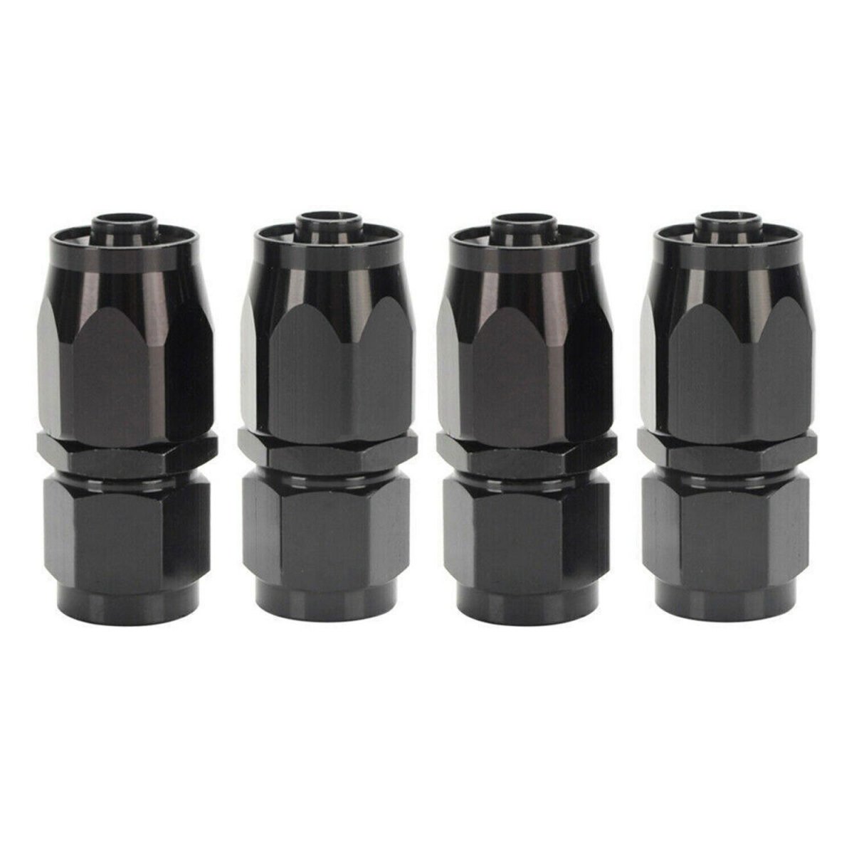

Below is the picture with the AN to Ford quick disconnect fittings. I'm having to reroute the fuel lines away from the top of the valve covers. Also the O2 bung for the AFR gauge and two Timken bearings for my Toro LX420 that I need to finish repairing this afternoon before I can replace the timing chain on the 5.0. It figures that some assembly will be required as it has to do with the AN fittings. Link below is about AN fittings.
AN fittings explained

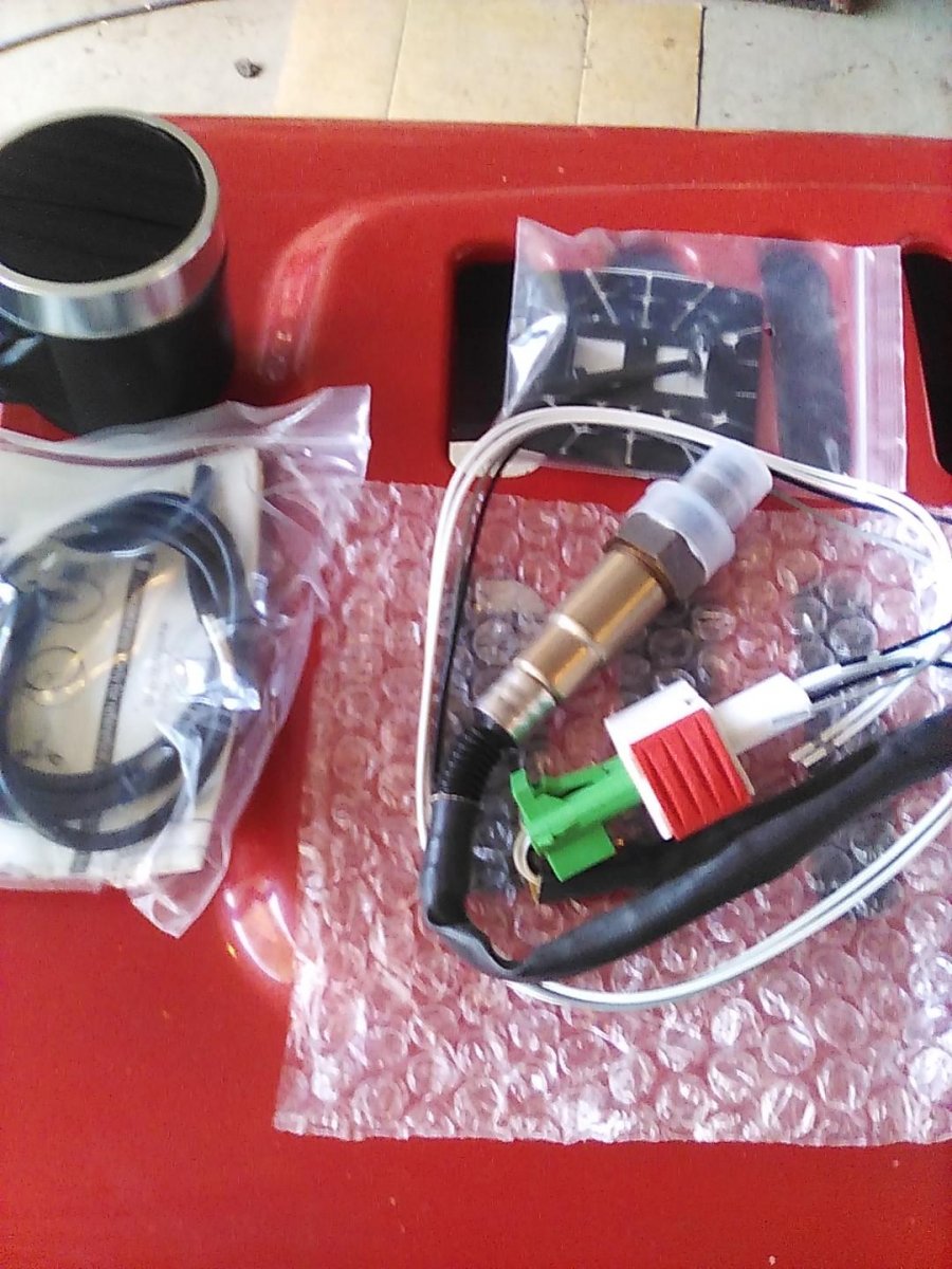

Also the AFR gauge kit showed up today...
It's cheap but I'll see how it will do.
EDITED: New picture and added text...
AN/Ford spring/lock fuel line fittings assembled. I'll need 2 different size pieces of braided fuel line and 2-6 and 2-8AN female line fittings.
I have some AN straight swivel fittings on the way for the adaptor ANs. Locally I can purchase some braided fuel line for fuel injection/pressure.
AN straight swivels pictured below

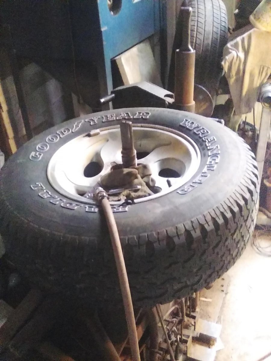

I'm only able to work a few minutes at a time at work on the MM. Today I mounted up the 3rd Wrangler that was born 3417. Ironically, these tires started out on the Mountaineer then ended up on the blue '97 V-6, then when the wife started driving the white truck, they were put on there. 20 months go, she wanted new tires. I kept these in dry storage off the wheels. They are in great shape. Now they are back on the Mountaineer.
These have gone full circle.
ADDED 4 hours later:
My wife had been complaining about the tire noise from the Wranglers. She purchased some Dexteros. She had a recurring noise that she described as a limb dragging. Everytime I drove the white '97, it wouldn't make the noise for me. The next Monday morning, she called 8 miles from work and said the right front wheel felt like it was locking up, and the vehicle was pulling hard to the right. I suggested that she not stop and do her best to get the Explorer to the parking lot where she worked. I knew then what the noise was. A locked up right front wheel bearing. A Chinese piece of crap that came with the new front rotors that the PO installed. Don't use import bearings. I stripped the good spindle off of the MM that had been sitting in the penalty box. I took the part and all the tools that I used to remove it and put them in a box. I got to where she works right when she finished for the day. I R&R d the spindle assembly in the parking lot. I mis-diagnosed that one! Now her Dexteros are noisy and I did a front/rear swap and the noise went away. The front end needs aligned but I don't trust the Import front wheel drive alignment guys to do it. I'll just have to do the alignment myself. The camber is off on both sides. I hope it is not time for ball joints yet. Waaay to much going on at the moment.
