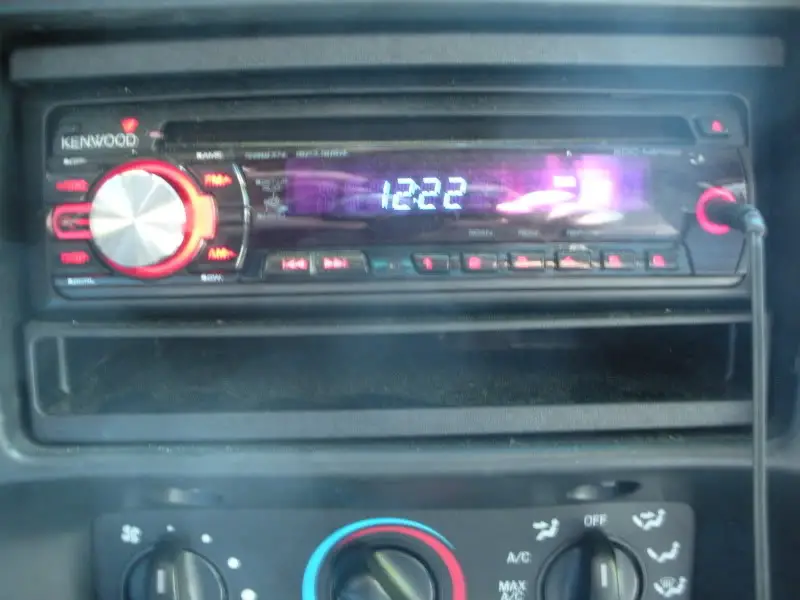

Accompanied by a new deck:

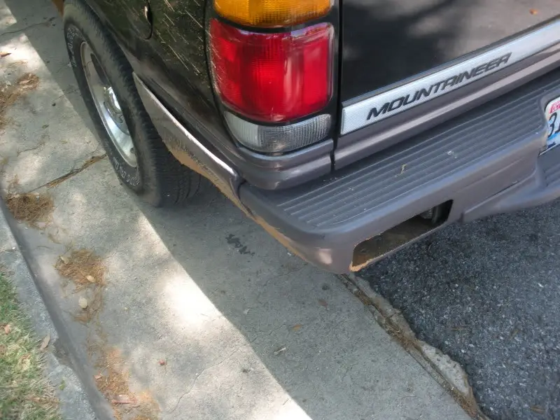

and somehow along that time period there was a little mishap with a tree and I lost the back reflector:
this took me a whole year to find a replacement!!!

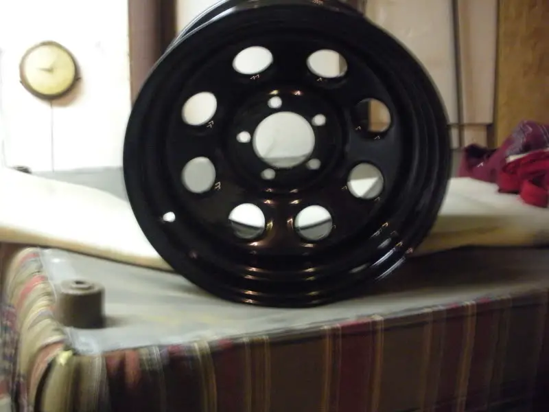

The rest of summer consisted of saving and research. I finally had the money to order my parts, but not quite enough for the tires so I head over to Summit and ordered my new wheels (I HATE THE TEARDROPS!!), Add-A-Leaf kit, and Warrior Shackles (from Tellico4x4):

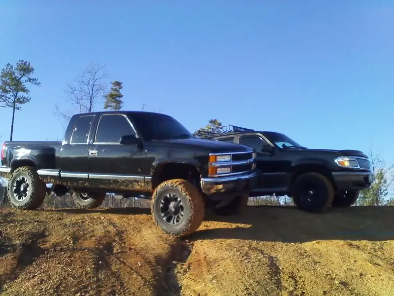

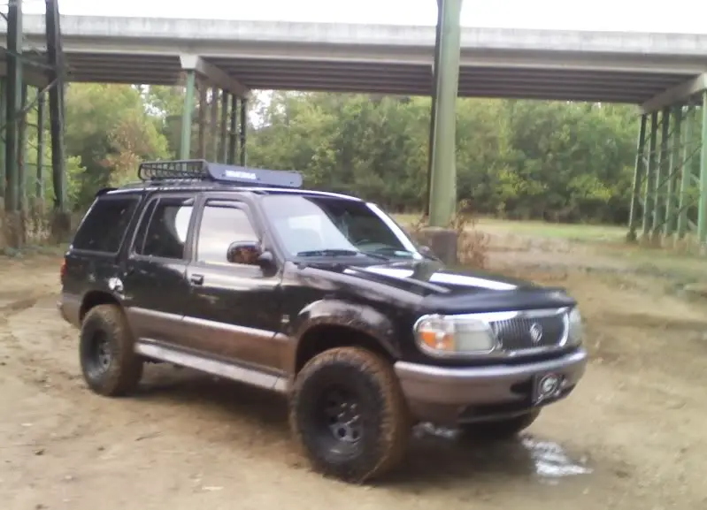

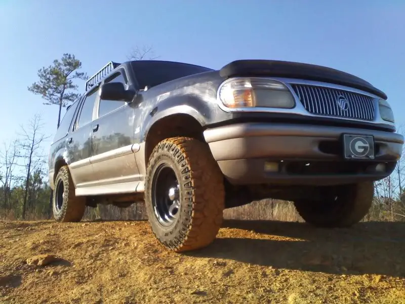

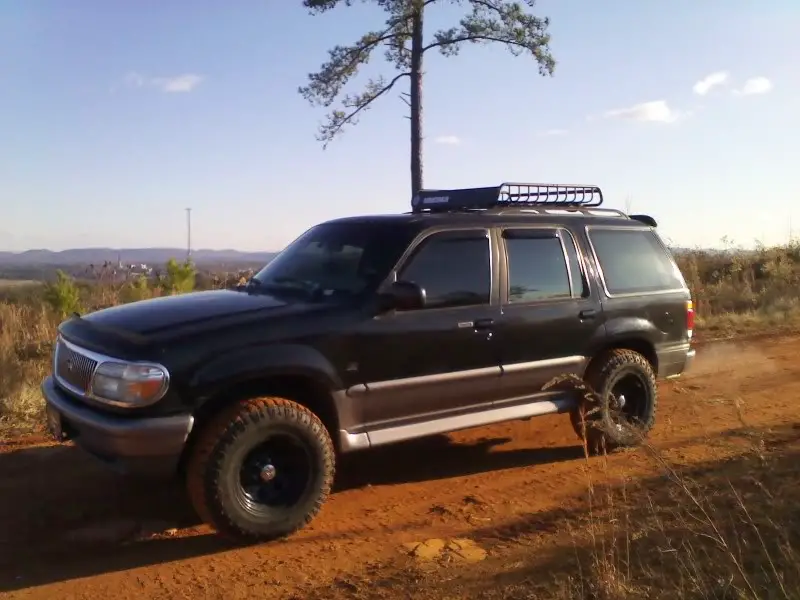

The wheels were put in the garage until I could get the new tires but I was ready to do something dammit!! I had waited all summer for this! Sooo I went over to a friends house and we cranked on the Torsion Bars a little bit and got 2" out of them, I made sure no more than that!! And then we added the shackles and dropped the Mounty back down. The lift gained was equal at 2" for the front and back so i decided it pointless to put the AALs on so we shipped them back for a refund. This was the last month in summer and with school right around the corner I decided I was gonna have new tires before we went back! I rode around with 2" of lift for a couple days and picked up as many shifts as possible and when I got the next paycheck I went the next day and got the new tires. GoodYear was my choice seeing as how one of the GoodYear rubber plants is right down the road from me here in Alabama and I got a good discount on them seeing as how I have a family member working in said rubber plant. I already knew what size I was going with, 31x10.50x15, and I decided to go with DuraTracs. So I gave the Mountaineer over to GoodYear service center for a good 2 hours and when it was ready I forked over my 800-ish dollars and went and got an alignment. She now sat with 2" TT/Shackles, Tint, and a pretty good sound system, and a used Yakima roof basket I acquired from a friend. I knew this wasn't it for me and the ideas came rolling again:

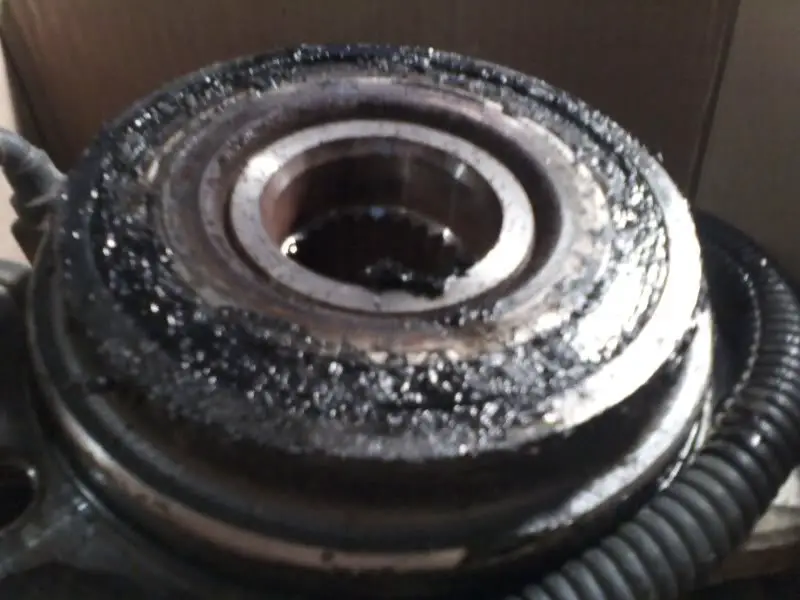

The mud in the above pictured wreaked some havoc on my front end. This led to a hub replacement and lower ball joint replacement and also a lessen, NO MORE MUD!! I still to this day have yet to replace the uppers which now need it because they are starting to squeak.

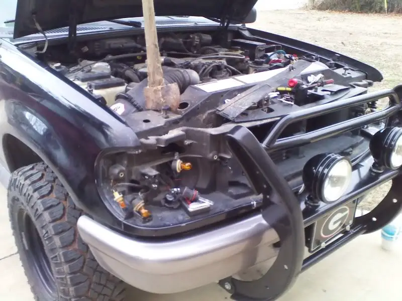

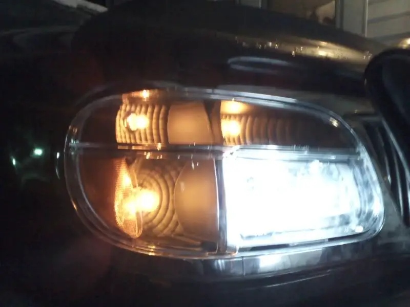

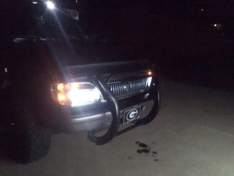

It was birthday and Christmas time again and by now all I had done to it was add a K&N drop in air filter. So I began formulating ideas and decided I wanted to do some more exterior work. I decided on: brush guard, KC Daylighters, and some new headlights. As soon as my goodies arrived I began installing. Brush Guard:
HIDS and clear cuts:
and here's a pic of the KCs on the brush guard during HID and clear cut installation but no night shots:
Since then I have removed the side guards on the brush guard and decided I did not like the Clear Cut Housings. SO with a lifted Mountaineer, squeaky upper ball joints, and a dream, I continue on in my never ending list of modifications.
