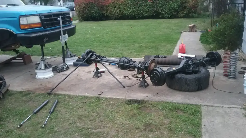

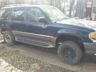

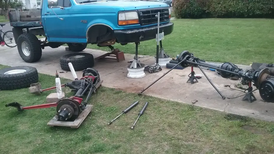

hears some pic i have on computer of the 97 merc with a 3'' keys twisted with 4'' shackles on rear with stock 235 75s and pictures of when i picked up axles and swaped them out for mi other axles on my f150, moor lift and better gearing with softer springs.old axles and red stiff springs will be going on the merc .
