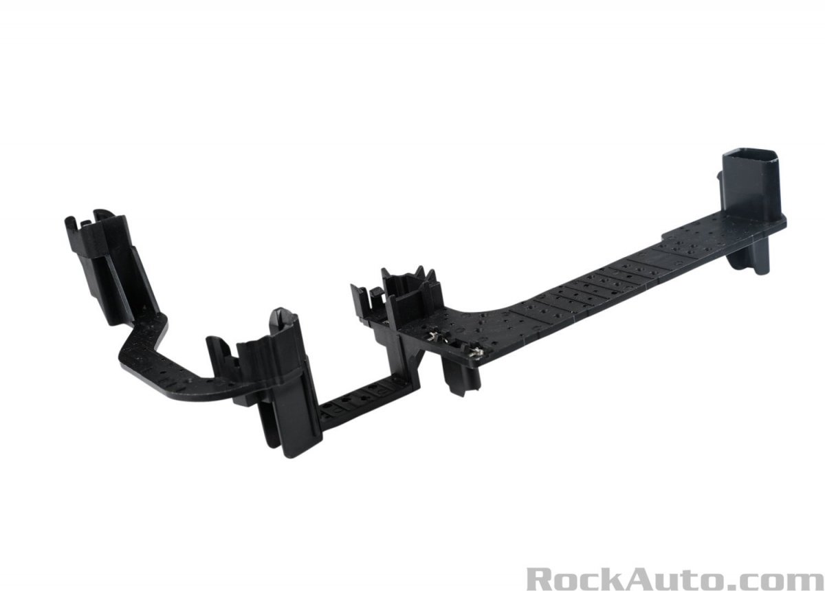

@410Fortune So Jamie, I take that c-111 connector on the powertrain harness, actually on the transmission pigtail part of it, that may be the white connector that quite a bit of transmission fluid dripped off of, and rearrange the pins to the later way of doing things and it will end up plugging back into the transmission after the big black plastic transmission connector is installed? The white C-111 plug would plug into the
far right end of this?
Yes
Basically the 94-97 version had three power wires going into the trans
The 98+ version they simply reduced it to one power wire going into the trans
And you move some pins around, plug it back in.
I can rearrange the wires for the trans connector here on the table. I'll deal with the solenoids when I get up in the air and can get the pan off of it.

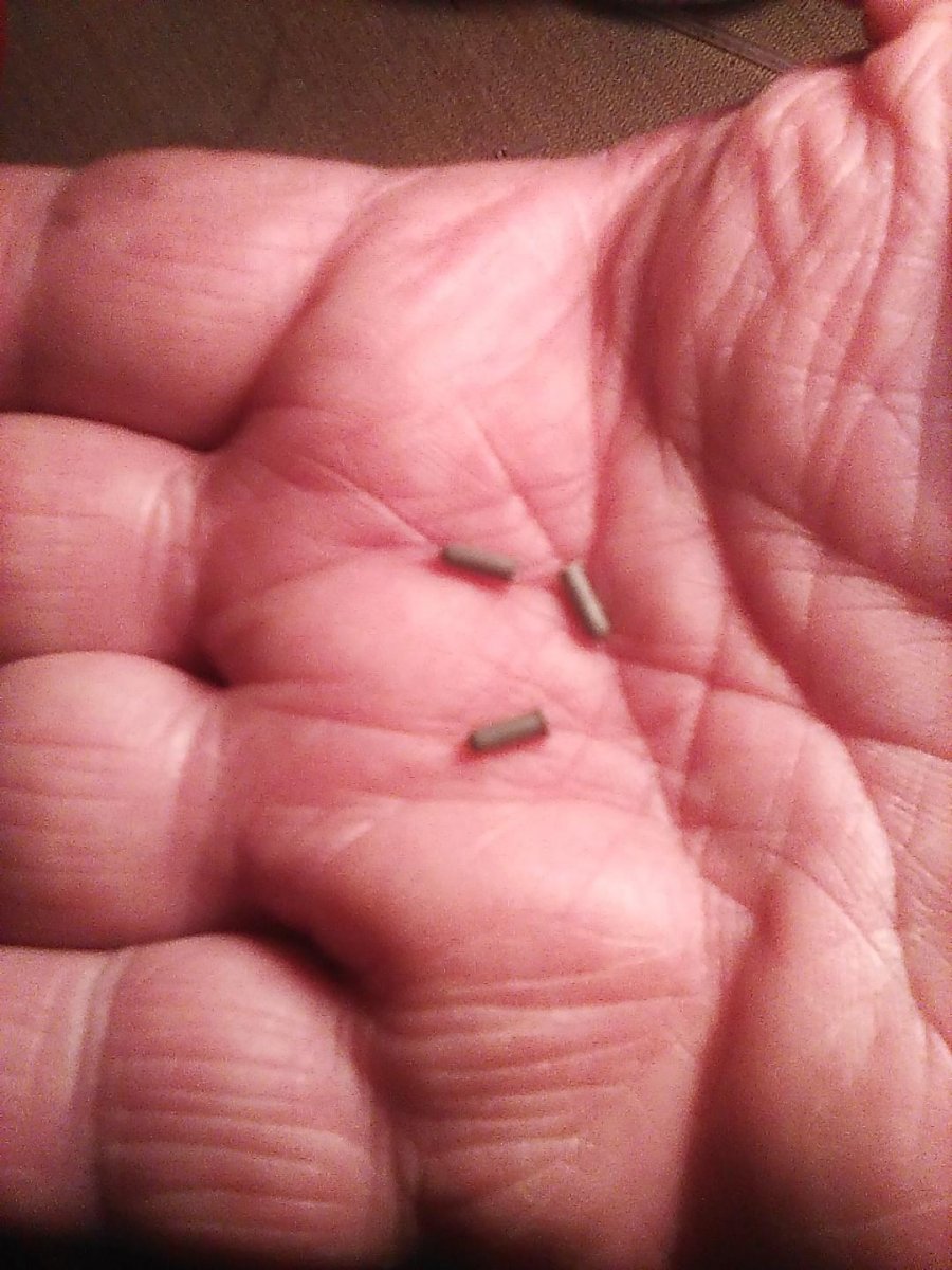

I have had to punch out 5 or 6 holes in the 104-pin connector so far and only fouled up one lock when I was pushing on #39 lock and pulling on wire #38. I hope it is not going to be a future problem. It is the IAT wire. maybe I can put a little super glue around the outside of the barrel and outside on the connector where the wire goes through. That is a critical wire, but they are all critical. I'm up to #49 and #50 and they are both going to need opened up. I've been using the drill bit by hand, and it doesn't take long to cut through. I have a smaller bit that goes in backwards to make sure that the hole is clear. I could have used an alligator clip a few times today. I could really use a label maker right now. The sample roll was only 4 meters. I found this out when I ordered two more rolls and they are 8 meters, 26.2 feet of label tape each. They won't arrive until Wednesday. So far 2 of the rearranged wires will need lengthened. The picture below is for Jamie. I know that he knows what the little gray sprinkles are. I know what they are.
Some of you may have figured out that I'm left-handed. That is why my right hand is always pictured.
The camera makes my hand look older.
I hate it when I break a lock pin on the pcm connector! Forever will wonder if that wire is pulling out

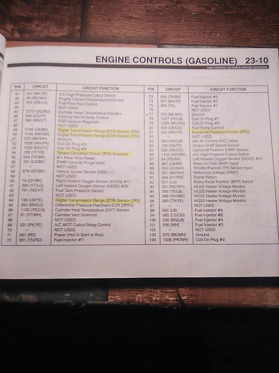

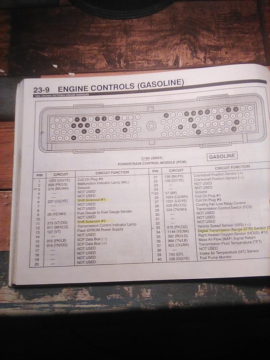

1997 Merc Mountaineer 5.0 pcm pin chart below. 3 images.
Pg 2
Pg 3
1999 Crown Vic V-8 coil-on-plug pin chart below.
Pg 2
Different guys/gals must have made up these charts. I've noticed on these two comparisons and other books too that what something
is called may called something different. I'm having to rely on wire numbers and colors in some instances.

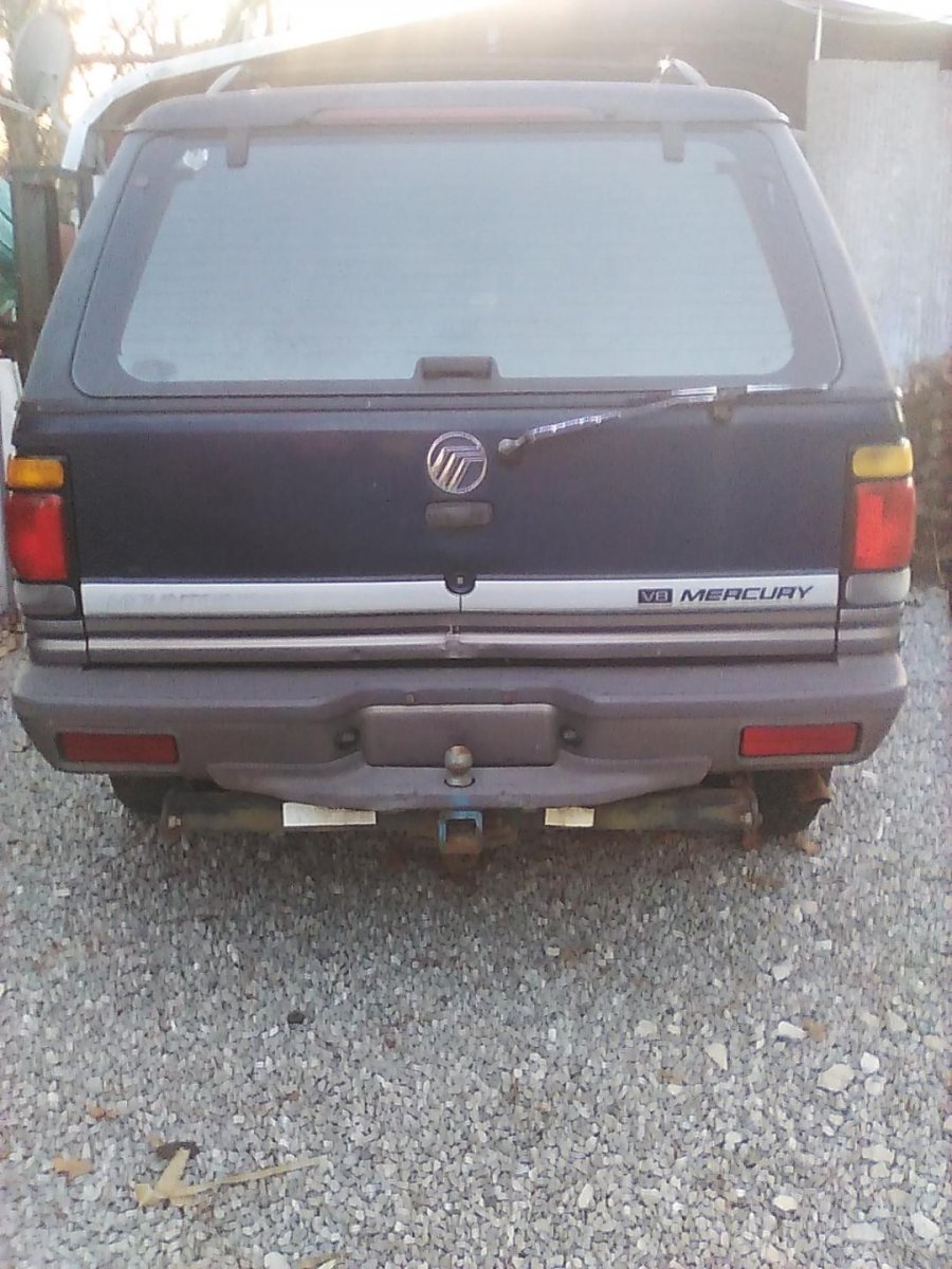

I've spent a lot of time around the MM this past few weeks and have been looking at what kind of bodywork it needs. The hatch on my current driver/beater is in pretty good shape and I'm considering swapping the '97 Explorer hatch with the '97 Montaineer hatch. PO backed in to his
utility trailer tongue and bent this one quite a bit. I assume that the lower mountaineer trim is held on with that super-duper factory
double sided tape. Then the wiring would have to be disconnected. Disconnect it from the truck or the hatch?
Close up of damage.

The Mountaineer rear hatch trim changed from the first 1997 model, to the 98 version, and then to the 99-01 trim. I know the 98 has holes in the hatch, many, for the trim, I don't think there is any adhesive material at all. I was going to swap my 98 hatch due to rust(from Milwaukee), but that's when I discovered the holes for the trim, also for the 2001-03 Sport hatch I was hunting for.
You don't want any holes in the hatch if possible, using double sided tape would be wise. I'm going to try that for my Explorer project, using the 98 trim style. I'm okay with some tape, and Ultra Black RTV, that will hold it for sure. Rust is a huge deal, kill it or avoid it always.

@CDW6212R At least my '97 Explorer donor hatch doesn't have any holes and the chrome circle Mercury emblem can be attached using double sided trim tape.

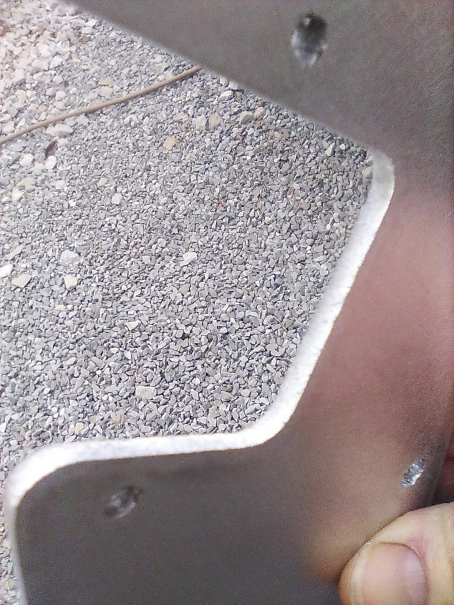

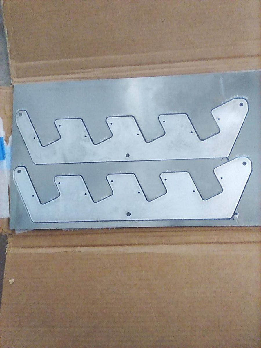

The c-n-p brackets got cut. It took so long for them to be cut, I could've cut them out with an electric jigsaw.
They still need the coil attaching holes drilled and tapped and the edges really need some cleanup work.
Actually, it would have been a lot of work cutting them with a jig saw.

Deep torch cuts from the plasma cutter. Hard to see edge but it show in the cut holes. Going around it with a fine file for now.
