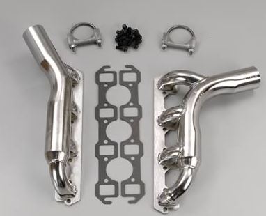

@CDW6212R Earlier I was looking down towards the lines and I saw a 2" wide heat shield. I found another option for Ranger swap headers however they are currently not available. IIRC they are for 82-97 Ranger 5.0 swaps. I would like to borrow some for about an hour to check the fit.
Advance Adapters 717044.
Someone with some skills and a tig could make some to fit a Gen II 5.0 Explorer.
Too bad these BBKs wont fit F150 BBK headers
Advance Adapters SlickFit Headers 717044​

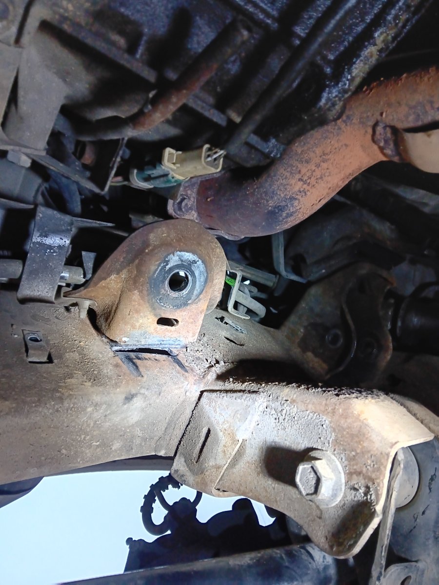

Here's a view of mine with the front diff out, note the hanger bracket is broken off in both pictures. The first one it's just hanging by the small bolt holding the line bracket to it. The swap headers with the collector going back farther than the stock one, it would be very close to that hanger bracket on the frame. The lines are away from the frame by a good 1.5" or more.
@CDW6212R I can tell that the 2nd pic is the driver's side. Is the first pic the driver's side too?
Wild! Failed factory welds you are hard on your truck lol
Yeah they are both the left side, see the same hole in the frame where the weld tore out there. I've been busy and haven't yet gotten to whittle that hanger bracket some to make it fit back in place, to weld yet. I just drove 350 miles today to pick up an open box 75" TV; I'm tired.

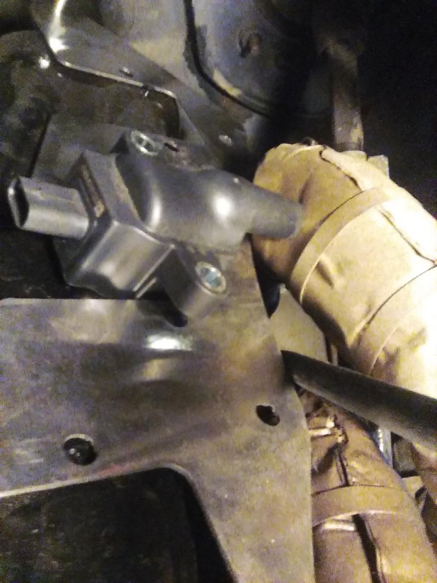

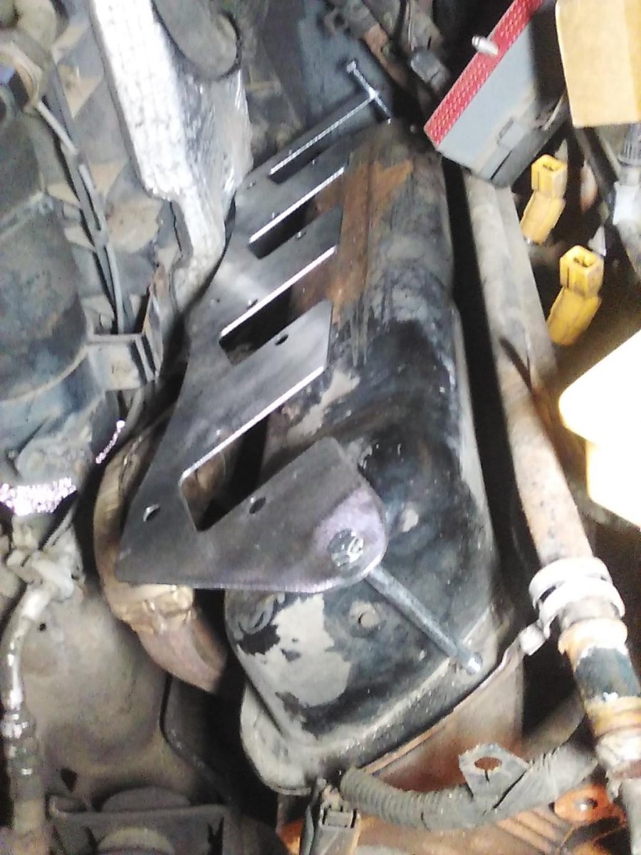

Here are a few pics from earlier in the week when I worked with the template for the first time.
Driver's side coil in position 3 blows in to the header.
Another pic.
Passenger side has issues too. It looks like the coils could move up an inch.
3rd on this side is touching the AC box.
I'm going to work with the bracket again with the ps pump and upper plenum in place. I haven't had any new ideas on the bracket.

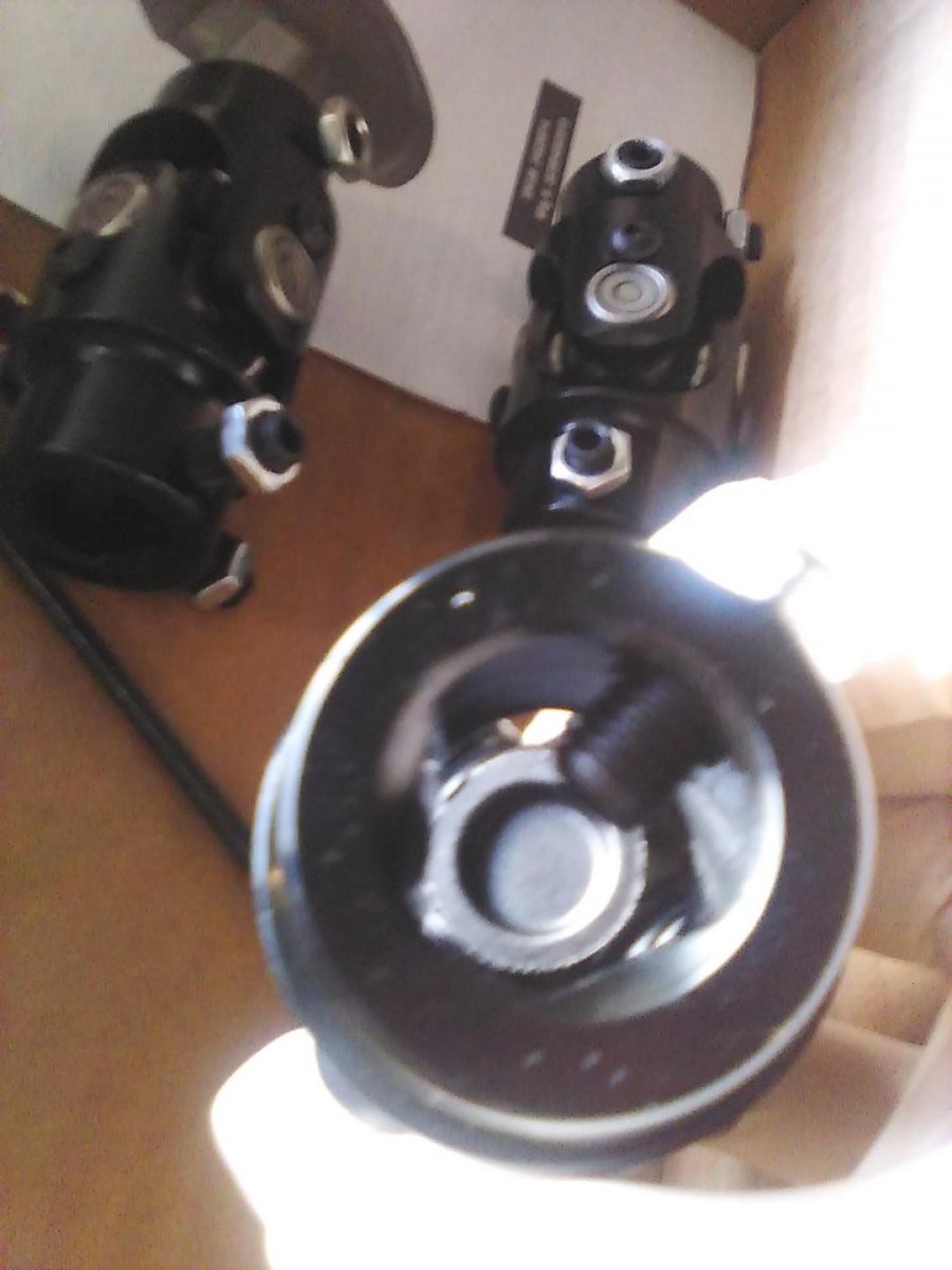

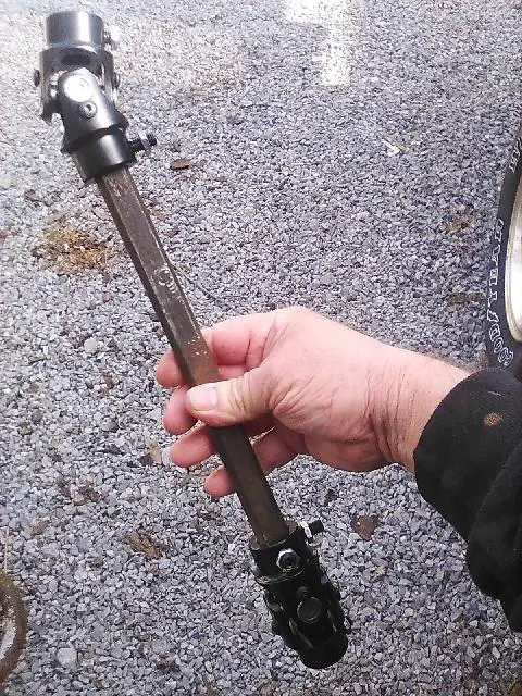

3 u-joints for the steering if necessary to make a new intermediate steering linkage. If I don't need them for this one, I do on the 54 F100.
2 double, double "D"s and one DD x Ford V. Waiting on the Heim joint.
U joints attached to piece of DD shaft.

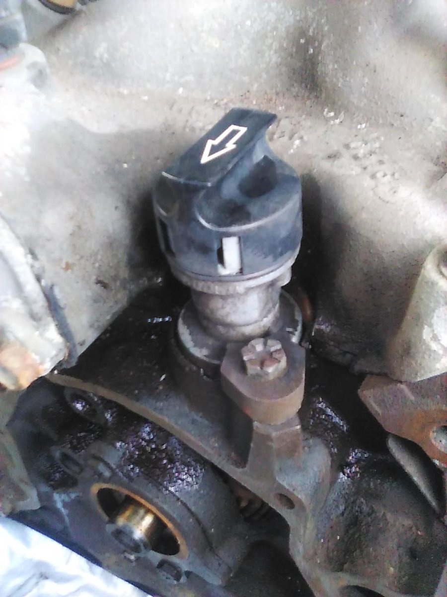

I've been prepping to install the new timing chain and gear set and while it is all this far apart, I installed the 2 wire, skinny flag type,
camshaft position sensor.
The '97 MM (early 1996.5) 5.0 had the half moon style flag. The 1999 Crown Vic has a 2-wire sensor as part of its coil-on-plug system.
So does the 1999 Explorer.
Tim from Canada fixed me up with a 2-wire camshaft pos sensor and an alignment tool. It can be installed without the tool. Just make sure that
it is indexed straight ahead when the engine is at top dead center. Fine tune, adjust the housing to center the flag in the opening. pic below.
