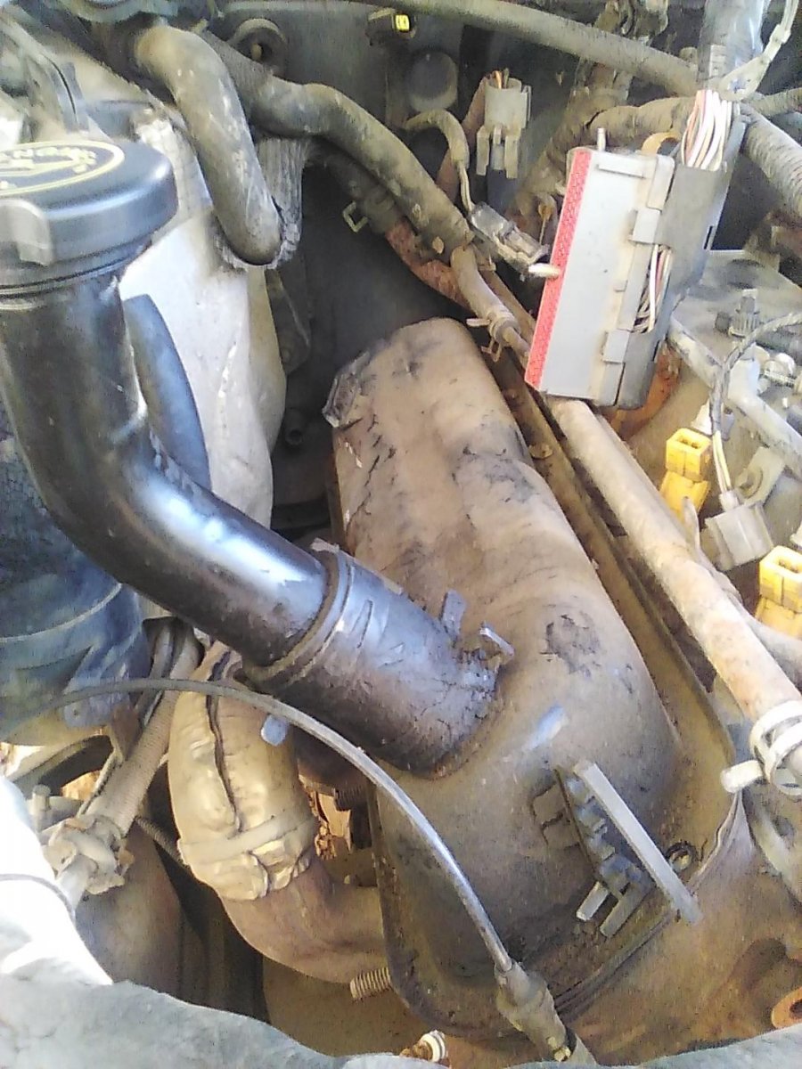

The fill tube is going to have to be deleted so that the bracket will fit. A 1/2" pipe thread "bung" will need to be welded somewhere to be able
to plug the long skinny transmission type funnel to get oil in this thing or the very worst-case scenario is pulling the camshaft position sensor out of the block just to add oil. Inconvenient!

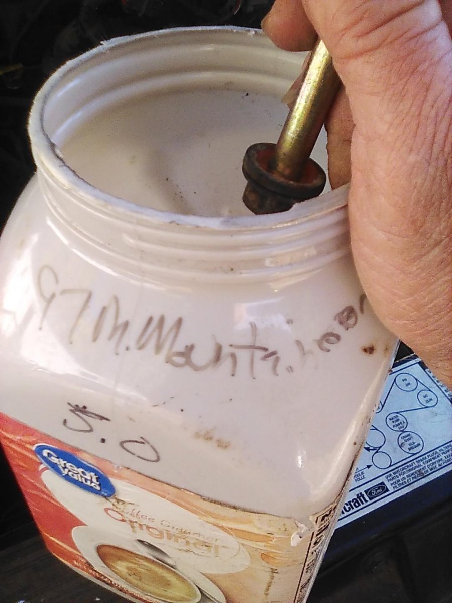

I must install my accessory brackets back on to the front of the engine to check the coil bracket fit. I knew that I kept somewhat organized. On the floorboard with the alternator was a container labeled 5.0 Mountaineer. It had all of the bracket bolts in it.

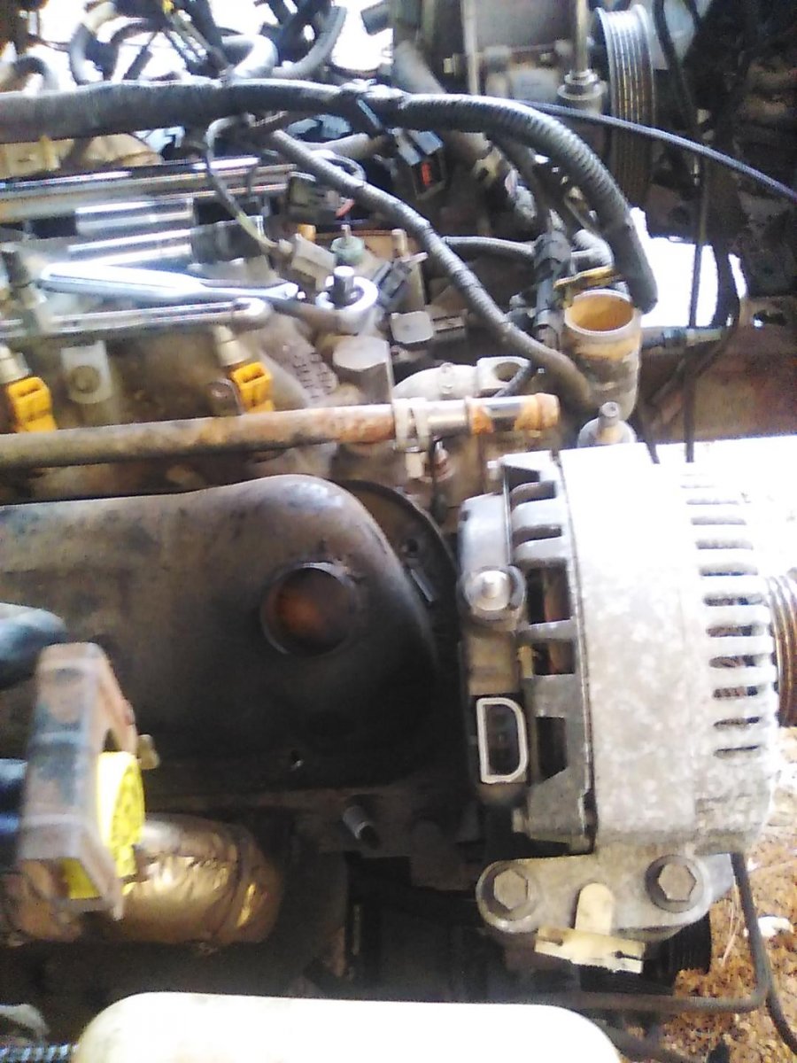

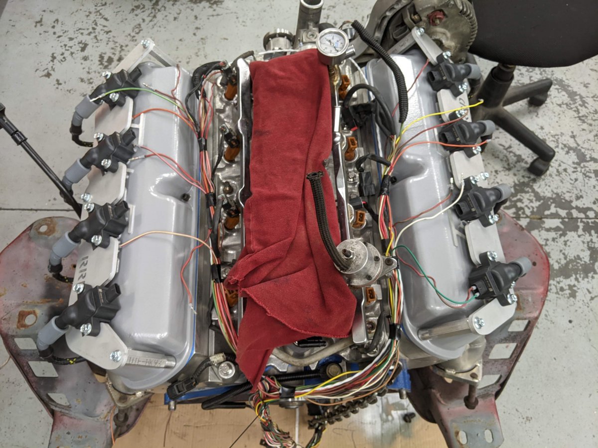

In this straight down view pic, I see where we may have a clearance issue. I found out that the guy who originally designed these, they fit great on the engine stand. In his 5.0 late model Mustang engine compartment, the rear of the left bracket interfered with the brake booster. On the right front it interfered with the alternator. I can see that in this picture and live in person. I also studied the driver's side and a worst-case situation is, if I can't slide the PS reservoir forward, I can mount the tank on the left inner fender well.

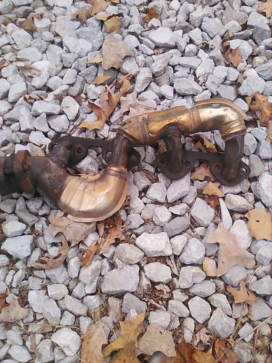

I've been looking for a spot to add 2 wideband O2 sensors to the headers. One for the stand alone AFR gauge and one for a sensor to go back to the PCM to send info to a Real Time tuning program. I you delete your EGR you can reassign the EGR wire, a 5 volt analog input to hook up to the separate O2 sensor.
The right-hand header may just have enough room to add 2 bungs side by side. Leave room for your socket & ratchet. I have my 2nd set of headers to "stand in" for pictures at the moment. I have yet to remove the one on the right hand side of the 5.0. I just don't see room on the left side header to install a bung. There is not any kind of collector at the flange. Right side pictured first.
At least I will only be removing one exhaust header. It is a pain on these trucks. The bung welds need to be really good with no leaks.
Good plan, locate them now and do it slowly, do the welding well. Also be sure to place the O2's on the upper half, always pointing down some, moisture can kill them.

Don, it does look like I can get the O2 sensors up on top or a bit sideways, maybe a 10 o'clock angle of the right-side header. I need to take a look up under the fender well again.

Picture below is borrowed from Grant. Friday with this bracket bolted to the head, I couldn't quite make out what was going on. I need to notch the bracket for the hose to sit forward to gain a small amount of clearance, so it won't be in the way of the coil-near-plug bracket. I'll have to drill & tap new holes for the reservoir to go forward as well. I had thought of moving the reservoir to the fender apron; however, I see that the tank would be backwards and the 5/8" outlet would be pointing the wrong way.

I took off my P/S reservoir yesterday for further cleaning, and after looking more at the bracket, I don't think there would be much issue drilling holes further forward and shifting the tank a little, as long as you notch for the hose like you said.

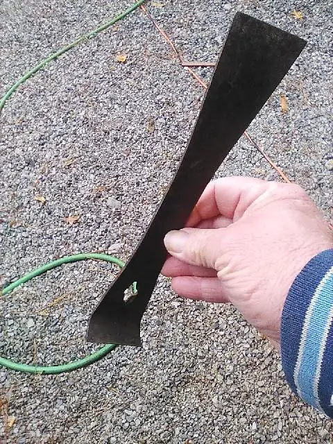

Monday a new Bosch 02 sensor was in the mail box. Saturday in my sea (C) box I found a tool that may help me pop the cristmas tree out of the back of the drivers cylinder head. Maybe notch the flat end? Has anyone seen this tool before?
It's a tool to work on bee hives. Stamped in it says "little jimmie"
If you can sneak the tool in there and wedge something behind it to pry against, I bet that'll give you the best chance.

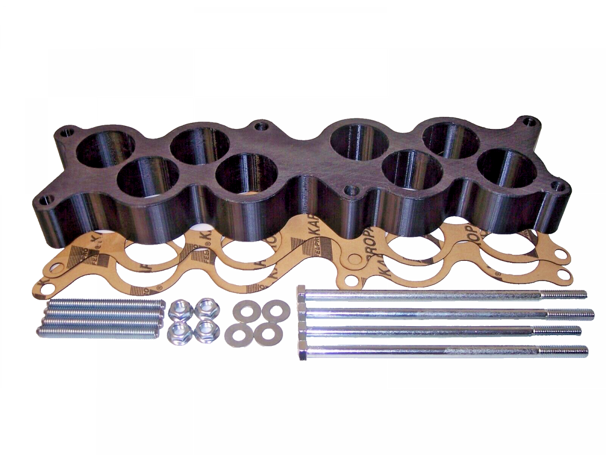

Has anyone seen one of these 1.5" spacers? Does anyone know if a 2" aluminum spacer is available or anyone that can make one?
1.5" 5.0 intake spacer
You do not want aluminum it is a great Conductor of heat
plastic is better
The spacer you posted above is very nice
