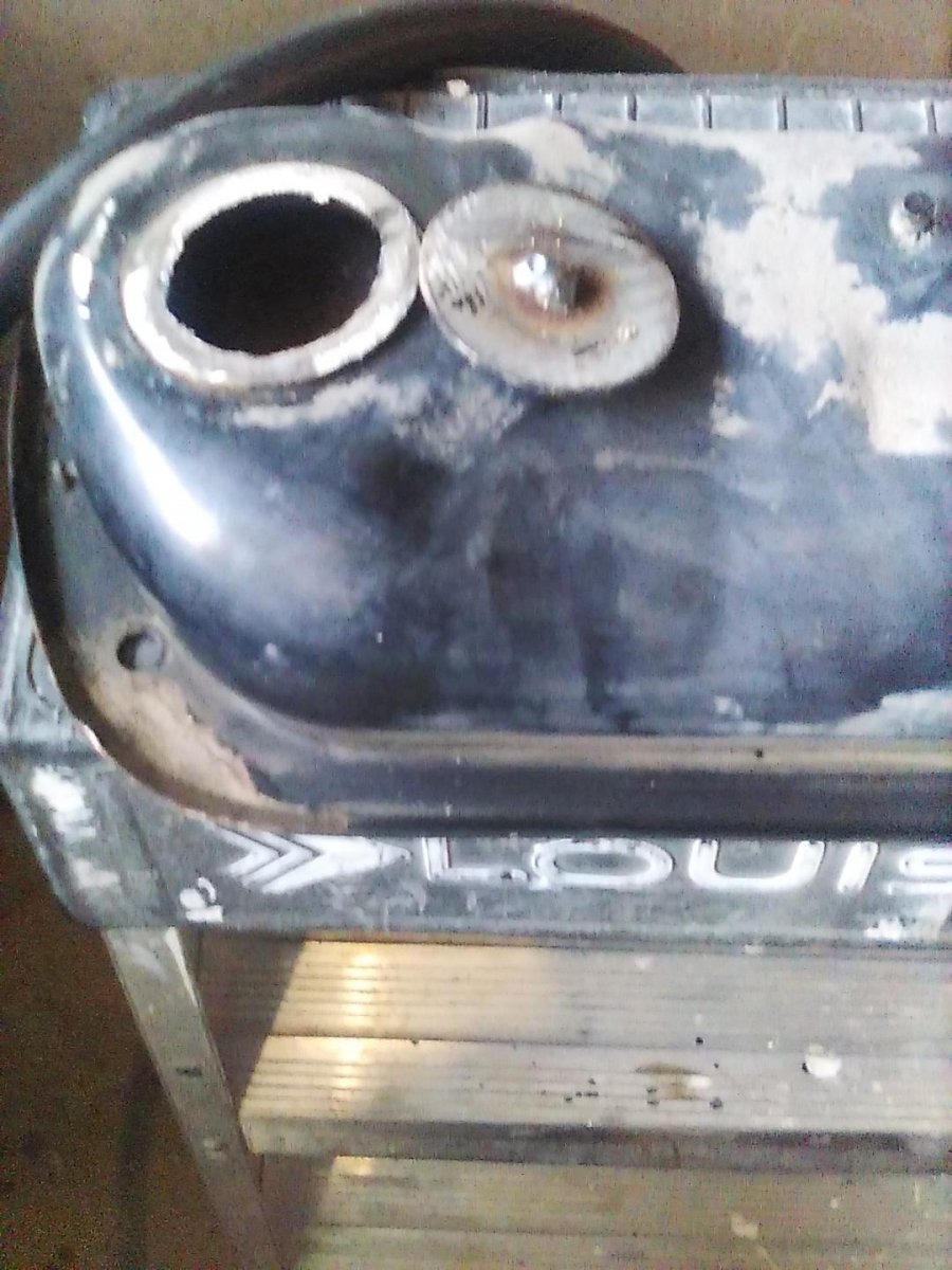

Early November was the last time that I was able to work on some engine parts for the '97 MM 5.0. Today, before I even got started it dawned on me that I may not have enough gray hi-temp RTV for the timing cover and the water pump. I finished removing the passenger side valve cover and it is sitting on the head to keep it covered. It will be off long enough to weld up the oil fill hole that would interfere with the coil-near-plug brackets. Of course, cleaning and painting too.

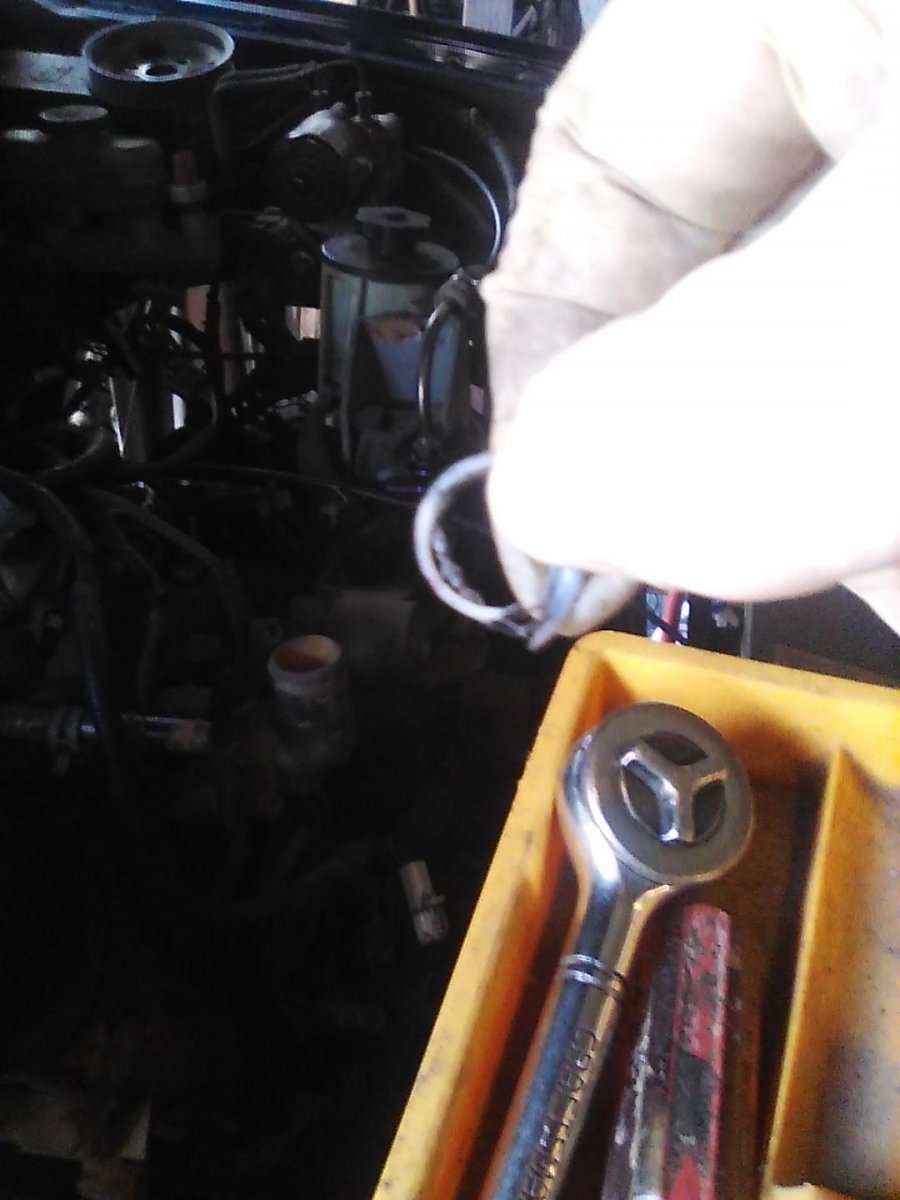

I disconnected the high pressure power steering hose and a little white plastic seal fell out or off of the line. Would that be a common Ford part?

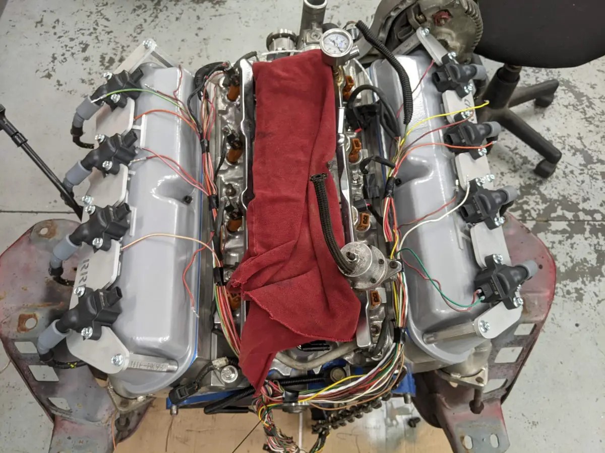

Below is a picture of Stephen R's, from VA, 5.0 coil-near-plug set-up. I'm starting with his design of brackets and work it out from there.

I would like to have a picture of it complete. This is bad azz...
This is so cool that I'll show it again. Look out LSs. (L S es)

That white piece is the Teflon seal which is in both ends of the high pressure PS hose. You need to install a new seal, those are virtually always a one use item. I've tried to use Teflon tape once, and the old seal one time that it didn't come apart like yours. I had a leak with the tape and just a slight leak with the old part, both times were about 20 years ago. That's when I hunted the seals locally, I got about four then, Ford didn't ever sell them that I know of. I've tried to buy a new hose when I had to replace the PS pump, I have one again now to do.
I like that SN95 COP layout, that will work well for his, and yours. I'll do something similar too, I will have a priority to leave space over the right valve cover for my later intake plenum(GT500 TB and plenum). The space is tight back there.
If those work for you, I'll definitely be ordering a pack. The plastic on my hose was pretty rough when I put it back. I'd just assume replace it before I spray ATF all over my clean engine bay.
@97Sandbox I'm hoping that someone will say "yeah, the Gen 2s have the type 3 steering"... Then I'll order a pack and sell fellow Explorer owners 4 ct for a nominal fee so that I don't own 20 plus for the rest of my life,lol.
Here is what I used
I never use new ones and if the old one is torn I remove it. I don’t have any leaks? To me it looks like the seal should be made at the flare there should be no need for a seal at the top? Maybe I’m wrong but I don’t have leaks so….I do put orange rtv on the threads similar to what I think Ford did
If you have your hose off, you could measure the fitting, looks like that amazon listing has a surprising amount of detail. I'd pull my hose off and hit it with the caliper, but my Mounty is all snowed in today!
Measuring fitting on line.
"97mmhppumpline.jpg"
There are about three sizes common to see in searching, I took a new hose when I found them 20+ years ago to compare. That one on Amazon looks right, but the size is hard to say. I used my deep well 10mm socket to stretch the new seals when I put them on. So the inner diameter is slightly larger than what the old Craftsman 10mm deep well is at the working end.

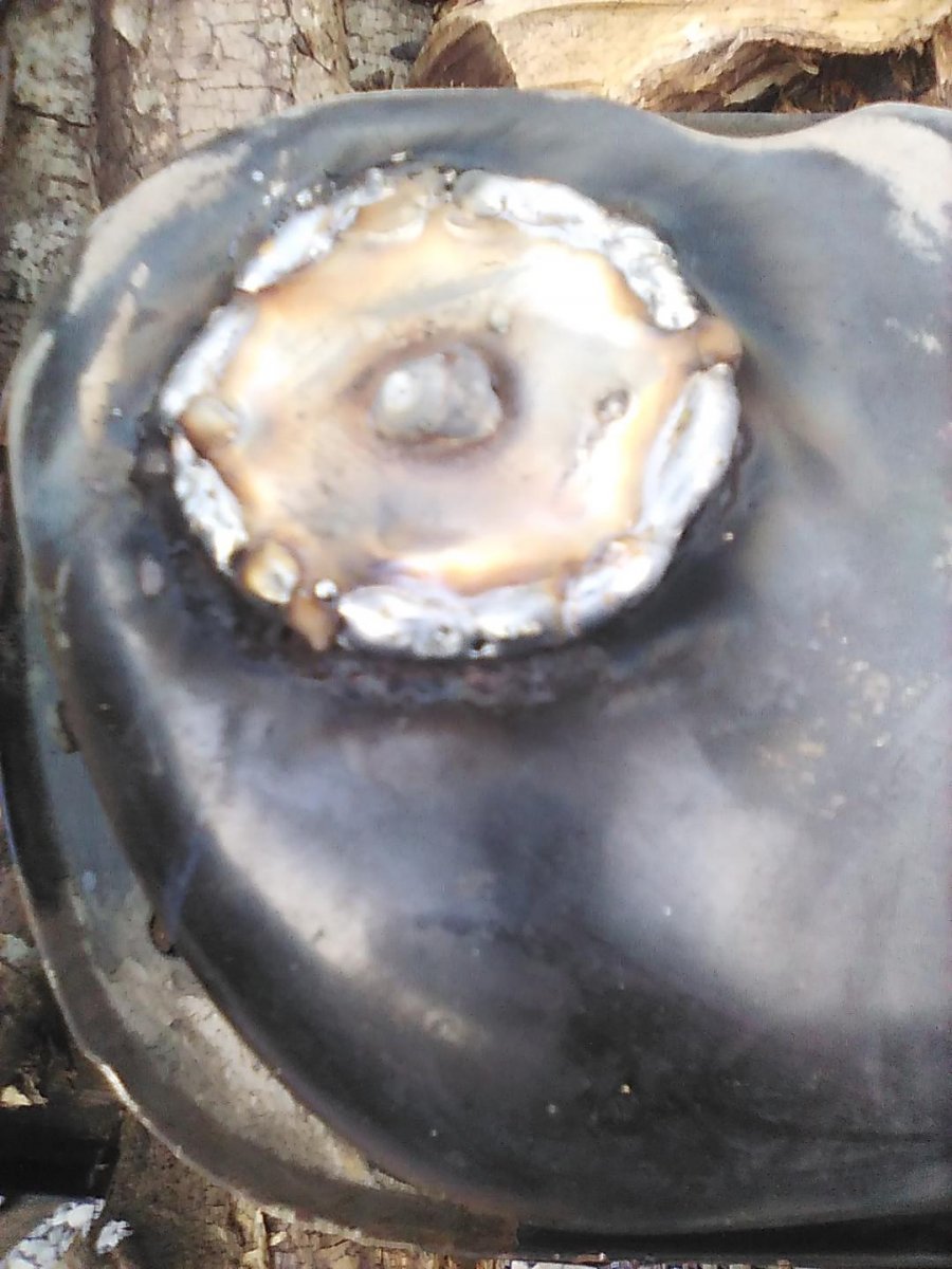

I purchased a steel conduit coupling to cut off a piece off it to weld to the valve cover for an oil fill port. It was galvanized plated.
I removed the plating by cooking the piece on the woodstove chimney.

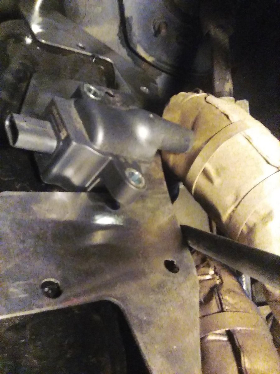

Yesterday I was able to start working with the template that will be the coil-near-plug bracket and I'm running in to fitment issues. The bracket was designed for a 5.0 that all of the exhaust runners head down before they unite at the collector. On the Explorer/Mountaineer 5.0 trucks, this is not the case. The right-side fits ok with only a little interference with the AC box. I stripped a heat shield off of the box and gained a little room. I didn't want to do this because I know that the heat shield is on there for a reason. The left lower corner of the bracket can be trimmed a bit. Also the coils need to slide up the bracket about a half to an inch for more boot clearance. The upper intake and spacer need to temporarily go back on to check all of the clearance points.

The left, drivers side US, is where all of the problems are.
And a picture of the coil sitting in the third position in the bracket. The coil wire would be on the header.
@410Fortune Jamie, do you have an extra driver's side valve cover. The passenger side cover needs to be swapped out to a driver's side with no oil fill hump on it.
I know that we have had numerous discussions about exhaust manifold and header interference, but I'm going to have to do something. even if it I have to make a 2-piece steering shaft with a universal joint and Heim joint to relocate the steering shaft in order to use some kind of Ford passenger car header/s that all the runners head down before the collector. Any ideas and anyone have an extra driver's side valve cover?

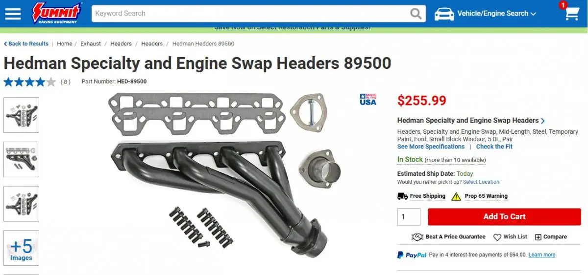

Here is a picture of some Ranger 5.0 swap headers. I wonder if they will work on the 5.0 Moutaineer if I build a custom steering rod. Has anyone used these on a Ranger 5.0 swap project?
Ranger 5.0 swap headers are designed to work with rwd trucks

I'm looking at the 82-97 Ranger 5.0 swap headers and wondering if the left one would fit with a modified steering linkage. If so, I wouldn't need the pair.
That left collector is tight in the OEM orientation next to the fuel/brake lines etc, that header might move it outboard and that wouldn't work. It's just hard to say without a test fitting.
