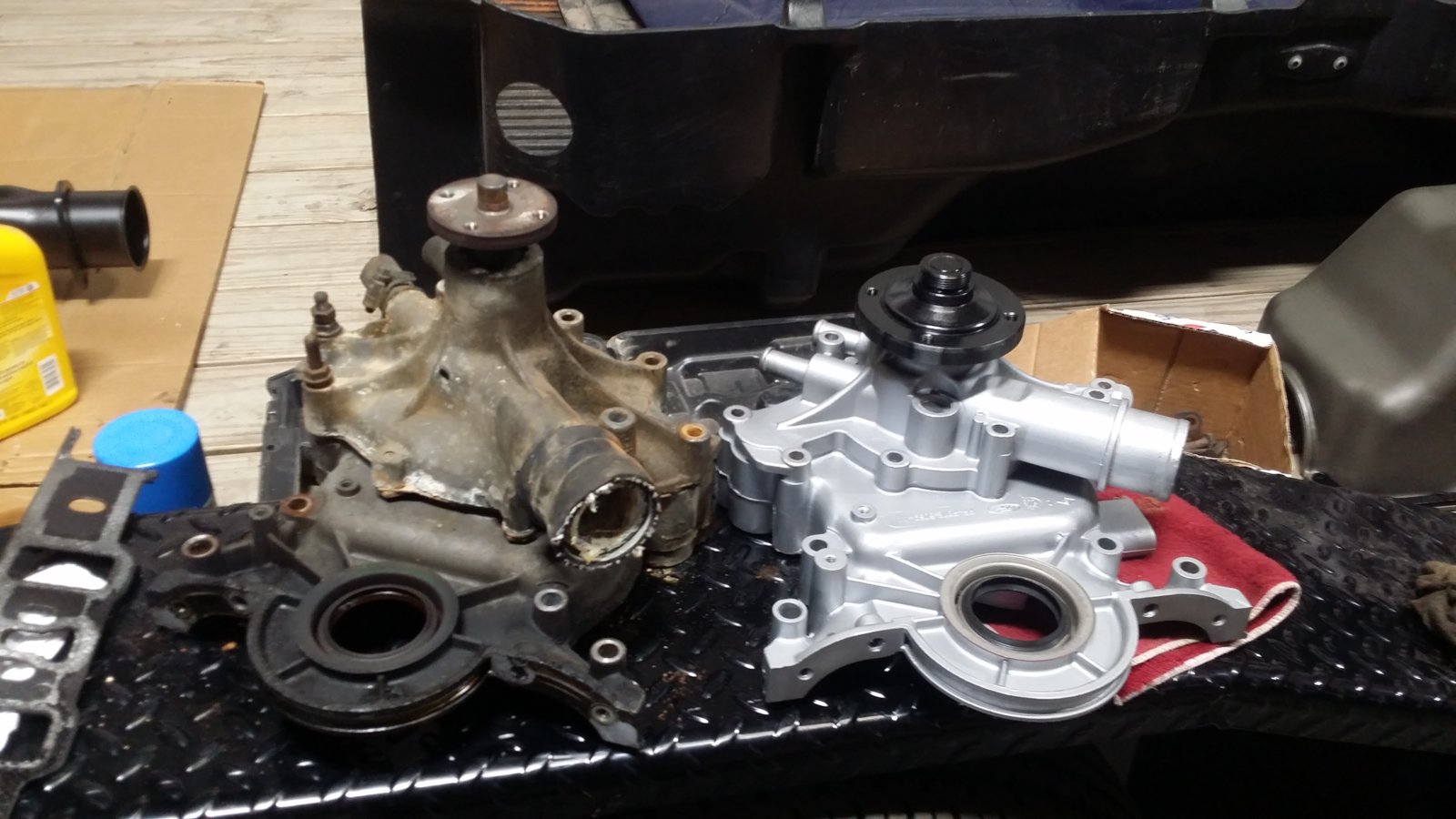

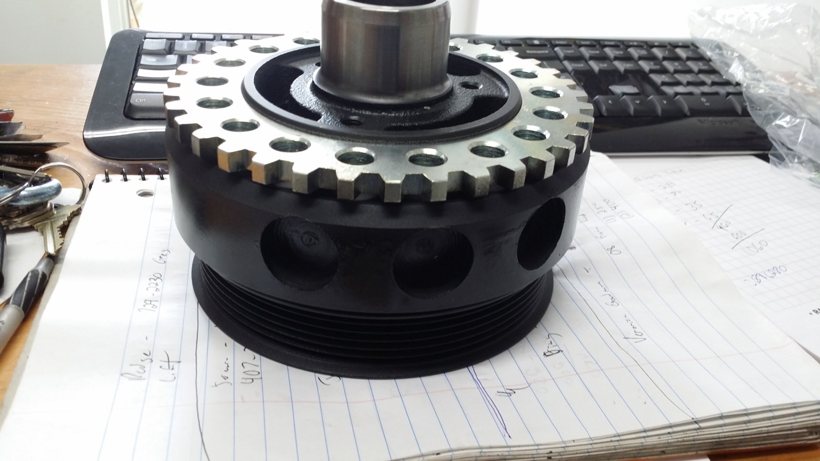

Ignition: Stock Explorer coil tower ignition with modified cam pos sensor and damper dudes 28oz explorer balancer for crank trigger
Belt drive/timing cover: Factory explorer 5.0

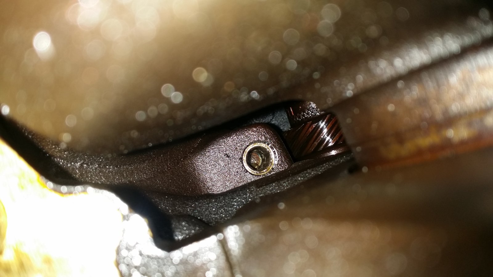

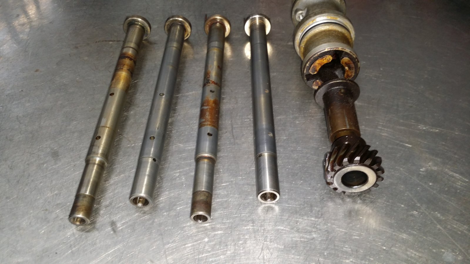

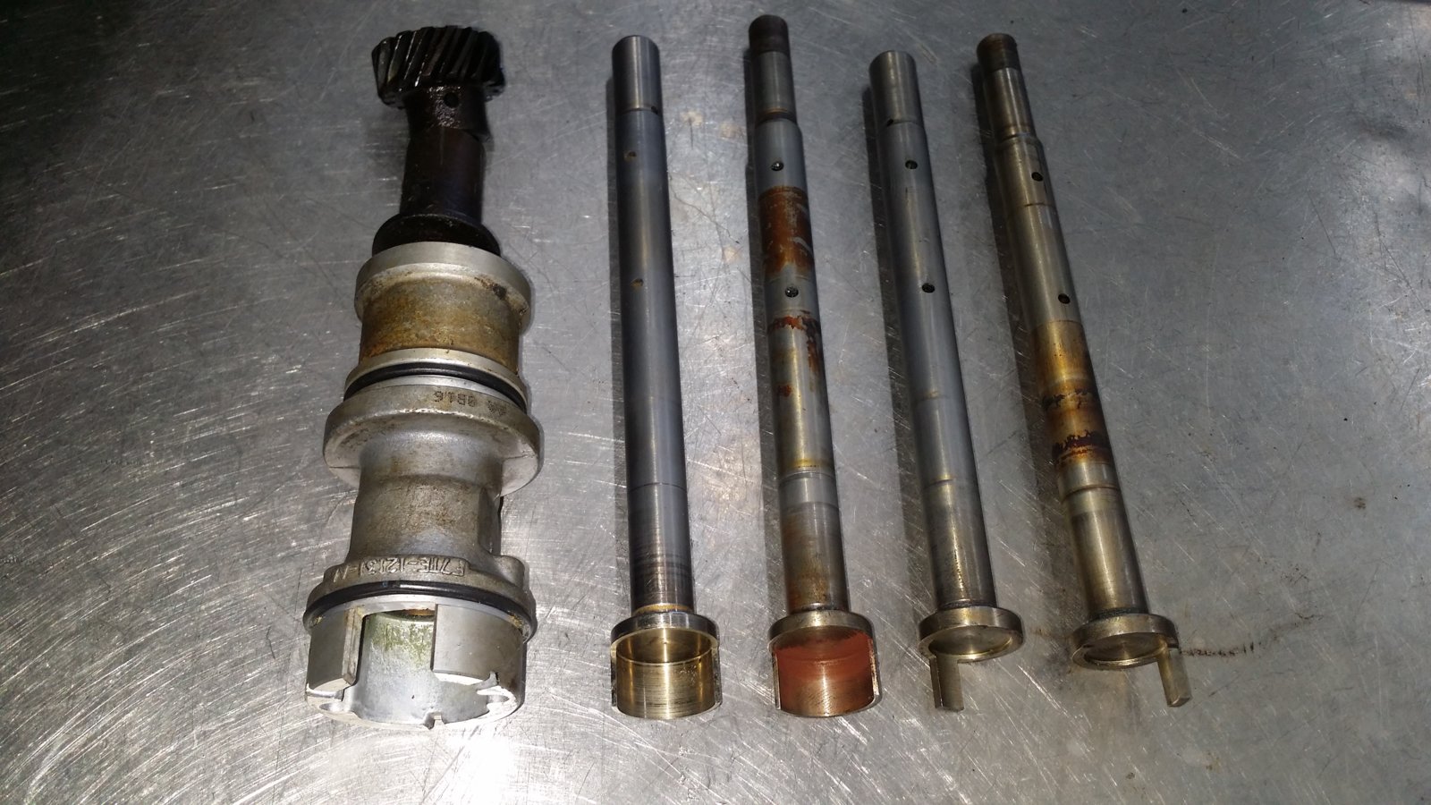

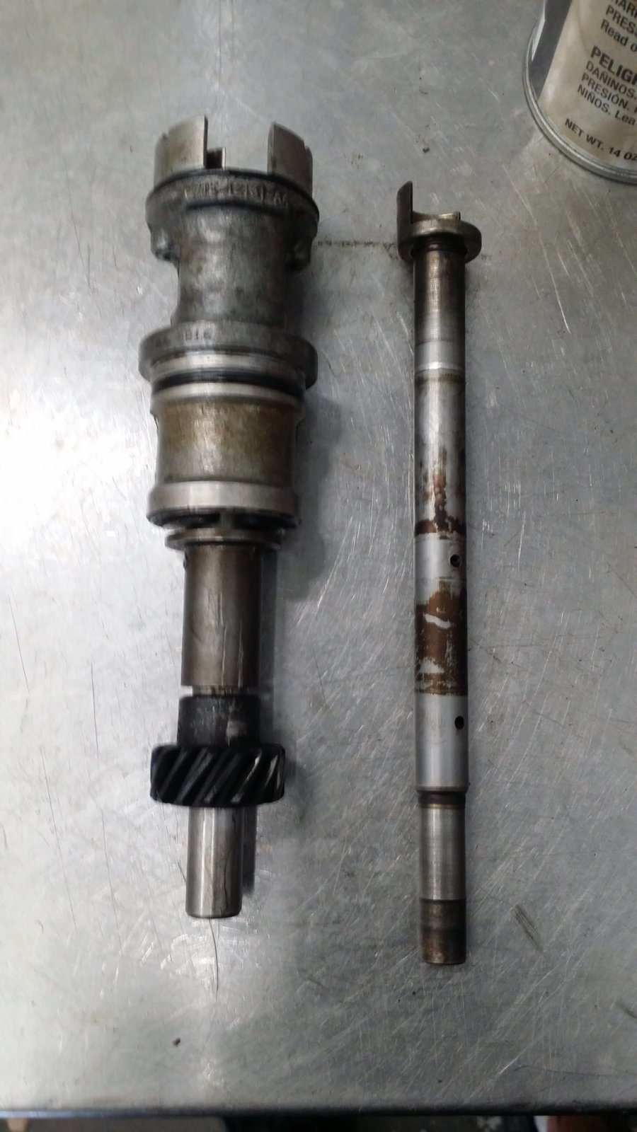

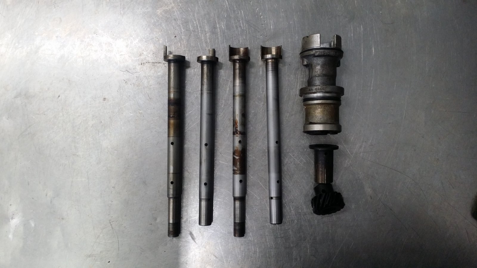

Cam position sensor:
302 to 351 sensor conversion is done with a CPS driveshat out of a 3.8 mustang CPS and the rest of the guts from the 5.0 explorer CPS. There are 2 different versions just like the explorer, 2 wire and 3 wire which each have a different head on top of the drive. 96-98 is 3 wire, 99-01 is 2 wire. I broke down a few CPS sensors to make 1 good one so I suggest grabbing a few from the junkyard if you can. High milage units seem to have play in the body bushing. I ended up using a low mile 00 body and gears on the 97 mustang shaft with 97 sensor. Last pic on table is the now 351 CPS with the original 302 driveshaft beside it.
The 302 CPS driveshaft is slightly longer than the 3.8 driveshaft but the oil pump driveshaft fits tight with no up and down play.

Damper Dudes 28oz explorer balancer and stock Explorer timing cover bolts right on. www.damperdudes.net

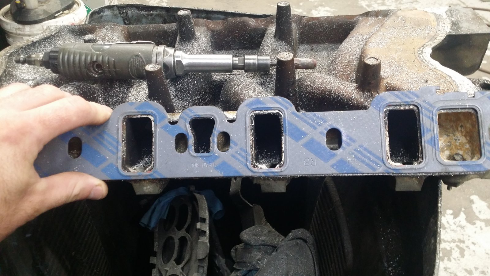

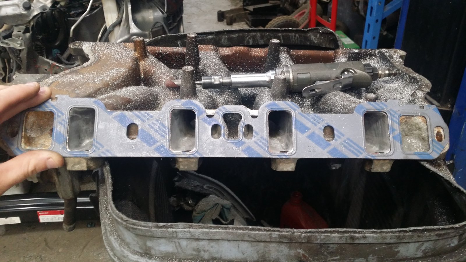

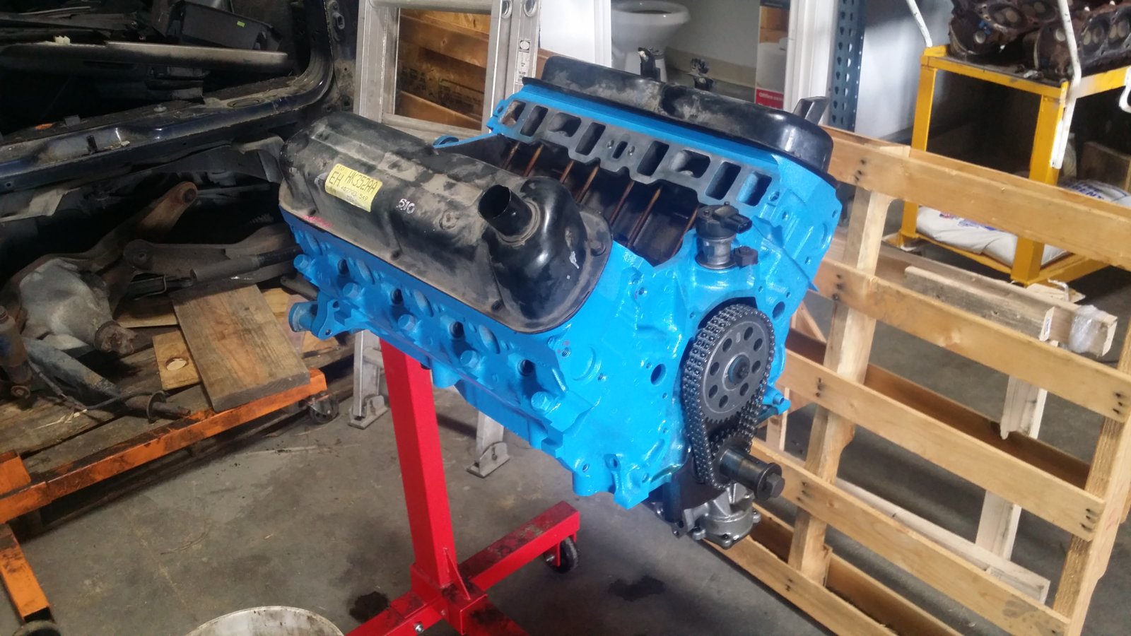

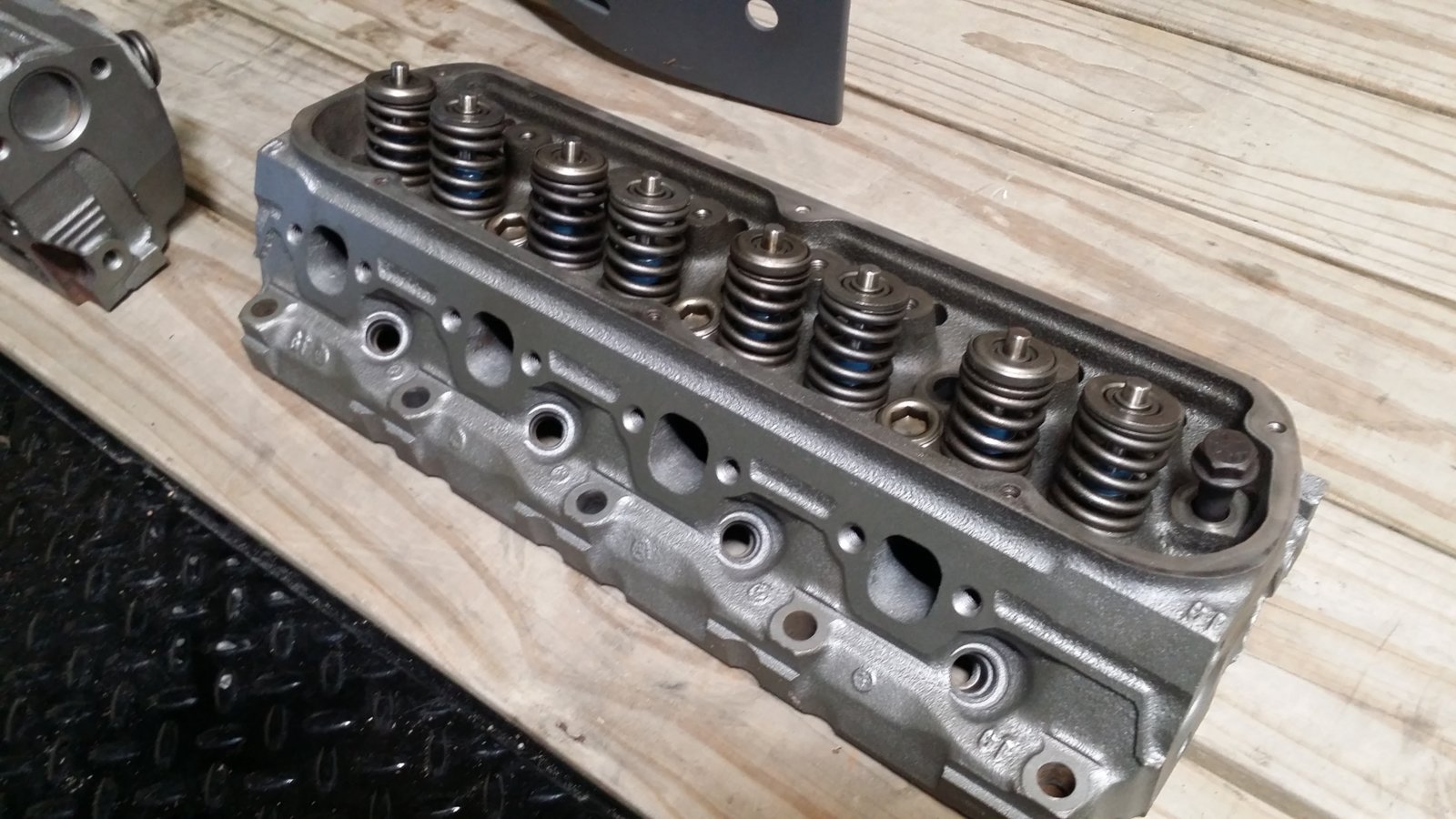

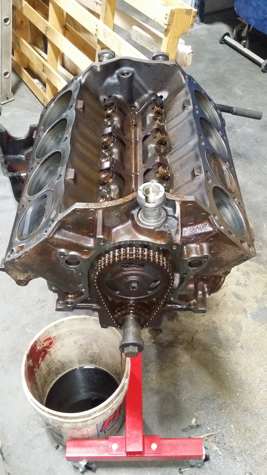

Engine assembled: Low mile GT40 heads replaced factory E7 heads (engine is a 1996). I left the block stock. Bearings looked good still and minimal cylinder wall wear so it's good for another 100k. New oil pump, timing chain (351w is factory double roller).
Intake manifold: Ported stock 351w EFI Truck intake. I would have gone with the gt40 setup but I can't justify the cost. People want at least $500 for the lightning or Ford racing gt40 lower 351w intakes. I searched for a cheaper iron gt40 lower (marine) but couldn't even find one.
I ported the lower intake to the gaskets for the E7 heads. They actually overhang the gt40 head ports slightly so I'm probably going to use the larger sbf intake gaskets. I've probably got a strong 10 hours in porting the intake and I still have a bunch of finish work to do. There's a ton of meat that can be taken out.

For the CPS, I thought the 351 required a larger dist/housing than the 302? Others have made a thin spacer from what I recall, or sourced aftermarket stuff. Please detail that very well, even your first pictures don't make it really clear which are 302/V6/351 components. I'm going to build a 351 for my Ranchero, but Haven't decided whether it shall be a Windsor block, or a Dart 302 bored .060 over. The CPS is one item I'd rather not have to custom modify etc.
Since it's 2wd and using a 96 or 97 computer it needs a vss tailshaft signal. Sure I could convert over a 98-01 trans to vss but this one was the right price. This is a 100% budget build. I'll be surprised if I have $2500 in it when done. 95% of the parts used are from my local pick n pull junkyard.
The CPS is simple. If you look at the end/bottom the diameter of the 2 shafts compared you'll notice the 3.8 / 351w shaft it a good bit larger than the 302 shaft. You use everything from the 5.0 CPS except the center shaft which you swap out for the 3.8 shaft. It is completely put together with roll pins. With some careful vise holding and a small punch it comes apart through the top as soon as you punch out the roll pins. I'll see if I can add some more pics.

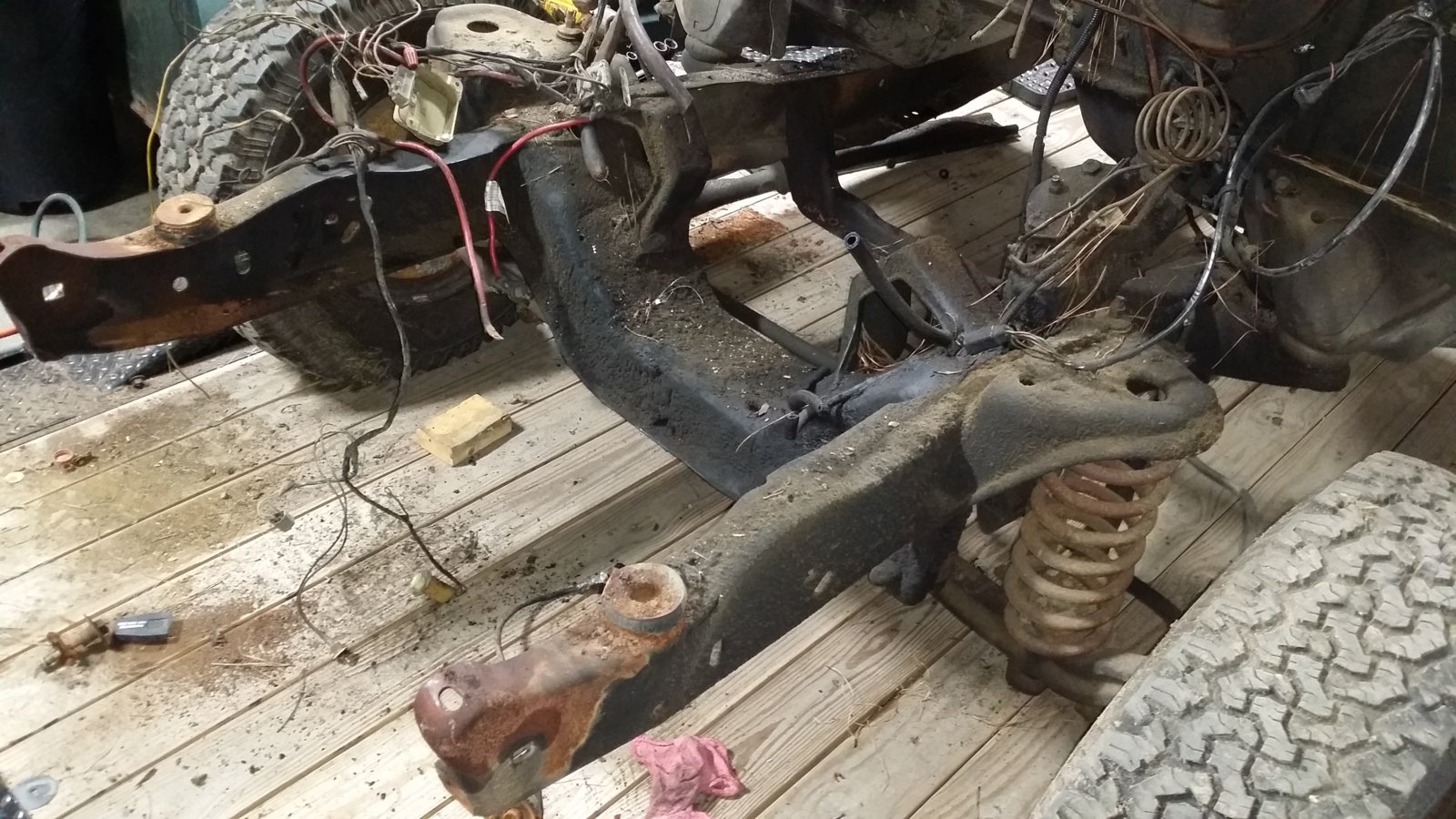

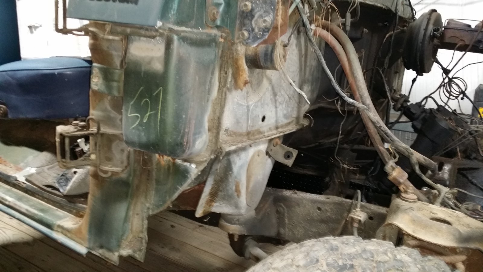

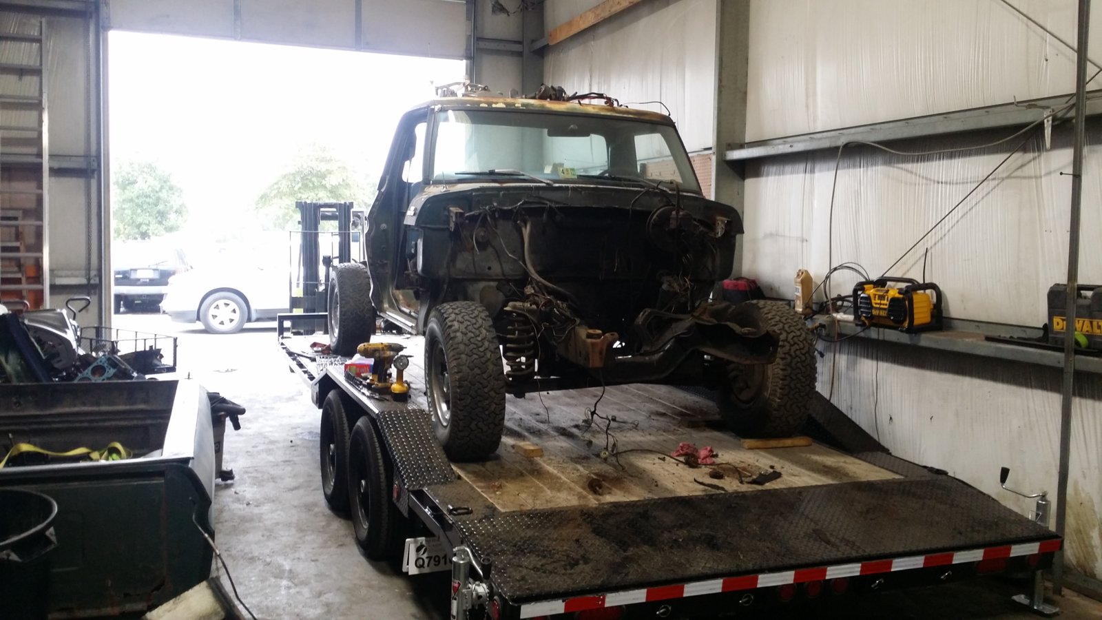

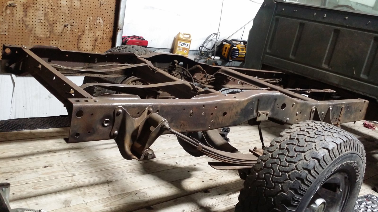

This has been the week of dismantling. Truck came apart great, only had to cut a few bolts. Getting ready to pull the cab then on to cleaning and painting the frame. Some rust repair on cab and bed will be done while it's apart. I'm going to at least do cab corners and floorpans in the cab and just the bulkhead of the bed. I plan on putting the rusty doors back on and leaving the rust on the besides as they can be fixed at any time. The frame appears to be in GREAT shape.

The 302 to 351 intake adapter plates price motorsport sells is about half the cost of what people want for the 351 gt40 lower intake. Awesome build!!
Yeah I've come across it before. I've considered it but I feel it gives an extra area for coolant to leak if things don't stay perfectly torqued.
My ideal intake would cost over $1100 new. Edelbrock makes a sweet truck intake with long runners and dual tb. The intake is just shy of $800 new but then you need a $350 throttle body to flow it. Not in my price range but i could justify it over spending $550 on a used gt40 lower that doesnt flow as well.
There's always the knockoff pp intake made for Mustangs for about $450 on ebay. I'm not a fan of cheap Chinesium metal so that's not much of an option either.
It's looking like the ported stock intake will still be the plan for now, I can always change it later when I find a better option.

The 351W EFI intakes are not great to choose from. I forgot that that company made an adapter for stock intakes(302 to 351). I saw the ones to install Windsor intakes onto a Cleveland, and that made me drool.
I'd probably get that 351W to 302 adapter(plates), and try a common 302 EFI intake. Many can be had for under $400 complete, like the RPM II, or the Holley Systemax II, and the TFS intakes. With those plates, you would have to spend extra time porting them to match the heads and intake, mocked up many times. That would take a good while, but sealing it should be fine using good Ultra RTV.
