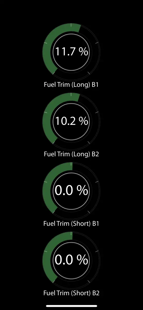

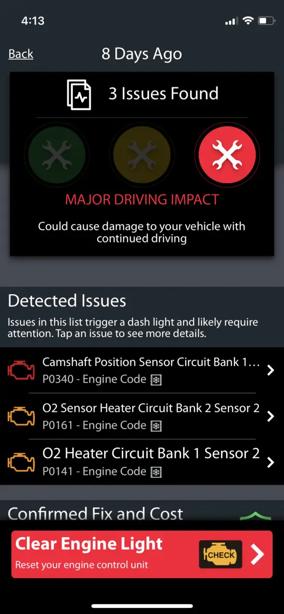

1997 5.0 has been getting progressively worse or I notice it more. At low rpms (under 1000) step on accel and bog and take off, sometimes backfires. Seems to fall off at high rpm but really trans isn't shifting when it should.
These are the codes I pulled. I disconnect and removed the cps once to pour oil in the oil pump drive. I scanned again multiple times and no cps code, did get the o2 sensor codes. Here's what the scanner will show me. Also have a manifold leak that could throw off the reading. Waiting until I have the money to buy plugs, wires, manifolds, and o2 sensors. Do I need a time to remove the 2nd set of cats?

I had a bad o2 sensor that would cause bogging / surging / pulsing acceleration (kind of like a trans slipping in and out of gear) ....since you have the codes for those I would of course roll with that and replace them, you could disconnect them at harness points and thus your PCM would run in open loop mode regarding disconnected sensors / pre-sets and hence if symptoms then disappeared that would confirm it's the o2 sensors.
You have an oxygen sensor heater circuit code, two of them in fact both on bank two
Bank two is drivers side
I would inspect the wiring and check fuses
If those
Check out and the heater circuit codes persist
The 02 sensor is faulty and needs replaced
After you check fuses and wiring leading to the oxygen sensor I would plan to replace it
Yes faulty 02 sensor(s) will cause your issues

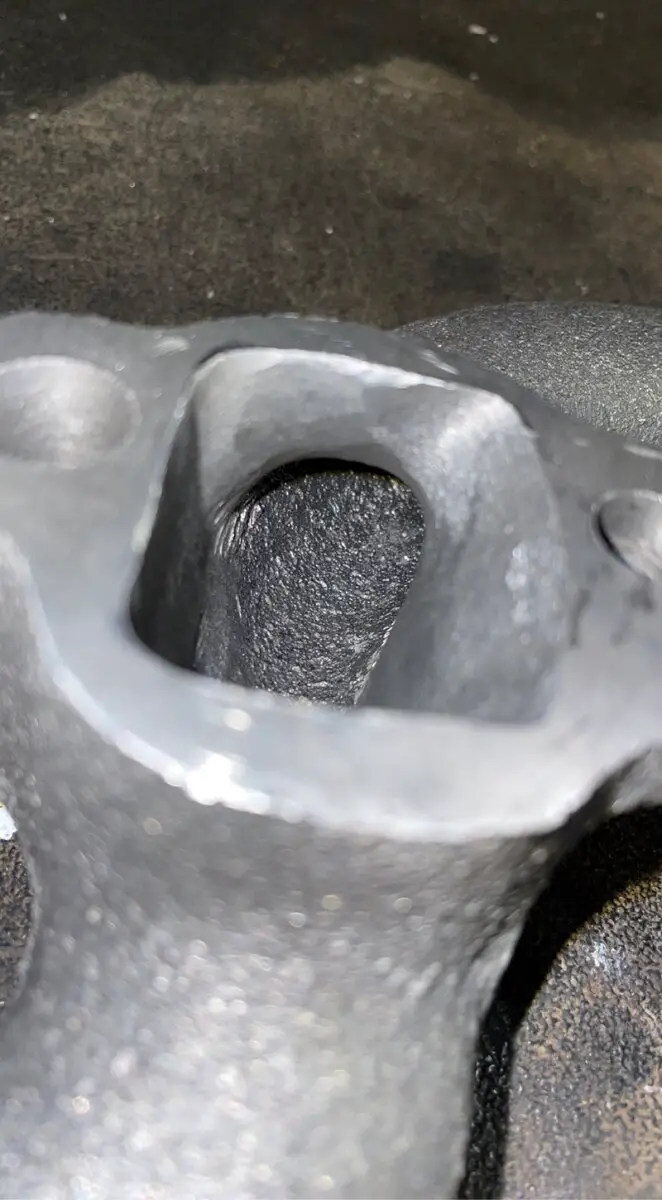

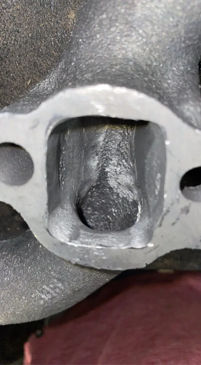

I did one port on the drivers manifold today, the 3rd one back which is the shared port. These manifolds suck, I could never put them on without doing this port work first. I managed to open it up a lot though, gonna do them all like this and open the outlet.
Start with those O2 sensors, that poor running is the major issue there. The leaking main seals will be the very hardest, you have to pull the engine or trans do get at those two at the back of the engine.
The exhaust manifolds are horrendous, so bad I wouldn't waste any effort on those. Go through all of the tune up items fist and get it running well again. Then worry about the leaking, which can take a long time depending on how many and how bad they are.
The Dorman castings do need some cleaning and de burring that is for sure but they are a far better alternative to the crappy welded 96-97.5 manifolds
I am glad Dorman decided to make these for sure. Compared to the stock cast parts 98-01 they are not bad. Some time with a dremmel will go a long way

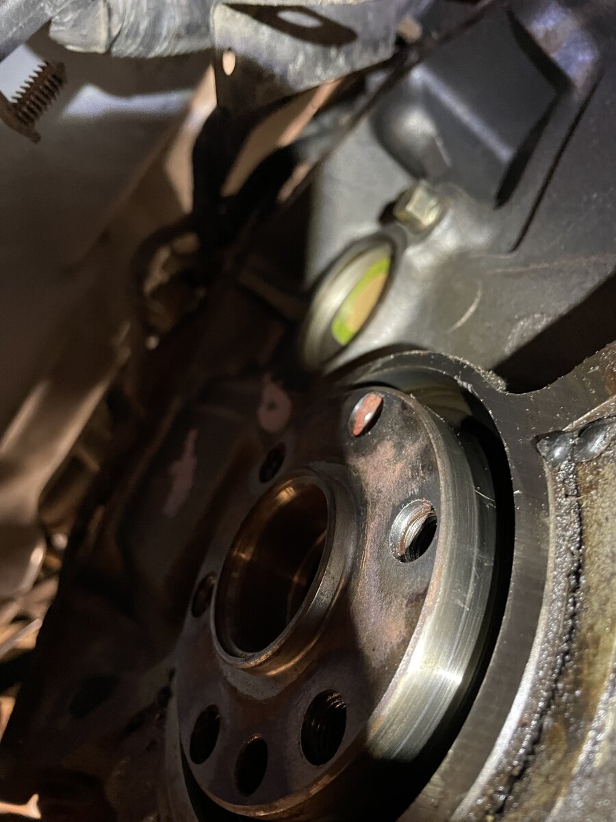

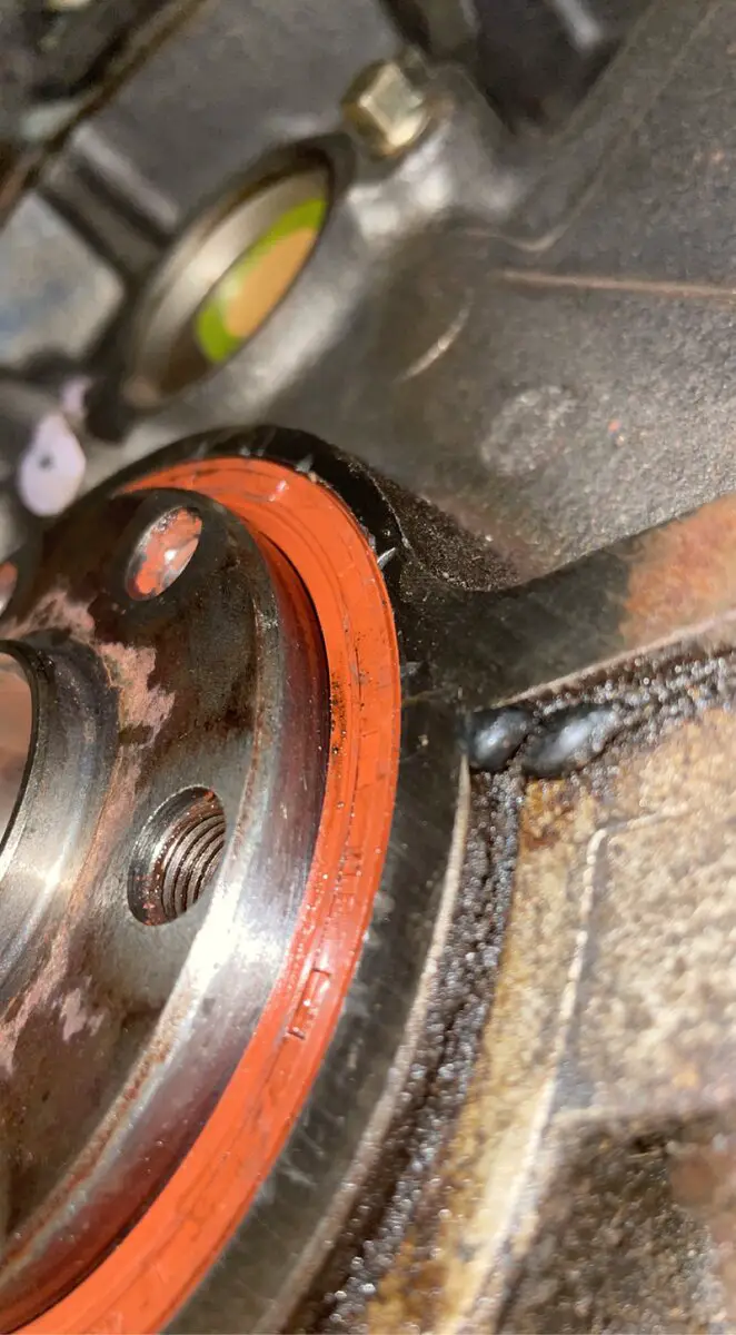

I go the trans out and new rear main in. Scratched the crank it's probably going to leak now, if it didn't before. Looks like it could've been coming from the pan.
Gonna button the trans back up today and hopefully get the drivers side manifold off. Got the tb off not much room to work but hopefully can have the intake off today then start going all back together. I've only broke a couple vacuum lines so far on the whole deal. 477F5CEC-963B-4B5A-94BE-A882FC985ACF.jpeg
If you’d scratched the crank under the seal you may consider a speedy seal? Before you put it all back together
The rule of thumb is if the Knick or scratch catches your fingernail you may need to use the speedy seal dealio
Idk how deep they were as I could never get a finger nail in there. I oiled a piece of emery cloth and wrapped it around the snout and polished it up a bit, so I don't think there's anything left to tear the seal I can't imagine it not leaking though. Speedy seal next time if I ever pull the trans again. I bolted it back up to the engine last night and while nothings really connected Im feeling extremely tired and sore after 15+ labor hours working on this thing, my shoulders don't like me right now.

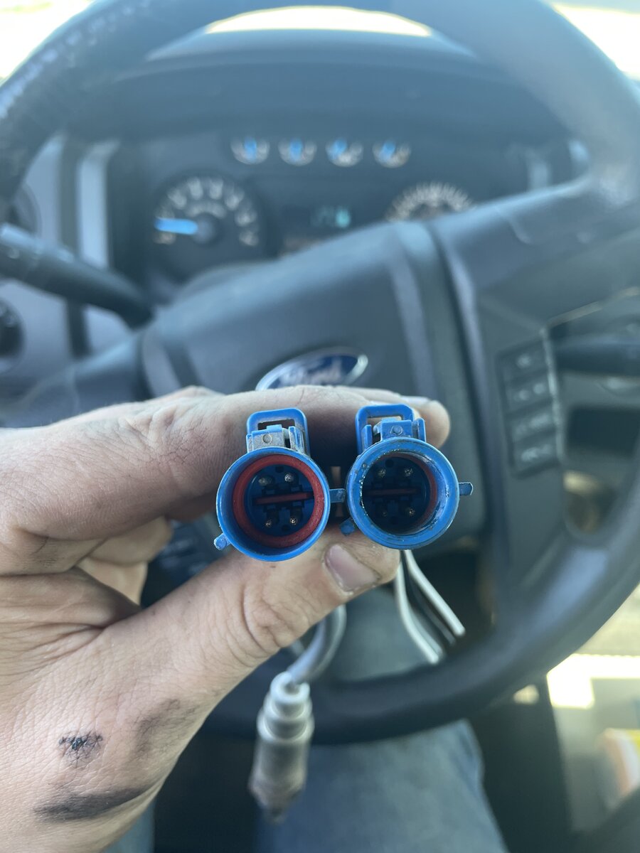

I'm about to take this piece of **** to the dump, go to install the exhaust and o2 sensors and I can't get the damned blue plug 02 sensor on top of the trans plugged in. Tried 2 sensors neither will go in. The green ones plugged in fine, all my new sensors have black plugs and no clocking lugs, but WILL NOT plug in, no amount of moving the pins makes any difference, and I can't see the damn thing at all. The old sensor unplugged just fine 😡😡😡
It's very hard to reach the top O2 connections. I've R&R'd the O2 sensors that way three times, but it's much easier if you remove the console and go through the opening above the trans. It takes some effort to get the console out, but if you can't reach the O2 connections well enough from below with one hand, there is another way.

Yeah I seen that. But it turns out it's not the pins being misaligned, after I broke the connector free from where it was taped to the harness to look inside I finally figured out where the issue was. Looks like I'm splicing the old male end onto the new sensor..
Hard to see what’s going on? Both males? Lol wtf male and male don’t plug together well
Looks like somebody pinned a female connector w male pins, is that even possible?
Where did this 02 sensor come from
I try to keep track of all the fubar aftermarket junk we are delivered over the counter these days
Look closer, the plastic on the round part is thicker on one than the other. Those are both the old male ends, one of the connections is an odd one out.
