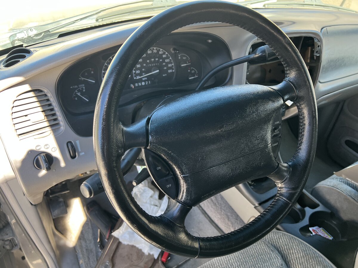

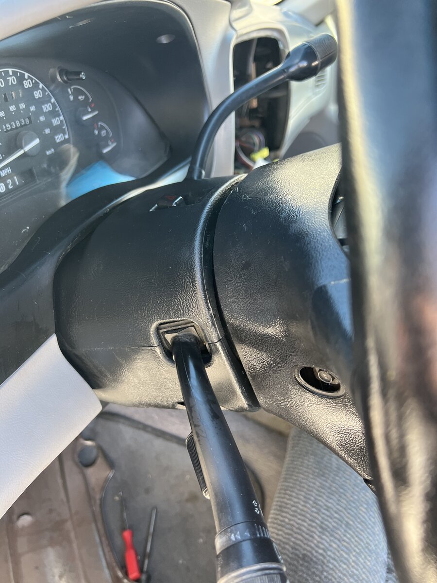

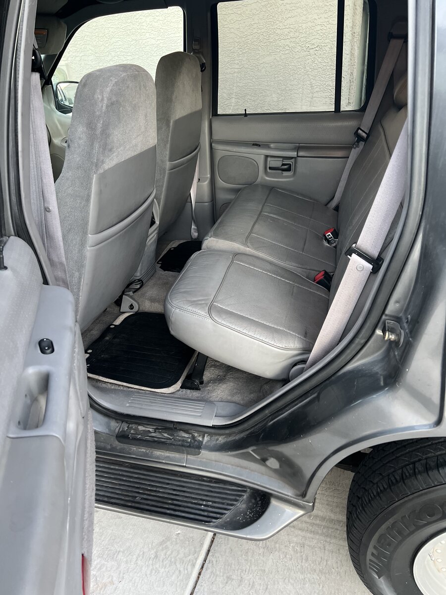

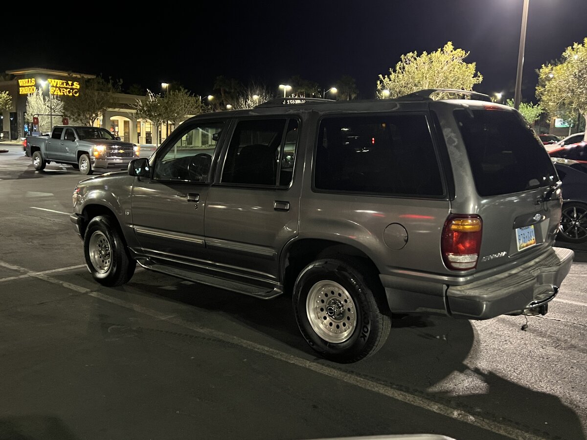

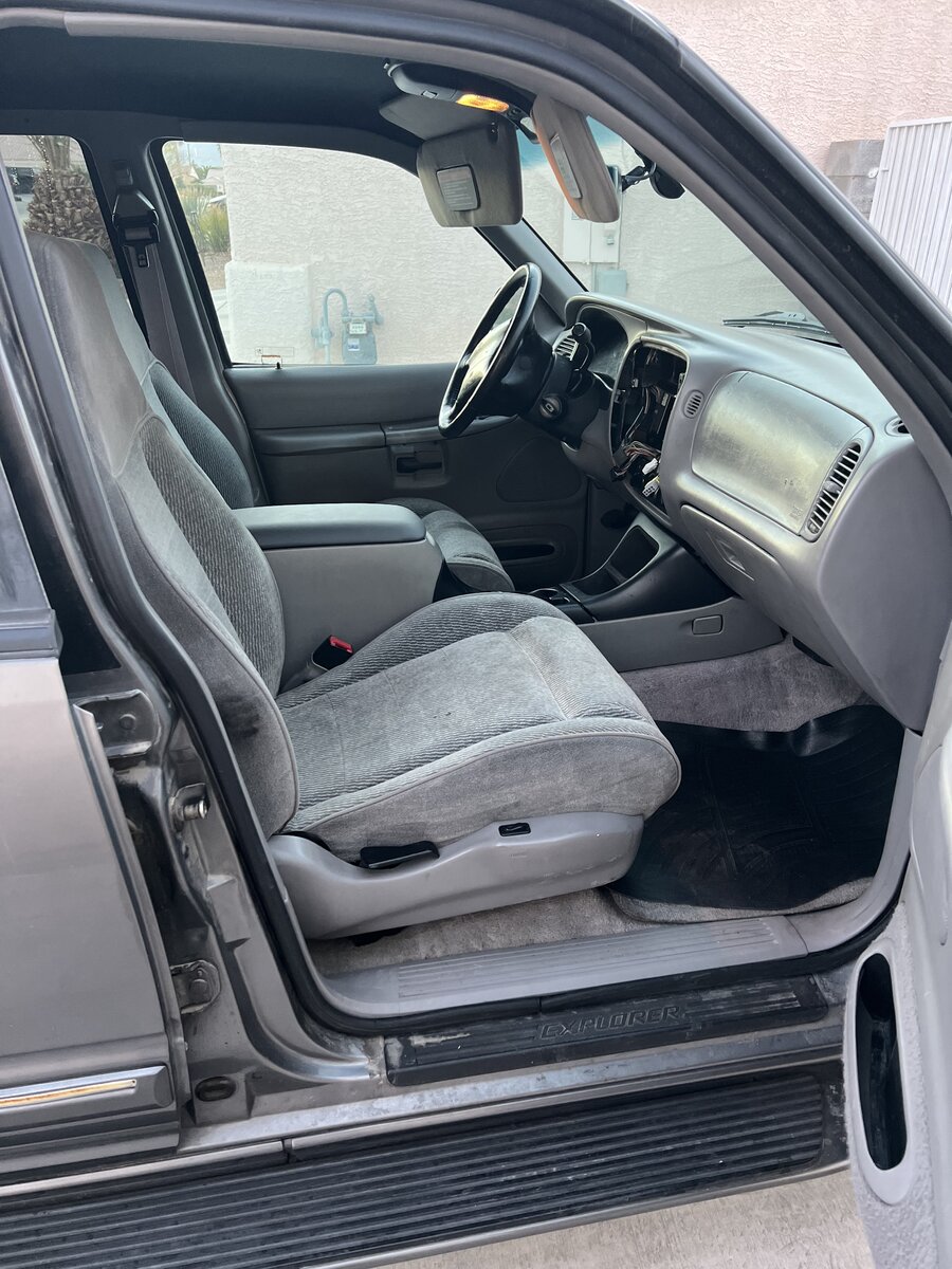

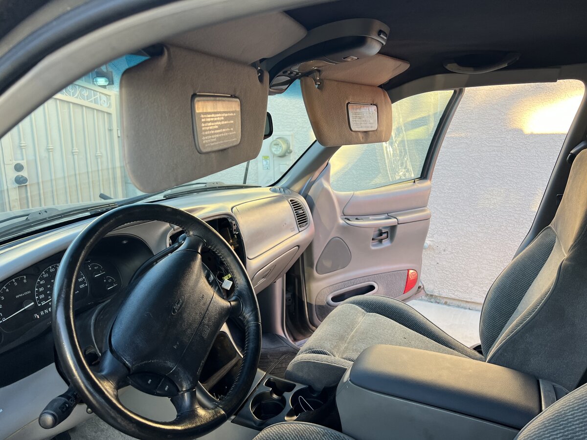

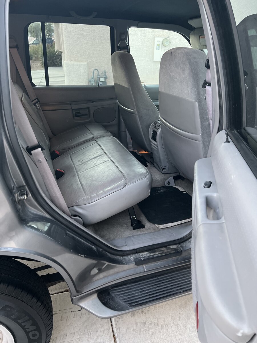

Working on finishing up the interior currently. Getting closer. This EX is going to the daughter by Sunday..
Rear tailgate panel is on and done. door panels all on, but looking for a few of the correct screws...sigh. All ceiling lighting installed. One of the sockets on the front seat light doesn't work..hmm. Rear view mirror is wobbly, need to work that out. Few more things to go.
The rear view mirror is a minor problem, it's held on by pressure and not by any set screw. I've had issues with all three of mine, my 99 I chose to put in a 91-94 windshield so I could use my 1993 mirror(has a set screw).
You have to push the mirror downward toward the bottom of the glass, carefully. It clips in, but pressure pushing it in and down tightens it. I have to adjust my mirror twice each day I work with it, to drive from the right seat, and then to go home, from the left seat. So mine gets loose somewhat often. I often use two hands when I can to carefully push it down evenly, I haven't made a mirror come off yet, so so far I haven't overdone it.
I had a new windshield installed. My problem is that the mirror is installed, it just wobbles a bunch when you drive.
Yes, it's not pushed on all the way fully. You have to push it on a little bit harder.

Ill take another look tomorrow but I don’t think thats the case on this. This has the autodim mirror. And it has all those plastic pieces that have to fit perfect to be on the windshield. All of that is in place nicely. But ill double check. Its dark out now.

All four of mine have the heavy auto dimming mirror, my 99 I used my old 93 Limited to rebuild it, I liked that mirror a lot. My Mercury was the first I noticed the vibrating mirror, that was after delivering mail with it for six months or more in 2006. My last two 98 Limited's with the mirror I have had less trouble with, once I knew that they needed more effort, force, put into the mount with pushing it down more. It's not perfect but usually I can make them not vibrate much at all.
