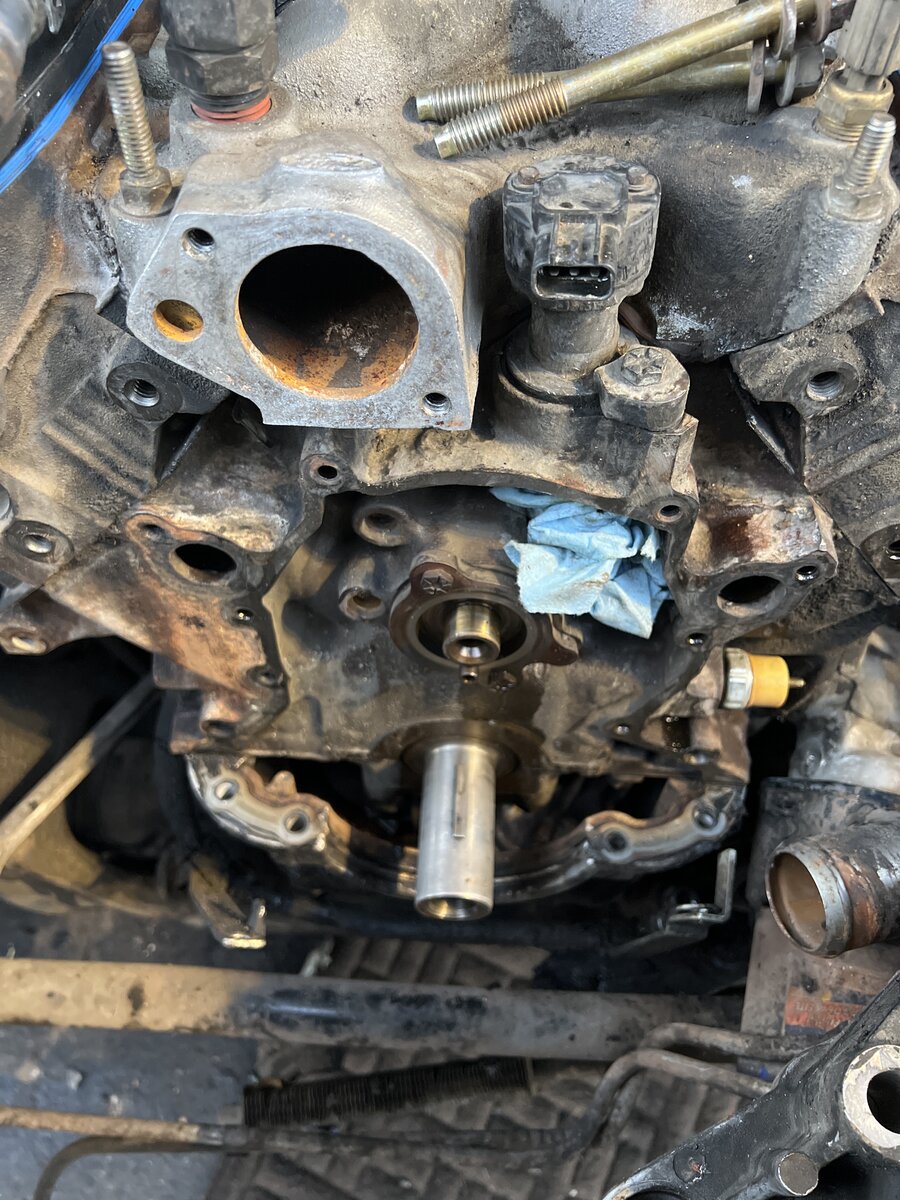

Got the timing cover off today.
No broken bolts!
Those 2 long ones suggest replacements.
Good call to replace the stat and pump.
That crank snout looks like no wear as well.

For as used as the rest of the rig appeared,that engine looks strong
No broken bolts!

All good points. I was on the fence a day ago about whether or not to do the water pump and timing chain. Now I'm glad that I did. In fact there was one broken long bolt. the head was broken off before I got there. Another long bolt wasn't even screwed in all the way. Had 1/2" between the bolt head and the cover. New bolts are in hand. Tomorrow should be able to get the pan off and get it and the W/P job done. That will be a relief. Will definitely clean the radiator. As far as being showroom, I won't have the budget for paint. Maybe my daughter can get it wrapped or painted. But I'll be handing off a fully functional and reliable vehicle. Which is the goal. And I need to get it done in the next couple weeks!!
