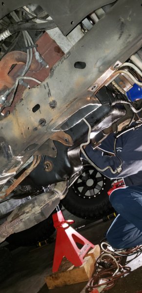

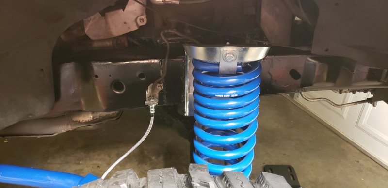

Removing the suspension
Keith Banta
March 22, 2019
15
7
LA PUENTE
1998 Ford explorer 5.0

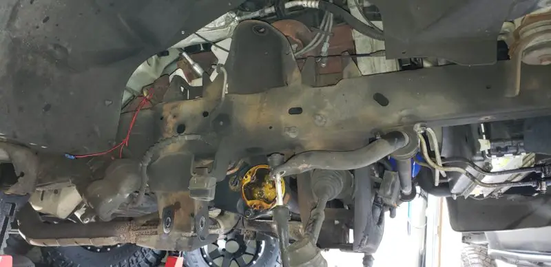

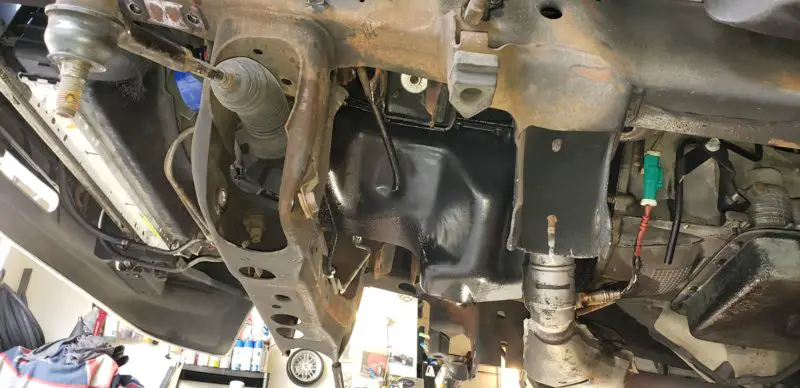

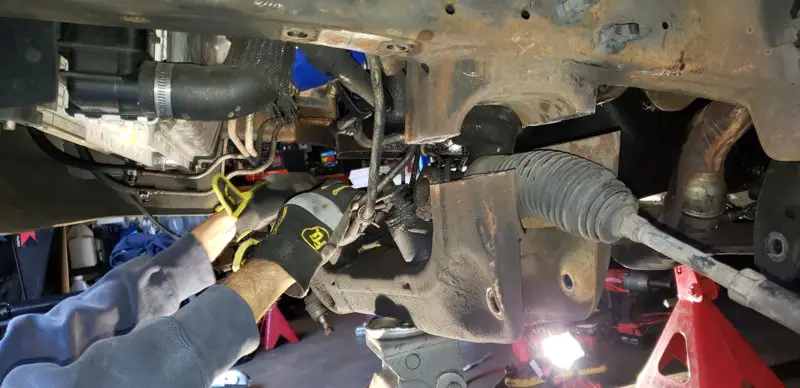

Cutting off all the original brackets to make the frame smooth and ready for new suspension sawzaw was my friend
Keith Banta
March 22, 2019
15
7
LA PUENTE
Making good progress had a the brackets cut off within the day

Great progress....how many blades did you go through? :)
What type of axle are you planning on running under it?

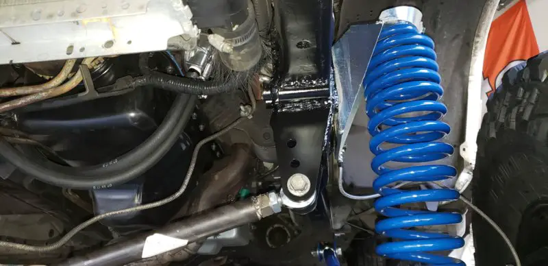

I'm running 78 bronco Dana 44 and stock 8.8 out back James duff suspension for the blades probably about two packs Milwaukee blades short and long work great

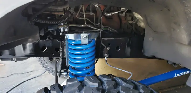

This the axle after the clean up primer paint and assembly 4.88 gears and locker with a hefty diff cover all new pieces in the rebuilt axle

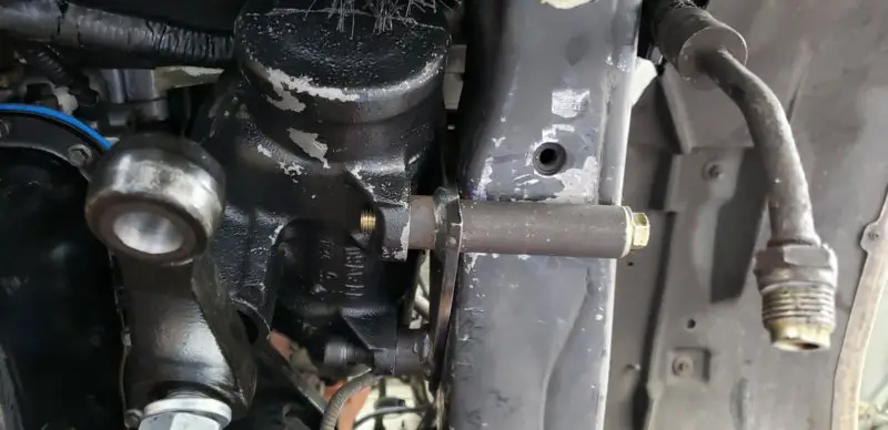

Im almost done with the front end couple lil things like drag link and ram assist
