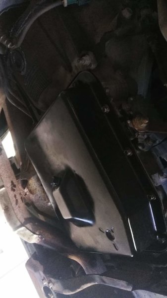

Fortune thanks for recommending the dorman pan worked like a charm.
She's still kicking. Threw some 31's on her and the just barely rub sometimes. I am going to try to lift it next
the dorman pan looks good... I cannot take the credit I learned about them here on EF
I will add one to the list of parts for my truck, I like where Dorman put the drain plug!

Got that dorman pan as well, it seemed to be of good build quality. +1 for drain plug.

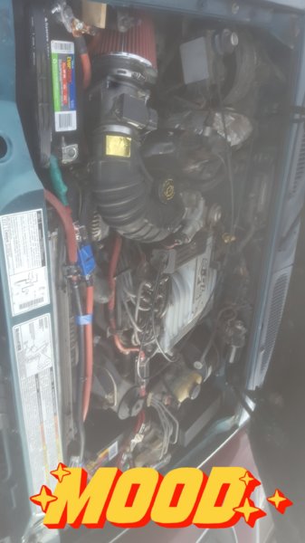

I did a thing this weekend. Stuffed another battery under the hood.

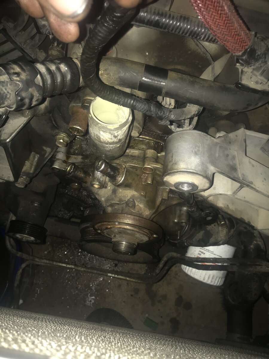

Still alive and kicking. Back to changing the water pump so I can get her running again. Got used to driving my 93 with all the snow 😅

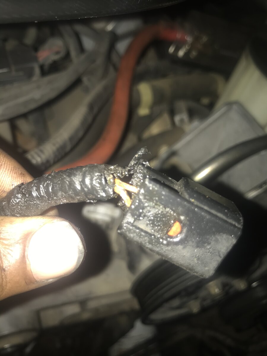

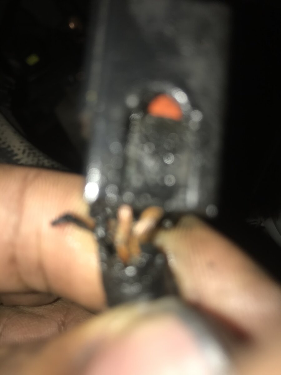

I couldn’t get it to focus but bare copper wire on the crankshaft position sensor? Is probably not good right?
I would not leave exposed electrical wires in my truck... especially when it is an essential sensor, and especially when it is in a location exposed to oil and water and general elements. You might need to splice and solder in another connector to your wiring harness, and might have to get that from salvage, but I can’t see the photo.

The connector and timing cover gaskets are in the mail :) . Such a headache but will be that much more reliable when I'm done

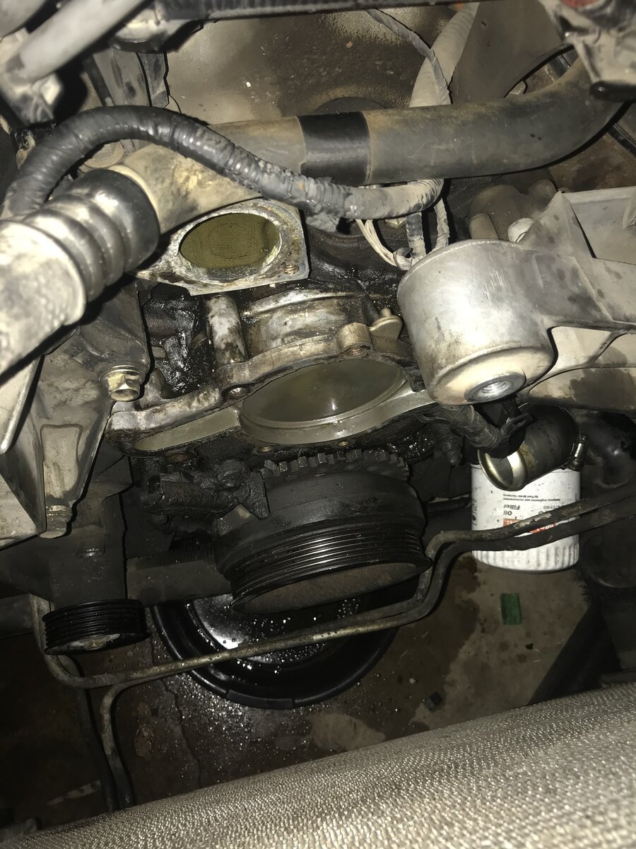

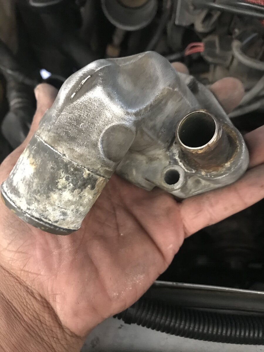

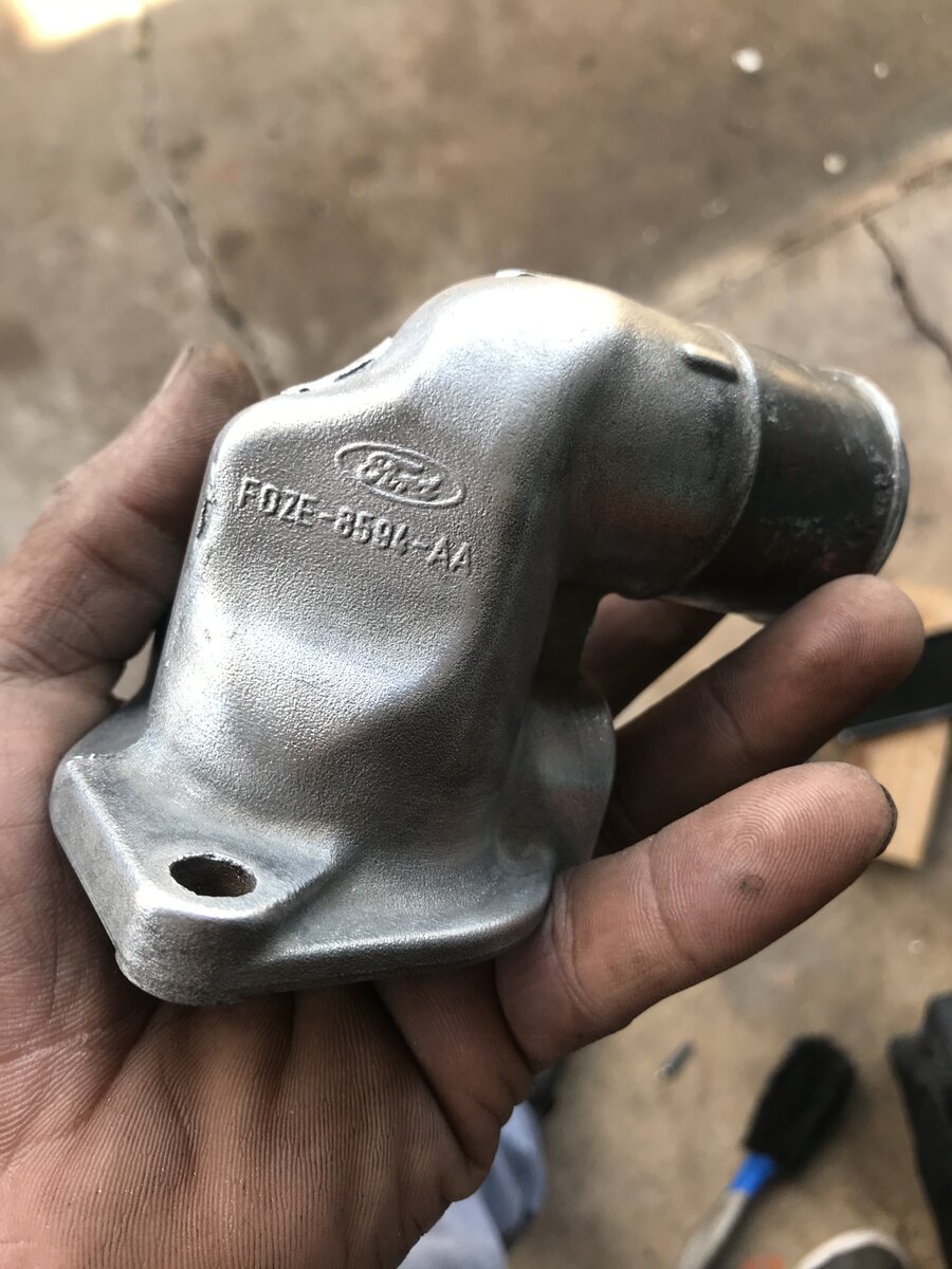

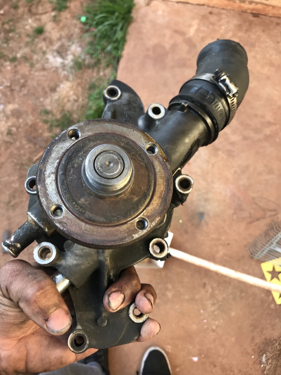

Getting closer. Water pump off no broken bolts After I torched them and the thermostat housing off and cleaned up.

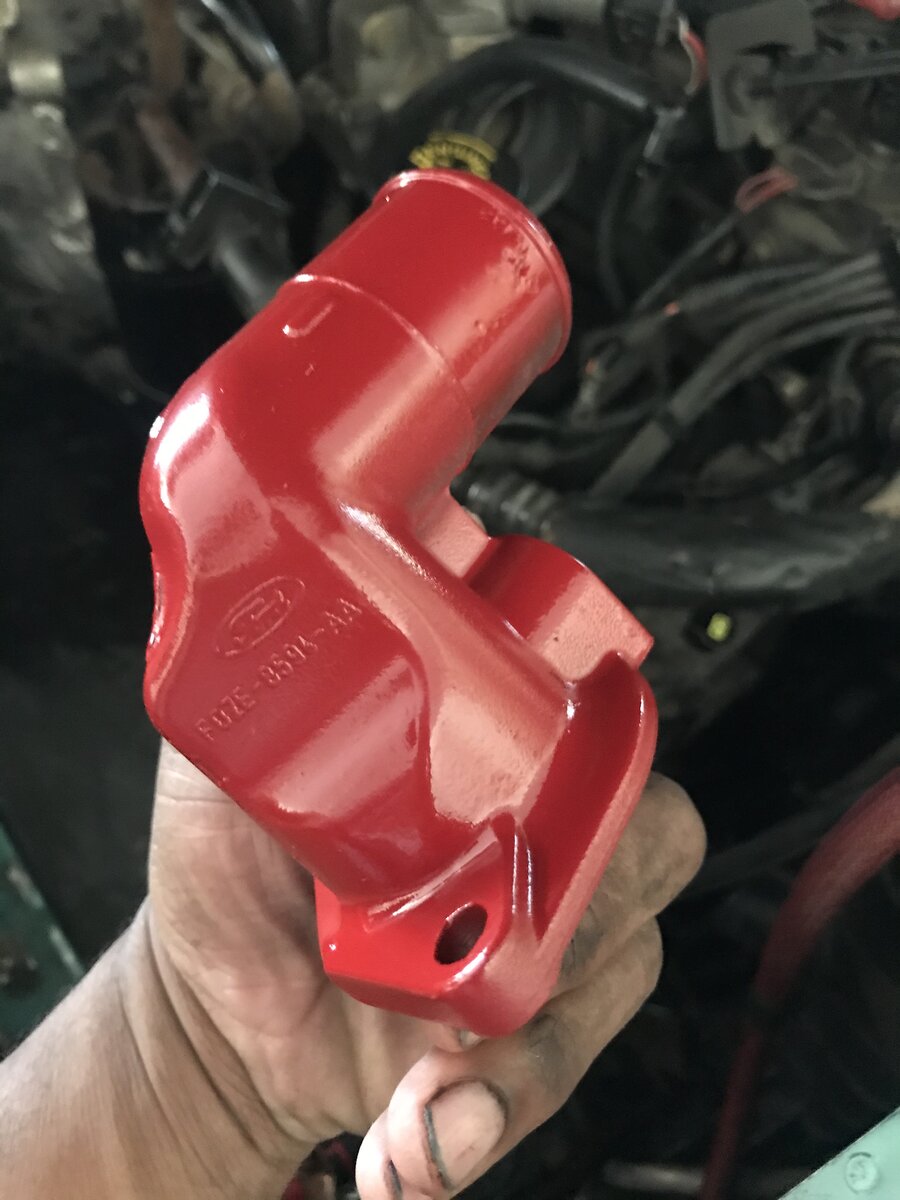

I’m like 99% sure l it was the original thermostat that came in the car I think it got stuck closed it took me like 10 minutes to pry it out of the housing it was seized with scale to it. Waterpump is 100% the original. I got my crankshaft position sensor connector In and the timing cover gaskets. Never gone this far in an engine and I’m trying to make sure I do everything I should to avoid having to do this again in the next decade 😅. I really need this vehicle to be reliable for next few years it’s no longer just a fun project. So I have a new...
Water pump
Thermostat

does it make sense to go ahead and change timing chain, harmonic balancer, cam sync while I’m here?
what can I clean all this with? The timing cover and stuff? It’s got about 23 years and 170k miles of neglect covering everything on the cover 😒
