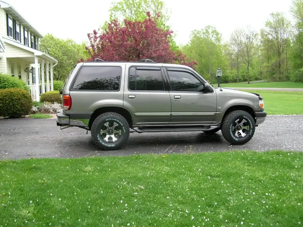

since i have been here a little while and not posted any pics or such... thought i would give it a try..
i have a 99 awd, v8 ex.
have done the tt, and cheap shackles ,
have swapped the awd case for a 4406 e with tod,,
modified tod, brown wire,, to give me 4wd hi by flip of switch..
have not , figured out how to make a way to switch from 2wd to 4low, with out shift motor... from in the cab.. did not have to install shorter fuel tank for my swap..
used a 1998 expedition case, that has 2wd, 4wd hi, 4wd low, and tod.
use the driveshafts from same truck..
cut the front drive shaft splines down by 2-1/2 inches.. all fits
and functions..
and group 31 secondary battery mounted behind grill guard.. for extended camping power
