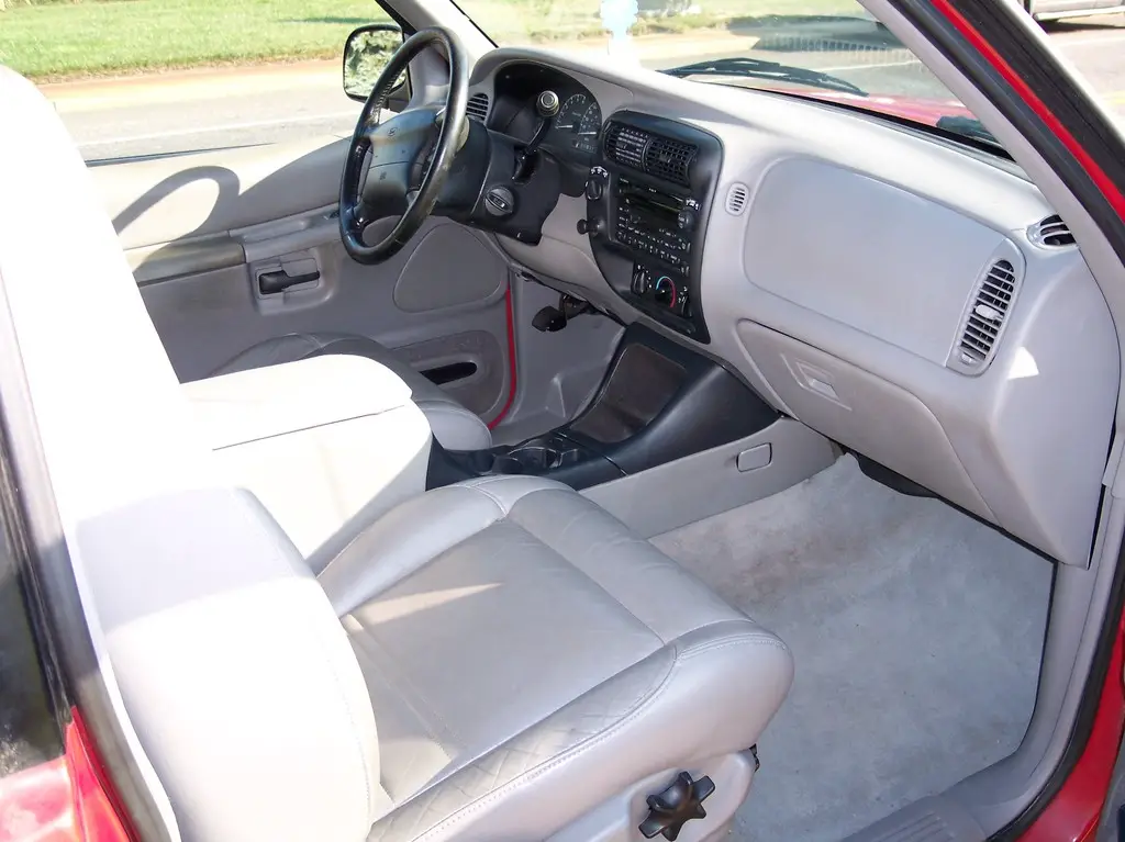

Pulled the front seats, console, & the rear seat bottoms & replaced the carpet I got from a parts truck. Cleaned the used carpet before installing it, the old carpet had so many stains it looked like the person who owned it before spilled coffee in the truck several times. I also cleaned the console as that was dirty too.
Looks great Mike. Nice job.
Lookin very clean. Found quite a few parts trucks my self in the area... trying to find a sport that has rocker panels in decent condition is a seriously challenge for me.

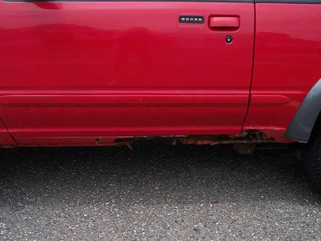

I have not found a Sport with good rocker panels. I bought the 2 door rocker panels from Rockauto & I am going to cut out what I need & fab what I have to from 18 ga steel sheet to make the rest. I will post pics of my progress. Drivers side is the worst side.
Found an 01 sport that had only 98k on it at pick and pull today, and even the rocker panels on that thing were literally crumbling in my hands.

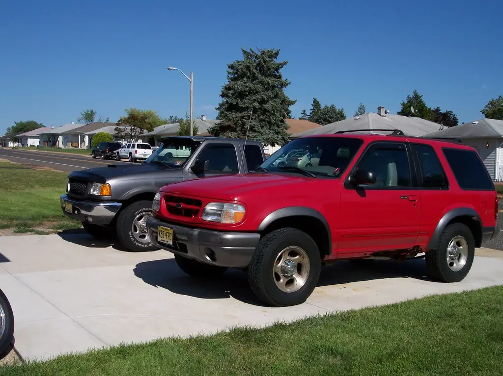

Today I changed the engine oil & oil filter, replaced the r/s upstream O2 sensor due to a CEL PO135 code & replaced the rear timing chain tensioner. The old tensioner seemed weak, the new one was a lot stiffer. The directions said to soak it in motor oil for 12 hours before installing, which I did. Here is a pic of the Sport with 2 of 3 of our other Fords, my DD 2000 Ranger, & my wifes current DD 2008 Escape. My 69 Mustang Coupe that I am building is tucked away in the garage.

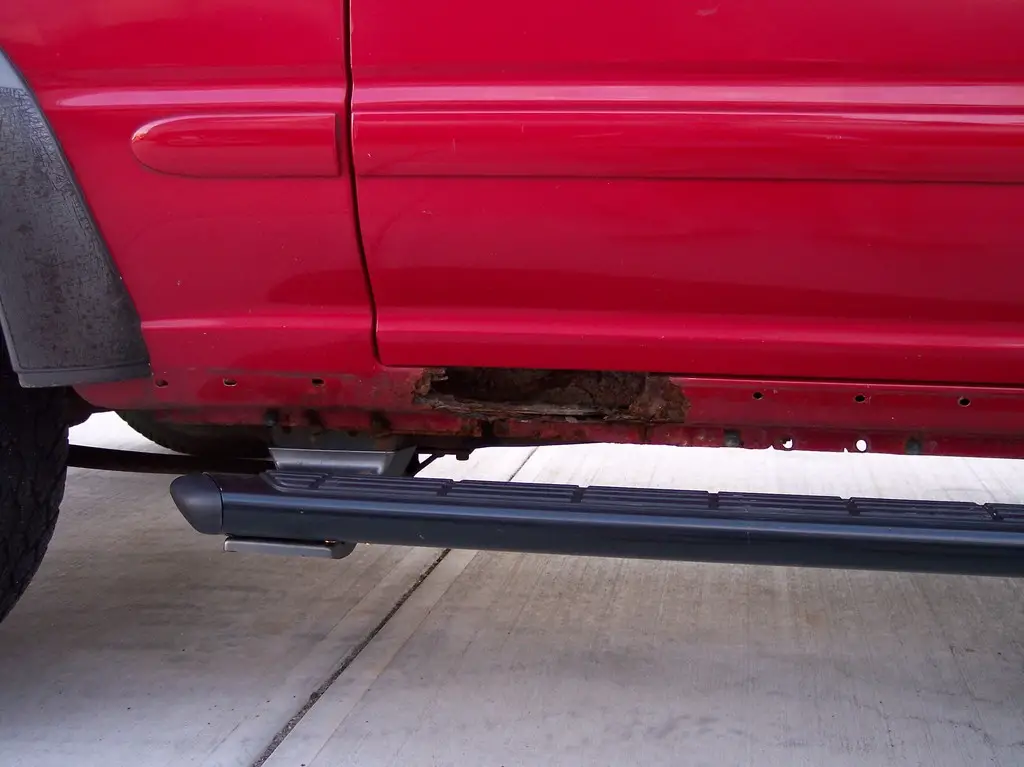

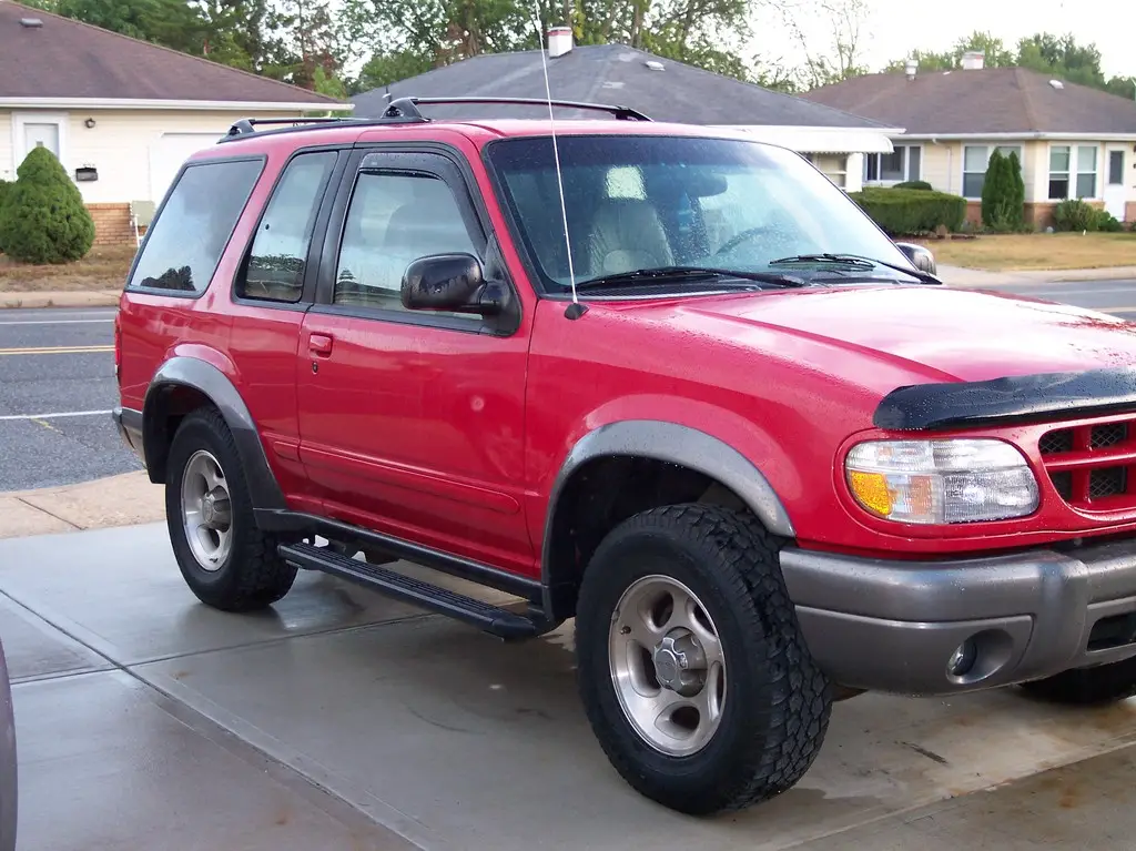

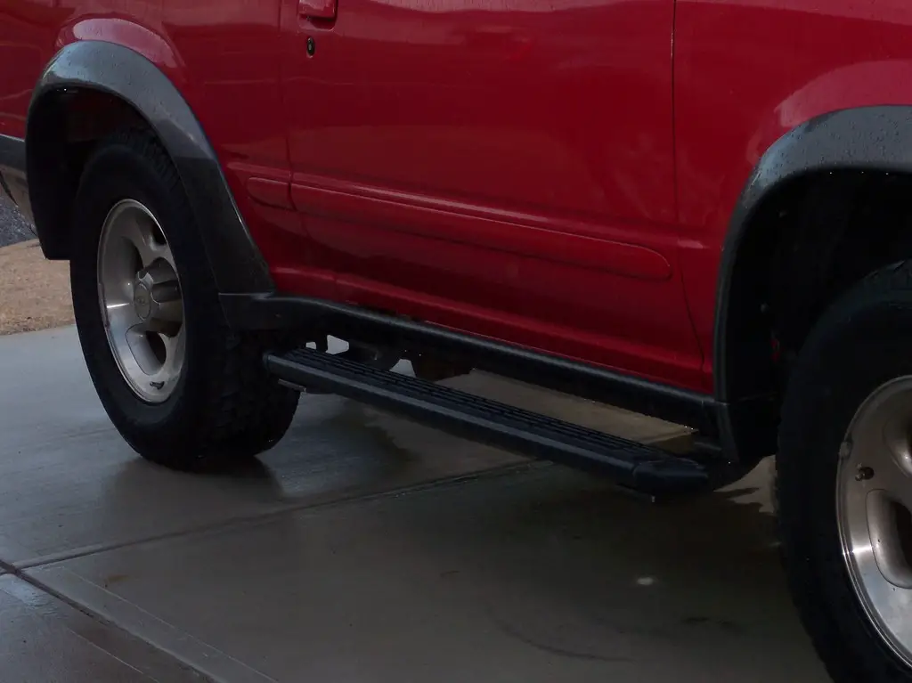

Today I did a test fit using an idea from a member here (tbirdman) where he used 06-11 Ranger step bars to replace the Explorer Sport step bars that always rust out. Well the one on the drivers side of our Sport was very badly rusted & could not be saved. I was able to find a set of the Ford OEM 06 Ranger step bars on E Bay for a GREAT deal. Where tbirdman used chrome ones & ones from an extended cab I used ones from a Ranger regular cab which are a little shorter. I left the front & rear Sport factory step supports in place & removed the center one & placed the Ranger step bar on the supports & I have it bolted in place with 1 bolt in front & 1 in the rear that line up with the Sport step bar supports. What do you think? I like the look with the step bars black they match all the black trim on the truck.
Yesterday I removed the r/s rocker panel molding & saw the rust hole is a lot less then on the drivers side.

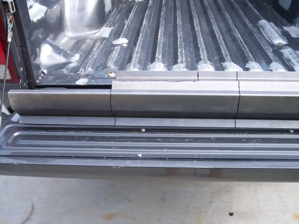

Today I did some preliminary work on the r/s rocker panel patch piece. Marked out on the patch piece where I need cut it.

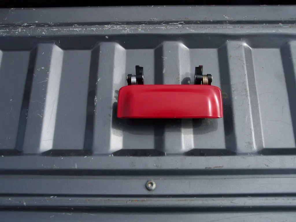

I also painted the new l/s exterior door handle.
