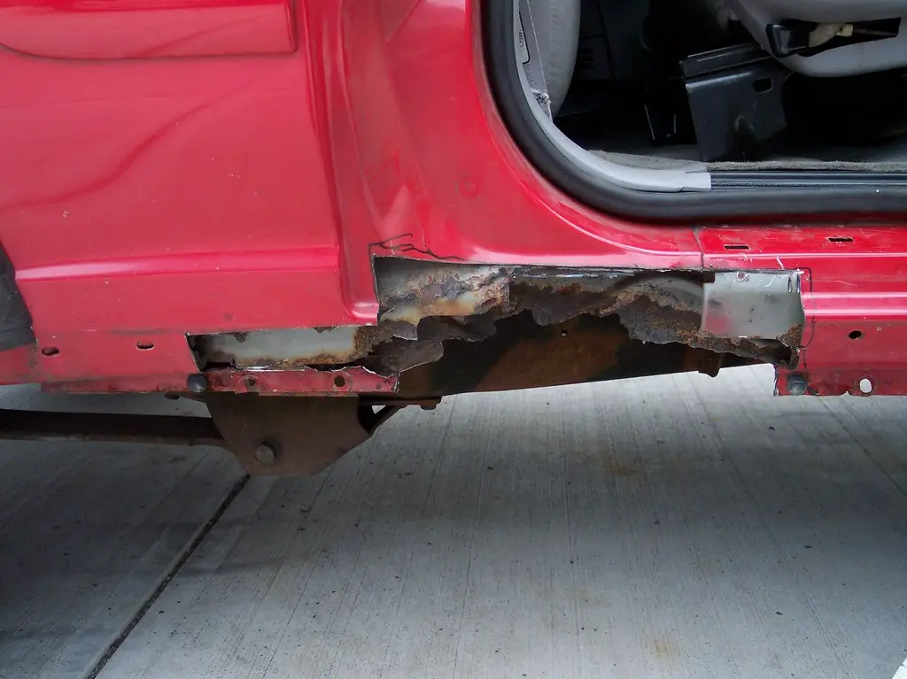

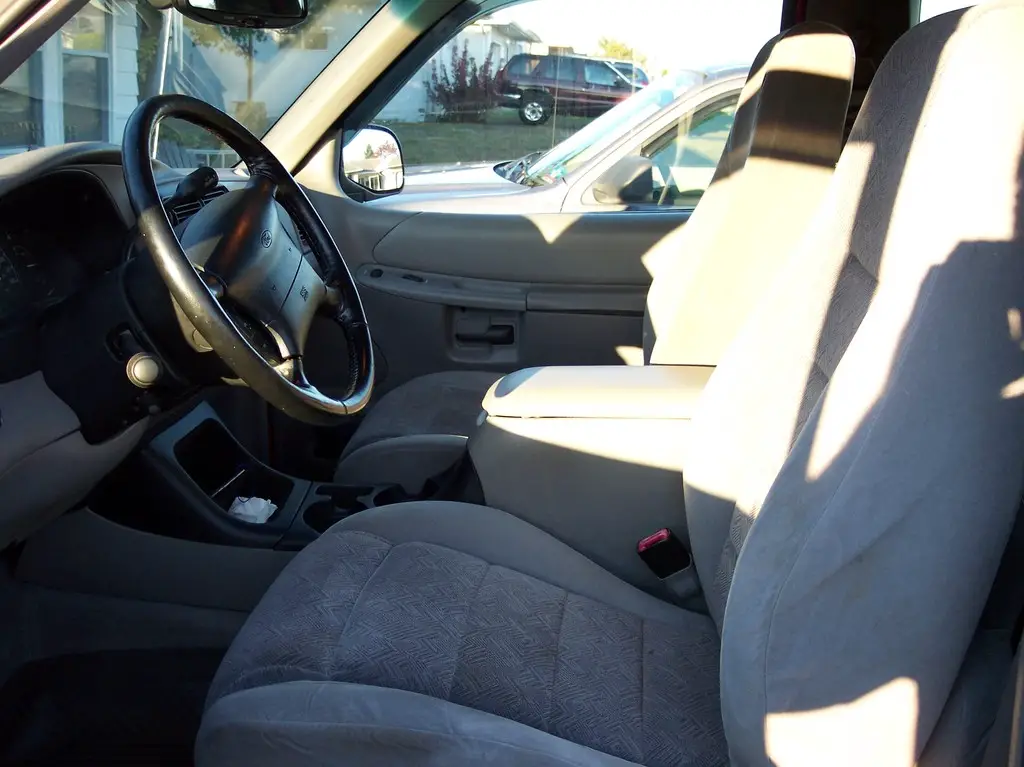

Yesterday I picked up a set of cloth seats to replaced the leather seats. I installed the rear seats & removed the covers from the drivers side front seat so I can clean them without getting the foam cushion wet. I also started tackling the rust hole on the r/s rocker panel.
Here is the rust hole in the r/s rocker panel.
I cut away almost all the rust, there is just a little more to remove from the inner rocker.
I got the seat bottoms back from the upholstery shop Thursday after they redid the side bolsters on both seat bottoms. Today I re-assembled the seats & installed them in the Sport.
I also cut out the rest of the rotted section of the inner rocker panel, & made the patch panel.

And the switch from leather to cloth - just personal preference for cloth?
Both my wife & I do not like leather seats, prefer cloth.

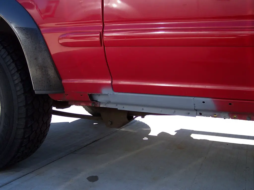

Finished welding in the patches & put a light coat of filler over the seams & primed it.
Shot a couple coats of E4 red paint on the repaired area. Now I just have to re-install the rocker panel trim & the r/s step bar & then it is on to the l/s.

Today after work I installed the r/s rocker panel molding & the r/s step bar.

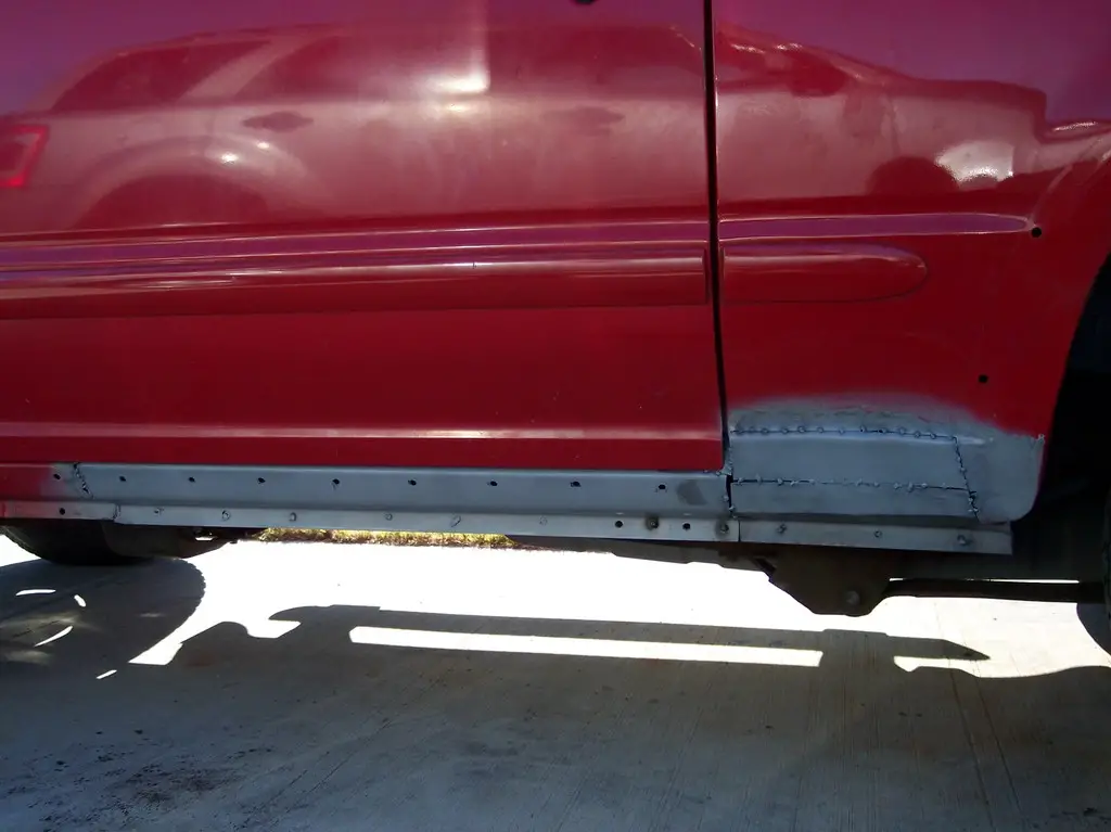

Today I fabbed the 2 patch pieces for the l/s inner rocker panel & welded them in place & shot them with some primer.
Today I started welding in the main section of the replacement l/s rocker panel. Now I have to fab a piece for the l/s lower quarter panel.
Today after work I did some more welding on the rocker panel. I also drilled all the holes for the rocker panel trim & the step bracket & shot it with some primer.
Today I was planning on working on the l/s lower quarter panel but the weather had other plans, slow steady drizzle most of today. At least it was not a complete waste of a day I fabbed the 2 pieces to patch the l/s lower quarter panel.
Today was a much better weather day so I spent a few hours starting to weld in the patch pieces for the l/s lower quarter panel & shot some primer on it.
