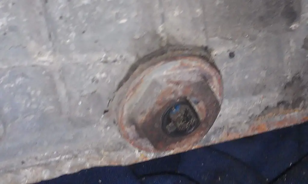

message center inputs
I checked my 2000 wiring diagrams. The sensor in the oil pan is the "engine low oil/temperature switch" that connects to the Message Center. The sensor has three wires: BK/WH (GND), DG/WH (temp) & WH/PK (level). The Message Center has no connection to the PCM so there should not be any fault reported.
