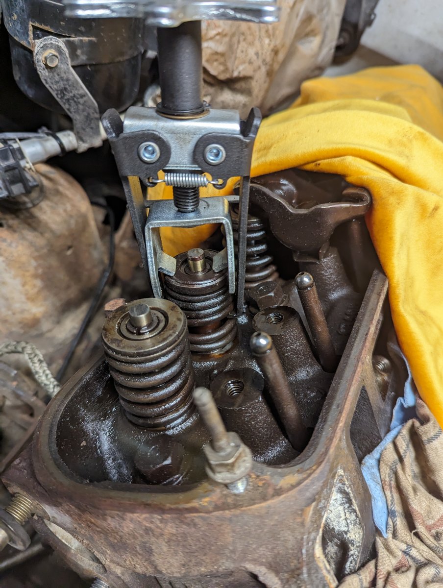

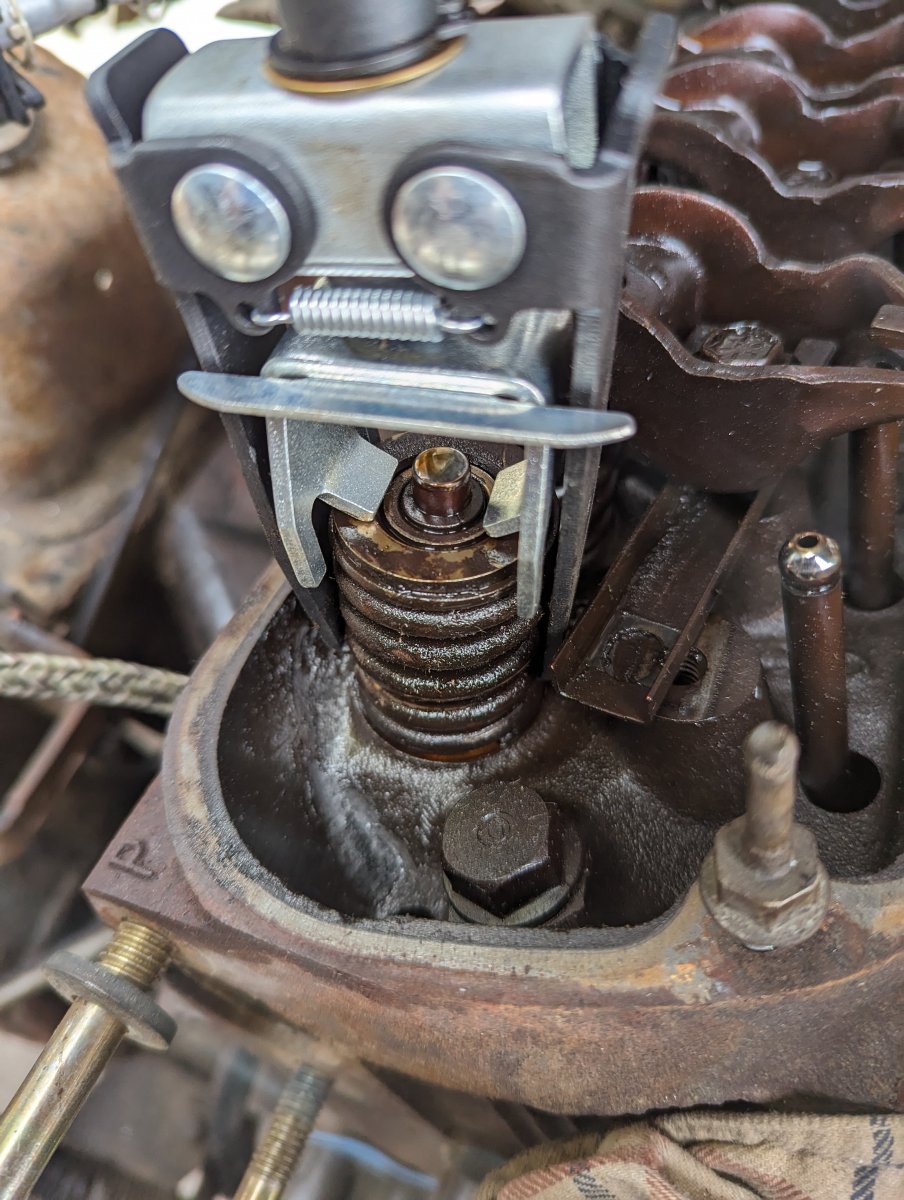

Do I need to bend the silver legs of this spring compressor out so they're not on top of the inner circle?
This is all new to me and I'm struggling haha
That should work just like that, the inner most part is the keepers, the two halves you can see the seams. Outside of those is the valve spring retainer, which in that case includes a rotator device. Ford put those on most exhaust valves of their engines. Nobody uses them in their rebuilt engines or high performance. Some remanufactured engines may have them, they're not an important item.
Pull all of the pushrods and inspect the ends carefully. They should all look just like the one you have pictured, not cracked or bent etc.
Hmmm okay. The inner rotator should drop with the retainer right? Seems like it's staying against the keepers when the spring and retainer comes loose and that's not letting me pull the keepers.
The spring compressor you run down a 1/2" or more to make space for the valve keepers to be removed. I haven't had a rotator/retainer in hand since about 2001 when I rebuilt my first 302 HO engine. I was discarding those parts, so I only glanced at them to note what they looked like, that odd device nobody keeps.
So the compressor should be against the top of the retainer enough to engage everything but the keepers. It's held together by the spring force pushing the retainer against the keepers. Just be sure the valve doesn't fall if air is all that holds it up, other than that you can do whatever it takes to get the keepers out. Then you release the compressor, which let's it all come apart and leave the valve behind. Change the valve seal and/or springs etc, and put it back together. Be sure the seals hold tight, they should take some effort to put onto the guides in the head, so they don't easily fall off later.
Sounds good. Maybe I just need to crank the compressor down harder. I'm using the rope-in-the-cylinder method instead of air because the adapter I got isn't long enough on the threaded end (first bad tool I've gotten from harbor freight in a while).
That's good, with the cylinder filled to hold the valve up, you don't have to worry as much that it will fall too far. Work with the compressor, you can push the valve down a good 5/8" before the spring gets fully crushed. Take it easy, once you get the hand of doing the first one, the rest will be easy.
Do the keepers ever fuse to the rotators or retainers? I fully compressed the intake spring and still couldn't move the valve/keepers relative to the rotator. Then I tried the exhaust valve and it was the same story.
Maybe I'm doing something wrong, but after reading a lot and watching YouTube videos, I'm not seeing anything obvious.
I haven't R&R'd many springs on the engine in a car, just twice. Both times it took a mild tapping on the top of the retainer to knock it down, off. Someone else will chime in, I think hitting the retainer is the proper step, but I'm not familiar enough to say how hard. The valve falling was my concern, and that was in 2001 on an engine I was about to remove to rebuild anyway. The 2nd time was helping a friend, with air, and he hit the retainers with a mallet and screw driver mildly.
The keepers are a tight fit inside the retainers on purpose, you have to break that bond loose. With the valves supported, you can be more forceful because there's no worry of the valve falling but pushing it down(loosing the air pressure seal). I'd smack it good with a mallet if you have one, or mildly with a hammer. Any narrow punch or screw driver will do, you won't hurt the retainers etc.
Also try hard to get the compressor as far to the bottom coil as possible, the more you can squeeze it, the easier the keepers will come out. A magnet may be helpful to lift them out depending on how tight it is when the retainer is down.

Get the spring compressor down on as many coils as you can, once you insert the black “legs” twist it like a screw down the spring until it won’t go any further. Then tighten.
Yes the silver tabs must clear the keepers
You will need to smack each valve with a hammer to shock the keepers so they come free more easily
Cool, that's how I did it. I ended up bending and re-bending the silver tabs to have them fit onto the rotator but not the keepers. Mallet on the valves after soaking seemed to help.
