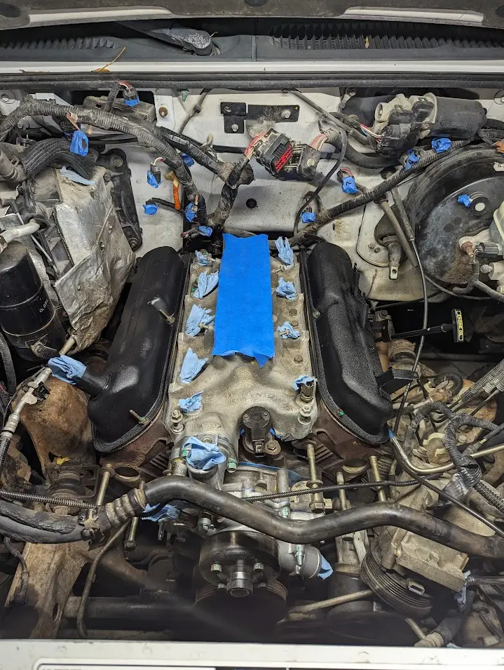

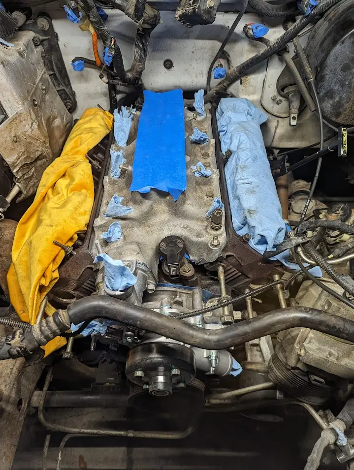

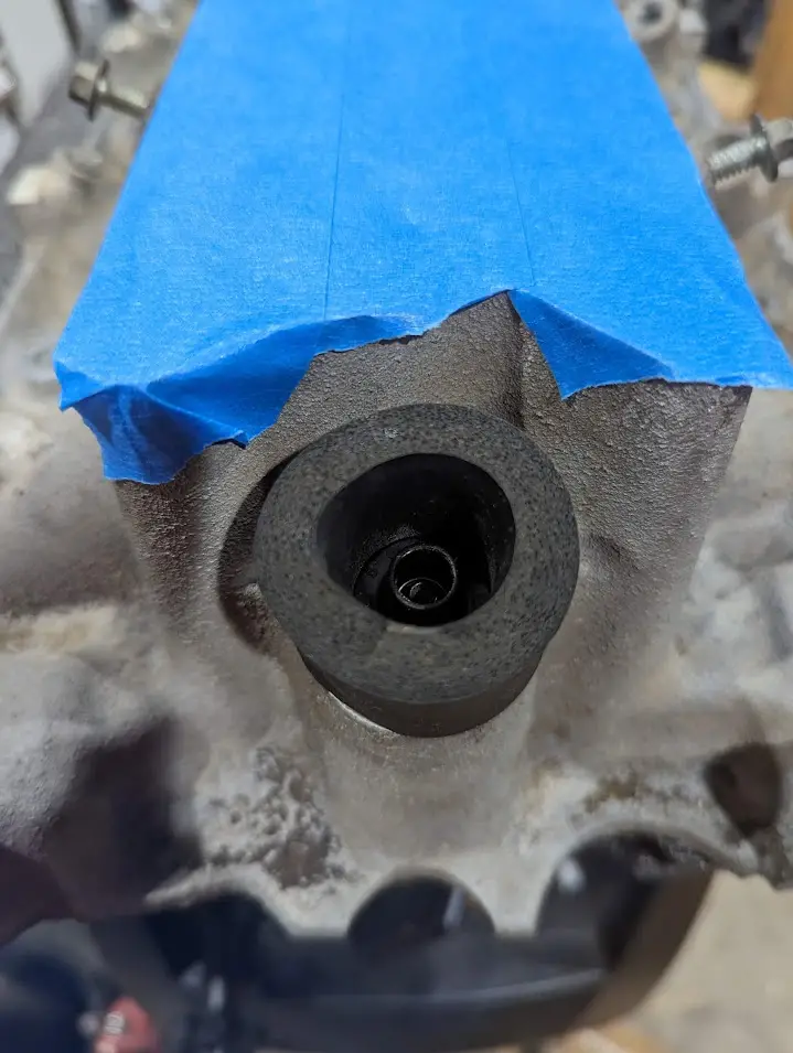

I finished up the lower intake last night. Installed a new PCV valve before it got hard to reach. I have a new grommet too, but it fit looser than the original one, so I cleaned the crud off the original and put it back in. Also put on the "donut" from the salvage yard '98 -- it's in surprisingly good shape.
Intake is on!
And because I got excited, I kept going and torqued the rockers back down, cleaned the heads more, and installed my repainted valve covers with fresh gaskets.
It's looking like an engine again!
Intake is on!

I like to use a thin film of permatex on the pcv grommet to make sure it stays in the lower intake. Also was the screen clean? (Under pcv)

I may pop it back off and wipe on some silicone outside the grommet before the upper intake goes on and it gets so hard to access -- I like that idea for good measure. It's funny you mention the screen, I've read about them on here, but there was no screen in my intake. When I looked in the hole it went straight to the baffle.I like to use a thin film of permatex on the pcv grommet to make sure it stays in the lower intake. Also was the screen clean? (Under pcv)

There is a metal screen under the pcv valve lol no biggie they are usually very clean

I did look into the PCV hole when I was deep cleaning the intake to get aluminum dust out and I assure you there was no screen in there. Maybe it got punched out long ago?

The oil baffle underneath the PCV and its grommet, is a round steel thing about 1.5" deep/long. It's a simple chunk of steel wire bunched up in its round metal housing. It just catches oil mist, and the oil drips back down into the intake. If the engine is a gunked up type, from bad oil etc, then that screen will be full too. You never need to buy one unless it's missing. Simply take it out and blast it with carb and brake cleaner, good as new; drop it back in before the grommet and PCV.

The baffle in mine is a stamped piece of steel riveted to the inside of the lower intake manifold. It covers the bottom of the PCV valve and blocks oil spray from the valley. There was no round piece of steel that I saw and definitely no steel wire. I scrubbed pretty well in there and although a lot of carbon crud came out, I never saw or felt anything like what you're describing. Is the screen something I can/should buy and shove into the PCV hole before I put the grommet back in with RTV?The oil baffle underneath the PCV and its grommet, is a round steel thing about 1.5" deep/long. It's a simple chunk of steel wire bunched up in its round metal housing. It just catches oil mist, and the oil drips back down into the intake. If the engine is a gunked up type, from bad oil etc, then that screen will be full too. You never need to buy one unless it's missing. Simply take it out and blast it with carb and brake cleaner, good as new; drop it back in before the grommet and PCV.
