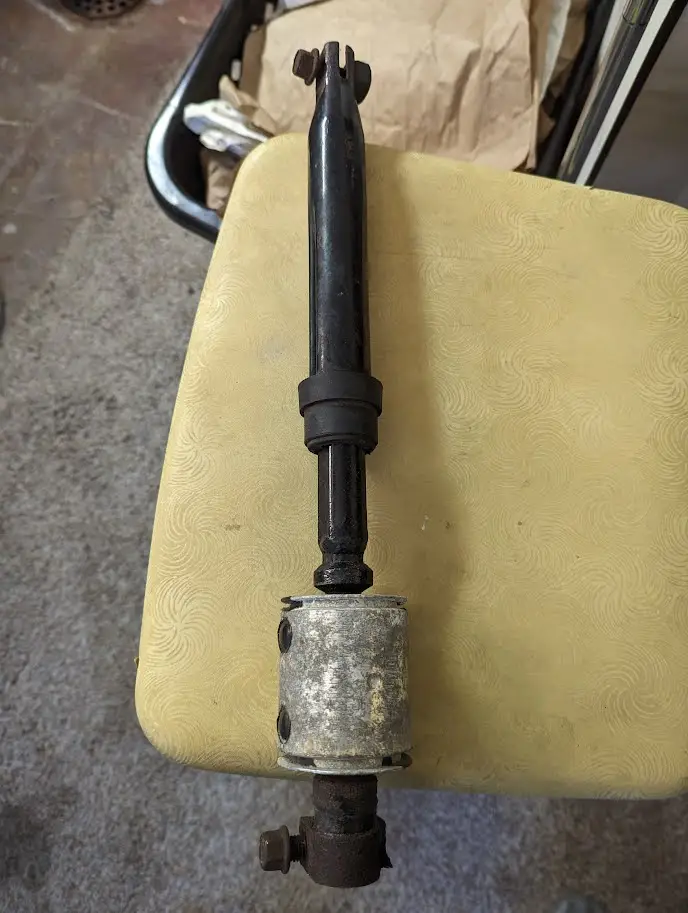

I found the shaft I pulled from a '96 which I had been hanging onto to put into my '97 (which had a shaft that looked the same). Since my '97 Explorer was scrapped, the '96 shaft has just been sitting among other misc. parts. I noticed a few things:
  • '96 shaft has a CV style joint, unlike the later double cardan style joint
  • '96 shaft is larger, about the same OD as the plastic piece on the '99 shaft from the V8 Mounty
  • '96 style has two boots (removed in picture below) which are quite different from the later style single boot
  • '96 shaft is clocked the same as '99
I aslo looked at my '00 shaft and it's the same as the '99, minus the tan plastic part. I think the plastic shield was only used on V8 trucks?
And the '00 boot is equally torn.

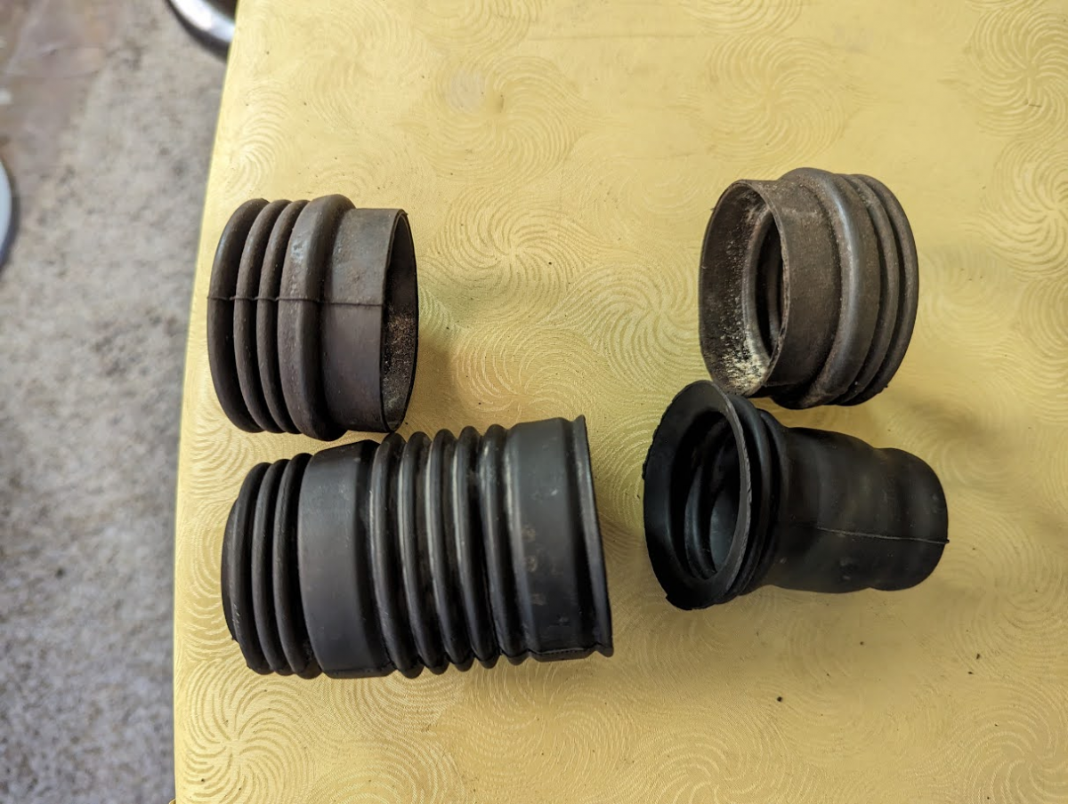

After looking at the early boots, I think I can splice them in with a later boot to make one good one for the '99 shaft.
Splicing the boots together worked well. I ended up making 1" wide bands from bike inner tube to hold the seams together.
I definitely think it will keep the grit out. Time will tell how the inner tube holds up to the heat.

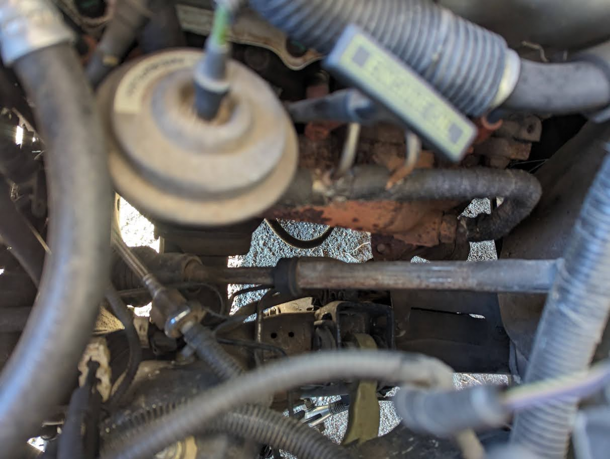

Finally got my hands back on the Mounty tonight. Last I messed with it was just tarping the engine before the first big wave of snow we had a couple weeks ago. Unfortunately, with all the wind the tarp didn't do anything but trap blowing snow under it. I'm going to keep trying to brush it out of here before it melts and re freezes next week.
Luckily I had most every connector taped over and almost every opening with a rag in it.
The main reason I went back in here is because I'm getting closer to having headers and wanted to evaluate the EGR line situation. I bought a new line to modify to work with the passenger side TMH because I think some bending will be required. I need to get the valve off the old pipe first to mock things up and confirm, but it's so cold here, I couldn't get the gas flowing from the map torch. I brought the torch in the house, so hopefully tomorrow I can get the valve broken free from the old pipe.
You will need to do some bending to the line to make it fit the tmh yes.
A Leaf blower is good for removing unwanted snow under there!
Warmer temps are coming!!
I literally broke a vice that had egr valve clamped in it, using a 5 foot chunk of cheater pipe. There's that
At that point just buy a new egr line and valve lol lol
Were you using any heat?
You found the weak spot in that vise!
Can use some anti seizes on the threads when you put it all together
The last set of tmh I had came with a custom egr line so did the obx headers I have
I used to have to make the egr lines of you could not bend them enough. The factory one has the accordion section, the newer ones do not. I keep these in stock because I work with them so often
Fan clutch on a 97 f350 boy oh boy! I bolted a vise to my flatbed and had a 8’ cheater pipe… it finally let loose and I bent the pipe
All so I could Re use the fan clutch and then a few years later I bought a new one lol lol
I tried torch I tried air chisel I spent days working to free that sucker. Moral is if heat and cheater don’t get it, you need a longer cheater. I was literally hanging from the bar
After soaking in penetrant for a day, I came at the EGR valve with the torch. Didn't make a difference. Ultimately, the hex of the fitting deformed and when the wrench slipped, the valve itself got bent. At least RockAuto had one closeout Standard Motor Products unit left...

I was messing with my passenger header on the engine tonight to get a better idea of how I'll need to modify the EGR tube. Looks like I'll need to bend the angle where it connects to the header to pretty much 90 and maybe shorten that leg too. Is it easier to re-flare an end or just section and re-weld?
