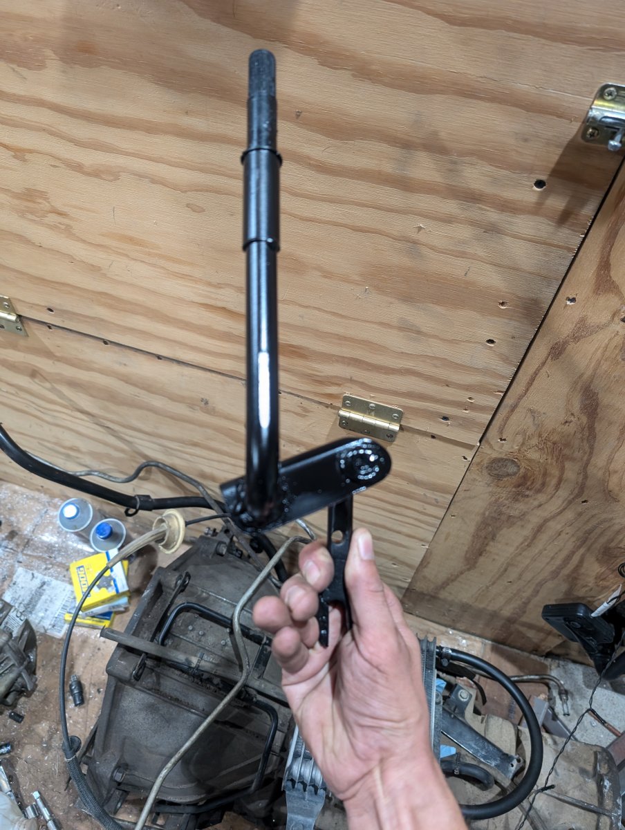

I got my Tcase shift lever done last night and will paint it today. Probably just Rust-Oleum for that, then leave it to cure for a week. No biggie, I've got plenty of punch list items to take care of.

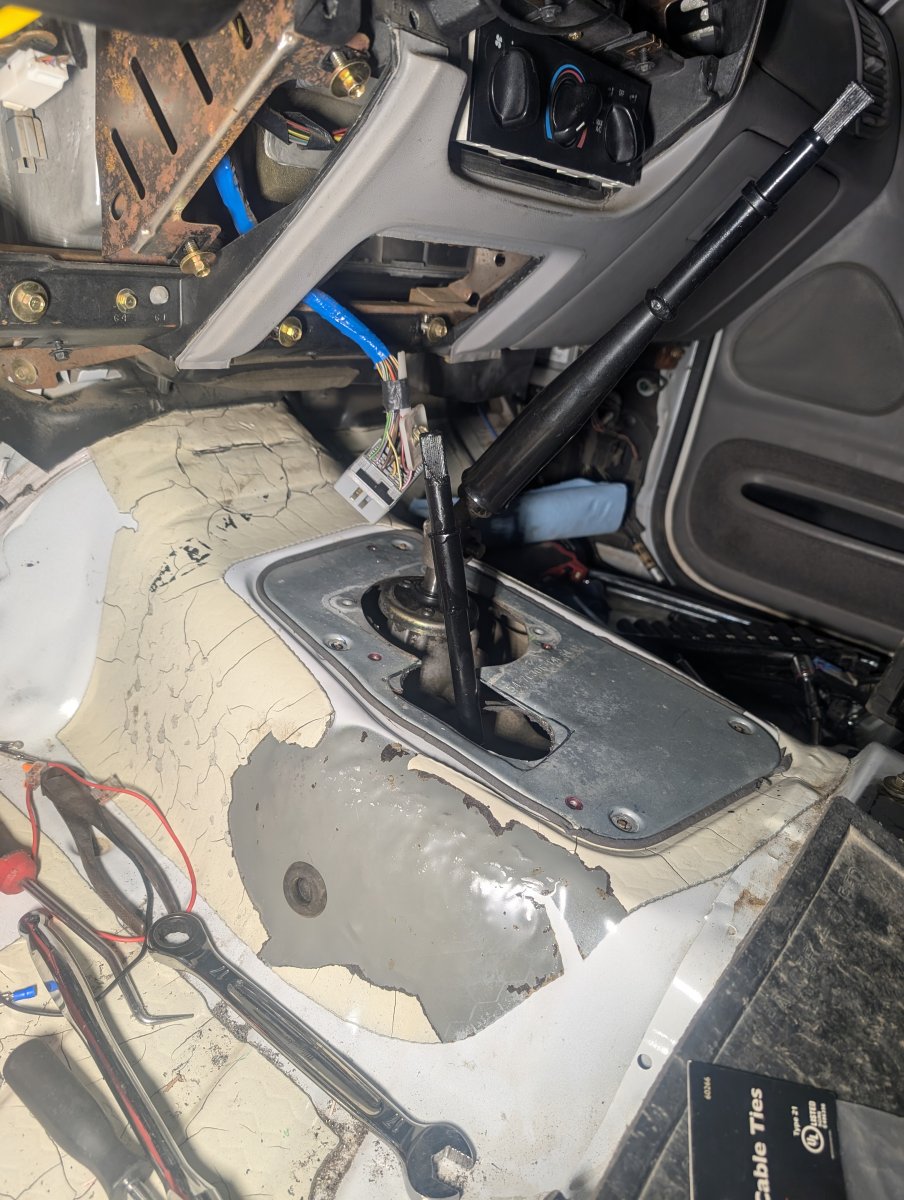

Tcase shift lever is complete and installed.
I had to add an extra 2-1/4" jog in it. Works well now though.
I added an access hole with a plug for installing it

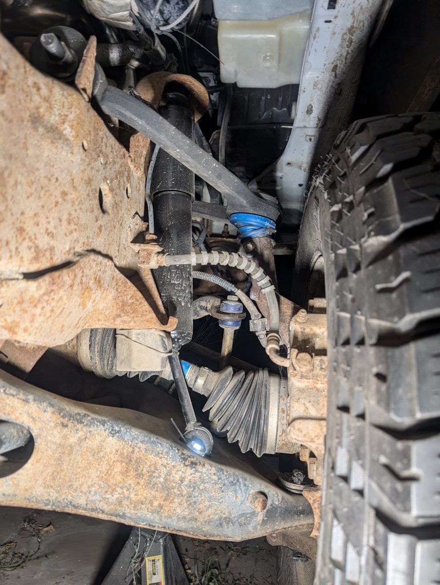

The second resonator should arrive tomorrow along with another front shock to replace this one:
Looks like it bent right at the weld? This shock only has about 100 highway miles on it...

What brand is that shock? What a wild failure!!!
I use a ball joint press and sockets, it shouldn't be too bad.
It's one of the Gabriel shocks, not the $8 closeout rears, but the $22 fronts. I wonder if having the front suspension drooped for so long contributed?
I have like 8 Gabriel shocks nib that looks just like that lol lol fingers crossed!!!
The drivers side is fine, I honestly think it was a fluke. They seem like good shocks overall.
