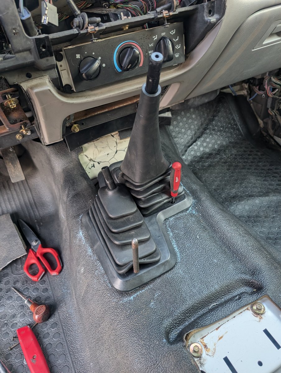

You can cut the wire to the theft light
Very easy to get the key chime wire jacked up those things are finicky
You will see it’s touching ground when you pull the shrouds
Can retain it with a tiny zip tie or small dab of
Glue to keep it in place
The 4x light wires can go directly from t case switch to instrument cluster
You can also find the wires at the gem
Module but you want to cut their feeds to the gem and only send the signal to the cluster
*****in!!! She’s runnin
