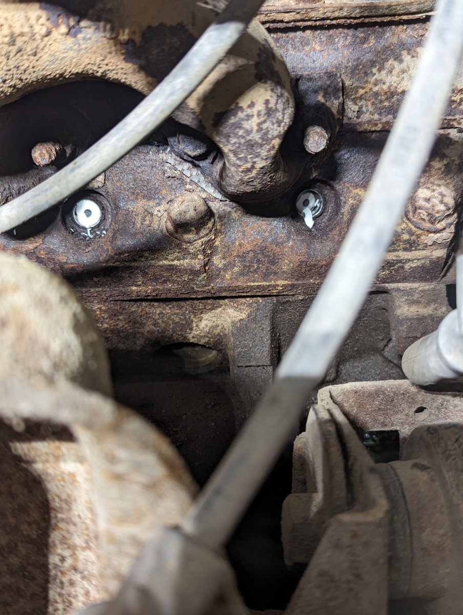

Plug #3 came free after a day steeping in pb blaster. Unfortunately #2 and #1 did not.
Any tips for how to proceed?
Heat and let them soak longer. If you’ve got those metal heat shields around the lug they can be collapsed and removed for better access.
I guess you didn't see the picture haha. Both plugs snapped off where the hex tapers down to the threaded section. Not sure if there's any technique to extract what's left or if I'll just need to pull the head.
Oof. The more time and heat is supposed to come before that. That’s a rough deal. You can try and extract them there, unfortunately pulling the head might be the best route.
I'd try to drill it and extract it.
I did some digging last night and it looks like there are dome decent options as long as you can vacuum the porcelain out. My favorite "extractor" I saw people using is a ground down bolt with a tapered, square profile -- worth a try!
Take pictures, if it works the next guy that has this problem would have some hope, too
You know I will! I try to write my threads the way I'd like to read them.
I also talked to a coworker this morning who is a Ford guy and has worked maintenance for 30+years and he said he might have the perfect bolt extractor for me to borrow. One way or another, we'll get this problem solved!
I’ve had luck getting broken plugs like that out using large bolt extractor after drilling /busting out the middle
Not fun but so far they have all come out for me
The bit I use I’ll get a pic of
Do you have a torch? Need to heat the head around them break the rust bond
I have a couple of propane torches, but I'm not sure if they'll put out enough heat to do anything to the head.
One video I watched, the guy torched the threaded chunk (he used acetylene without oxygen) then hit it with refrigerant to shock the plug end and break the rust bond. I could try the same idea using a propane torch and freeze spray, but I'm a bit wary of cracking the head doing that.
When you say drilling/busting out the middle, you mean the porcelain or the actual steel shell?
Get some map gas it works with your torch and burns waaaay hotter
Here is the bolt extractor I use, the largest one in this kit fits the spark plugs perfectly
