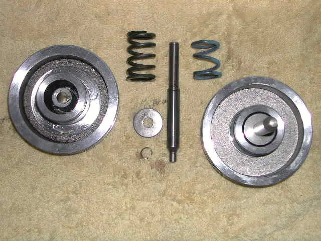

They come in different lengths because there is no adjustment screw for the low reverse band. The correct servo length is selected by measuring to the band, to short and the band won't apply, too long and the band may break. Since yours was broken, and you probably don't have the tool needed to get the correct measurement, I would replace the servo with the same length.
Here's a break out view of the low/reverse servo from Glacier991's photo gallery:

Hello: I would like to thank everyone for their help. I have now located the correct reverse servo and replaced it. The Ford dealer that gave me the BAD information the first time, figured out that the come in different lengths. Imagine that. We were able to measure the one that i had and figure out that it was a one groove. I have a no groove one that i was able to locate at a ford dealer in Austin, Texas. This one is no longer available from Ford. If anyone has a use for it, give me a shippping address.
