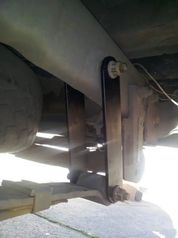

Nothing ground breaking here, it's been done before, but I threw together this lift in a few hours for free using scrap. The front spacer is a 1" tall piece of round tube welded under to the bottom of the stock seat and the rear shackles are 2" wide 1/4" flat bar. Bumped it up about 1.5" and helped compensate for tired springs. Still enough adjustment in the ball joints to compensate for the increased camber.
With some worn out 31s.
