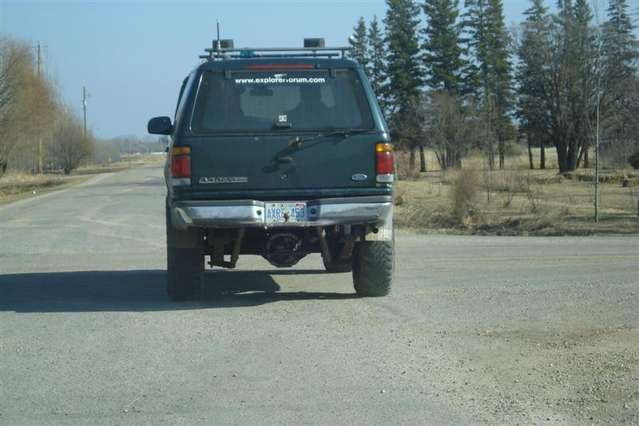

here is a shot of mine from the back, 4 inch lift springs, 2 inch shackle lift and 33x11.5 tires, and so far it doesn't seem tippy to me,
