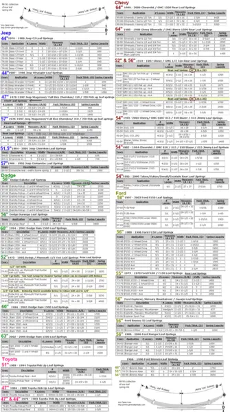

Correct, the 2wd uses the 2.5" springs.
If you can zoom in on this picture, you can see what's what for years & sizes on springs.
Just using the stock Ex main, and the F-150 lowers, you can gain 2" of lift. Add a couple more leafs for another 1"+ lift. I did this and added a 2 leaf (short & long) BDS add a leaf kit, and got around 3.5".
