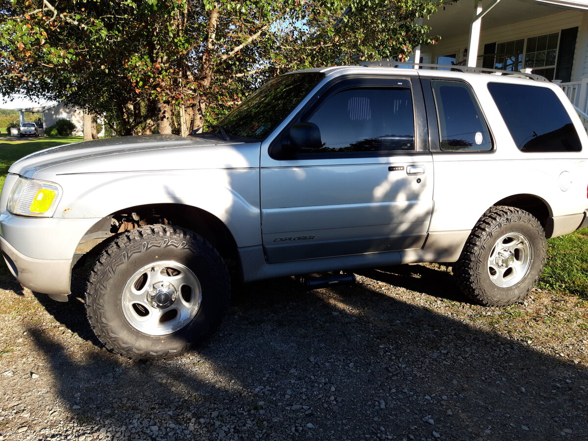

Ended up going with a kit from fatbobsgarage.com. Ended up with 4 inches of lift..
