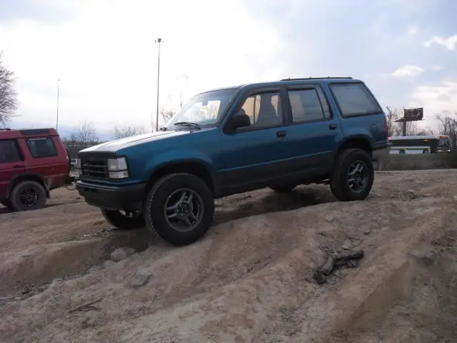

Here is my 92 sport with F150 coil seats, warrior shackles, and 31/1050/r15 Kumho tires. If you go to a proper alignment shop you should have no problem getting it aligned and the camber back into spec.

That looks good! I have a 94 sport and I am about to do the same thing.

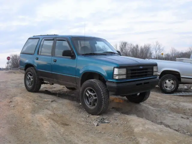

Sorry for the low quality. Mine has aftermarket springs/shocks on the front and warrior shackles and shocks on the back. 31x10.5 BFG A/T KO's.

wow, 2 inches gives more clearance than I thought! thanks

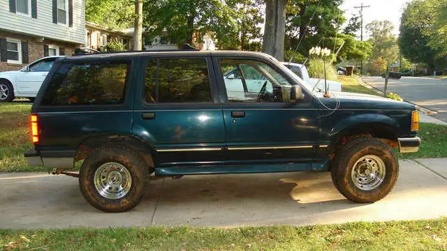

Here's mine with 2" spacers and AAL and Warrior Shackles. It came out to a right at 2" total. The tires are worn 32" BFG ATs. It was able to be aligned just fine. The shocks are Pro Comp ES3000 for 2" lift.

nice x's u guys got there

that looks impressive for only a 2" lift kit, I'd like to improve the stance of my '94 a little bit and that looks like something worth considering :thumbsup:

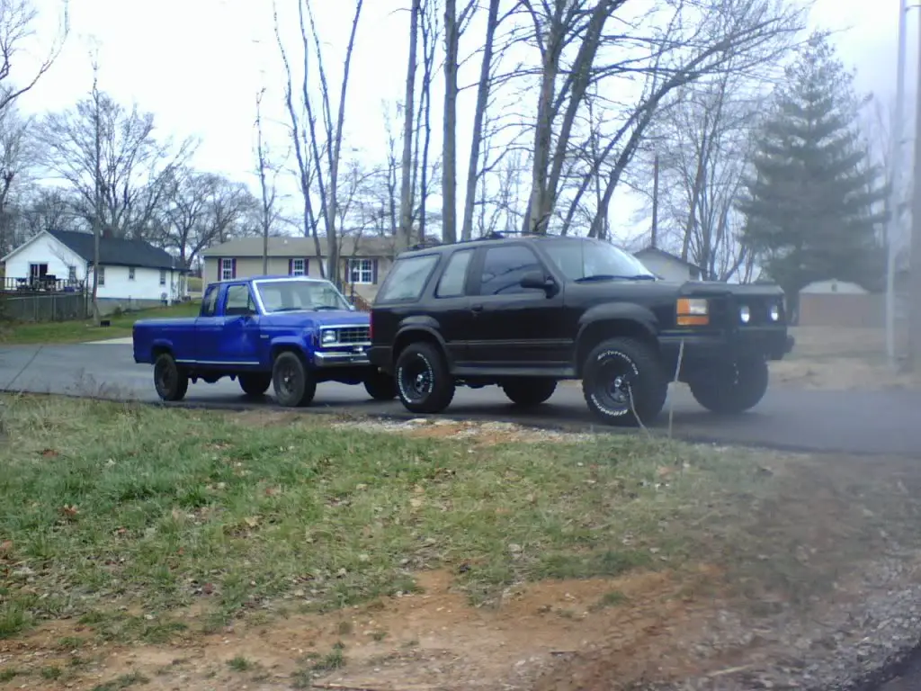

Lbarr2002 what size tires do you have. In the pic it looks like they sick out. I Love the look
