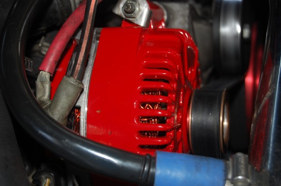

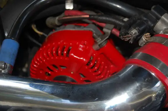

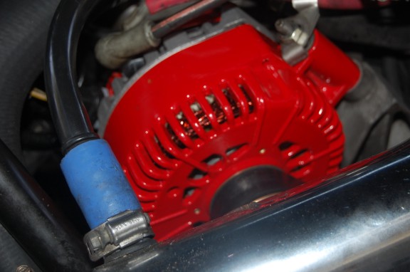

My 130 Amp alternator (http://www.explorerforum.com/forums/showthread.php?t=139789&highlight=130+amp+alternator ) started to not make the grade ( outputting low voltage ) consequently I ordered a new 200 amp alternator from Mr. Alternator ( http://www.mralternator.com/ ). And as you would expect it just had to be powder coated red to match my other under hood components. The price was $275.00 to my door. This company is easy to deal with and they eventually answer all e mail questions; even though shipping was sluggish and I never received any tracking data.
When using a high amp output alternator, one needs to upgrade the wiring. In my case it was not necessary seeing as I had previously upgraded the “big 3” wires ( http://www.explorerforum.com/forums/showthread.php?t=152430&highlight=alternator+wiring ) on my truck.

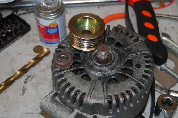

In view of the fact that I used an overdrive pulley ( smaller in diameter than stock pulley ) on the old alternator ( http://www.explorerforum.com/forums/showthread.php?p=1406278#post1406278 ), I moved the overdrive pulley to the new alternator.
The installation is exactly like that of my 130 amp alternator as detailed in the following thread: http://www.explorerforum.com/forums/showthread.php?t=139789&highlight=130+amp+alternator .
The installation took 25 minutes ( including removal of the old alternator and the pulley swap ).
The new alternator puts out 13.4v at idle and 13.4v at 1200 RPMs. A short road test showed 13.4v while cruising at 70 MPH with the AC and lights switched on.
The new alternator unquestionably puts out the juice in addition to adding some under hood bling bling.
Note: the powder coating quality, while very nice, is no where as nice as that of Jon Smith ( jtsmith ).
