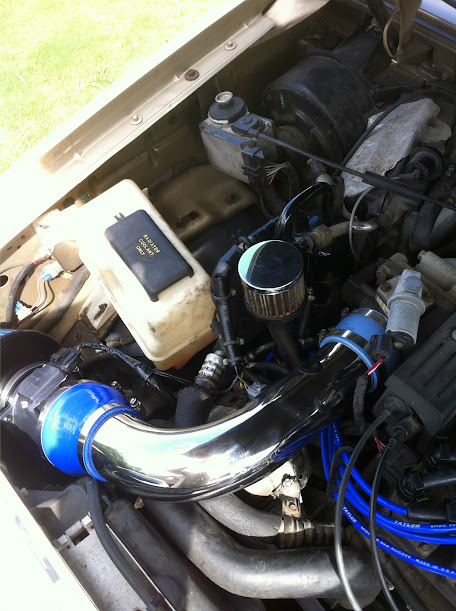

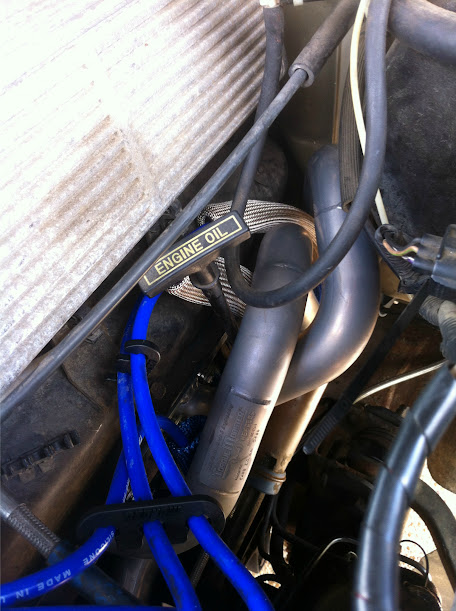

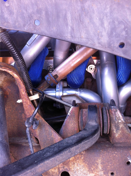

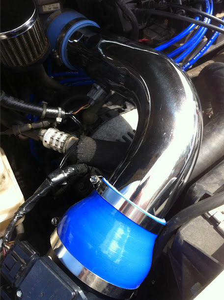

I put in some fresh Autolite 764 copper spark plugs, Taylor 8mm Spiro-Pro Spark Plug Wires, Moroso wire clip things, heat resistant "socks", AMSOIL dry air filter, and the 90mm LMAF. Took longer than it should as I was also keeping my eye on the kids as they ran all over the place and from the melting TN heat.
I tried to run the spark plug wires fairly neatly and I think it turned out pretty decent overall. I have not started the car up yet as it turned out my tune from Henson had the wrong serial number in the tune file (started with XP and not X3) and was unable to load it into my SCT3 :-/

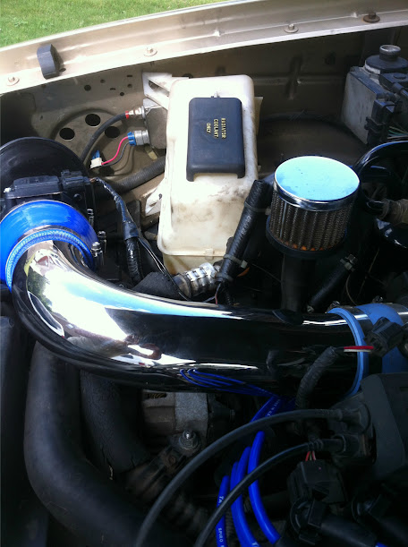

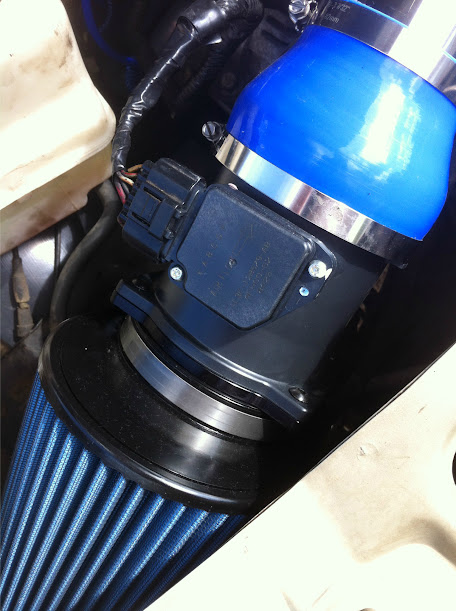

AMSOIL air filter > 90mm LMAF > MAC intake tube:

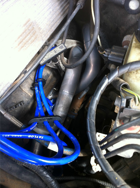

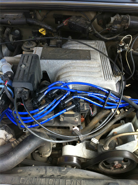

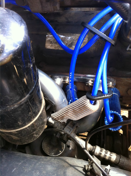

Taylor wires, heat resistant "socks", spark plugs, etc:
I def need to replace that crusty coolant overflow tank with something nice before too long.. It just looks like crap and sits in all goofy lol.
That looks good. Hopefully those heat socks will protect the wires for a long time.
Yeah, I hope so! They seem of real good quality so I think they should.
It was nice that the Taylor wires came with 4 heat socks (for the 4 longest wires) which let me stack 2 socks on those 4 long wires as they come into the most contact with the headers and it let me run heat socks up the wire for a good amount of length to make sure they easily clear any heat source.
