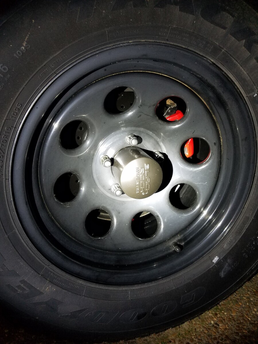

Put the rear wheels back on. Sadly the wheels all have faded a bit from sitting so long, may end up plasti-dipping them if I am unable to get them looking good again (once everything else is done and the truck is on the road again that is lol). Tomorrow I will see about swapping in actual coolant and also see if I can get those damn camber bolts tightened down enough to limp the truck to an alignment shop when I get a few other things finished up. Still need to swap the new AC drier into the truck as well.
I wiped the wheels and tires down as best as I could without actual wheel cleaner and such, hoping that stuff will all help once I get to a car wash after truck is back on the road lol. Can see the red calipers peeking out a bit, they look good! Bad photo as it was dark out and I had to hit the wheel with my flashlight beam :D

Cool, clean brake fluid. Are those wheels painted, are they black? If it's a paint I'll bet you can work on them with typical waxes, polishes of various grits, to remove a layer and get a nice color back.
They are Cragar SERIES 397 SOFT 8 wheels which shows as "2-Piece Steel - Gloss Black Powder Coated".

I gotcha, powdercoat is a tougher paint. I don't know how well it works with refinishing like normal paint. Give it a try and see if the layer below the top is as good as the original.
