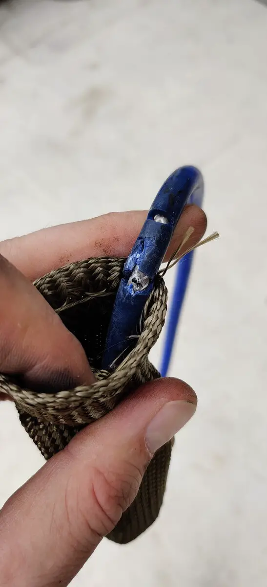

Ok.. Found the problem... cylinder 3 spark plug wire looked to have cooked inside the heat sock.. I had it wedged between header tubes as the wire was to short to route any other way and it came back and bit me, lol:
Heat sock has no marks on it so it pretty much just turned into an oven and cooked the silicone wiring inside.. oops.
I ordered a Taylor wire repair kit and tool... gives me like a 32" 8.2mm Thundervolt wire and then I can cut to the length I want and crimp on the appropriate fittings so this way I can run with a longer wire and route it much safer :)
