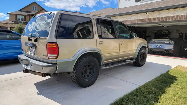

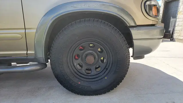

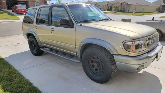

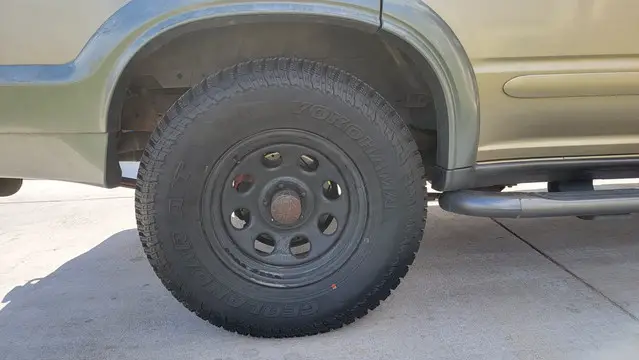

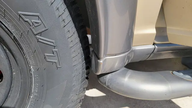

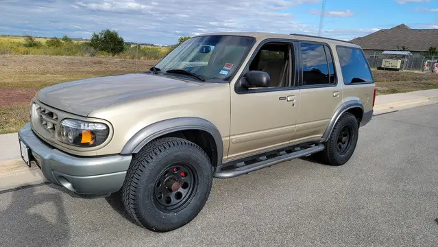

Got the new tires on... As expected the front rubs a little on the back part of the front wheels fender. The car IS lowered a bit via the torsion keys from years ago so I am in process of turning them in and seeing if I get enough clearance. If not, I'll grind just a bit on the corner that rubs.

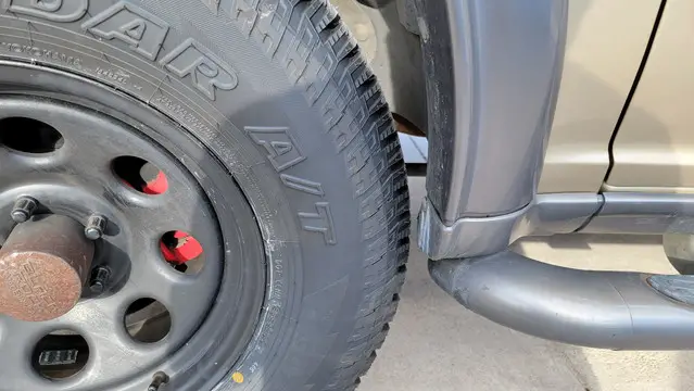

And the problem spot...
Not to bad! I need to clean up and paint my wheel center caps or buy some new ones if I can find any, lol :D
Have some watch for rubbing while you turn into your driveway. Usually the rub occurs at the lower bumper lip. That can be trimmed , and if you take time won't be able to notice.
Edit . I see the rubbing on the plastic trim , you can trim that a bit also

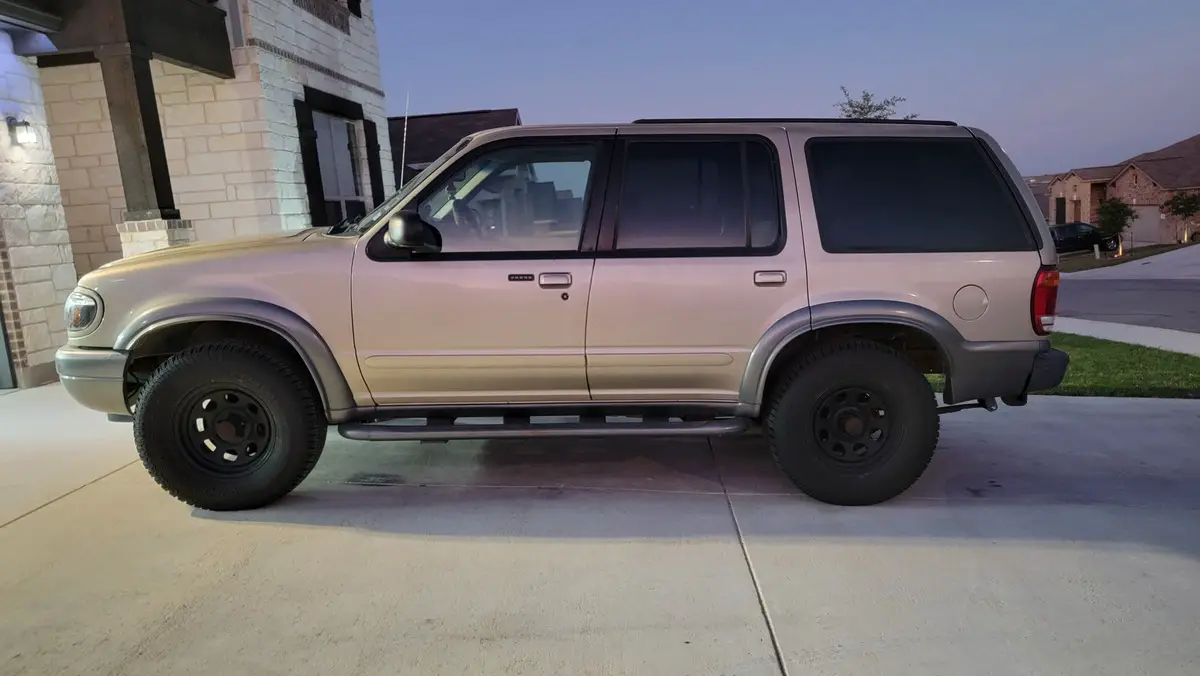

Lifted up the front of the Xploder and screwed in the torsion key screws a good bit more (but still a lot of thread left).. pretty much so the head of the screw is flush with the torsion key covers. Put truck back down and tinkered with it a bit to get both sides even. Car sits at the bottom of the fender lip to the ground at 35" in the front. The front of my running tubes is the same height from the ground as the back of them but the car "looks" to be a little higher in the front compared to the back especially with the extra wheel gap in the front compared to the back. I'm thinking of adding Warrior shackles to the back to raise it up a little more and give me a nicer stance.
I noticed the fender was just bbbaaarrreeelllyyy touching the tire even lifted up some in the front and I didn't want to lift it any further really especially without lifting the back up so I took an angle grinder and just trimmed the inside corner of the fender a bit and it clears now even after driving around and letting the suspension settle. It may bump hitting some huge bumps or whatever but I'll keep an eye on it.
nice fitment!!! the rub on this one occurred on the tupperware, and only when articulating and at lock. but that was with 1" spacer....

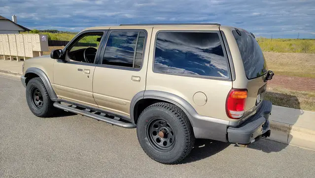

Thank you! I ordered the Warrior 153 shackles and will install those in the back and I think it should sit nicely. Drove the truck a bunch over the past day as did my daughter and have experienced zero rubbing :D

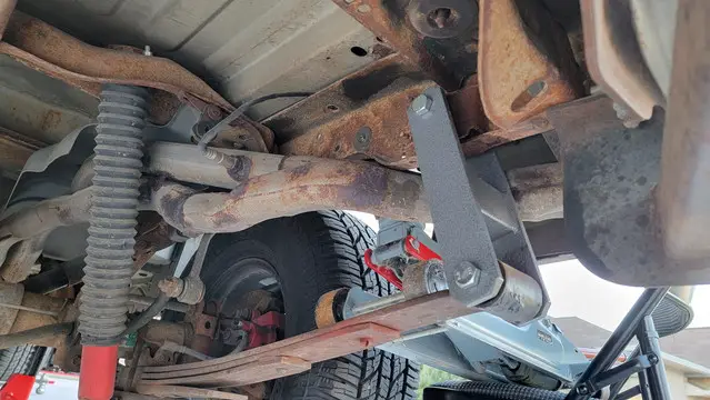

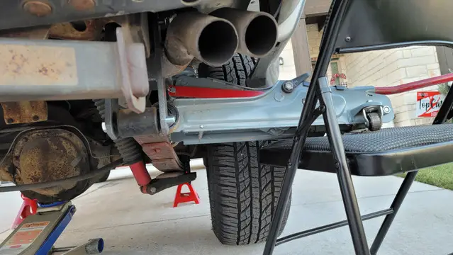

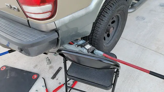

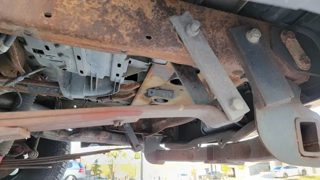

For the lift pros in here... Where do we lift the truck up to get the leaf spring lined up right to bolt in the new shackle?? I have the frame on a jack stand and have a jack under the rear shock mount lifting the tire up.. Is that right?? Also, it seems my shackles had already been changed in the past by Justin probably years ago and he had 2 pieces of metal bolted in place, lol:
With the placement of my exhaust it blocks in my passenger side shackle so I ended up needing to cut the bolt to get it all the way out of the bottom slot and I'm still trying to get the top bolt out, lol. Driver side looks like it will be easy thankfully!

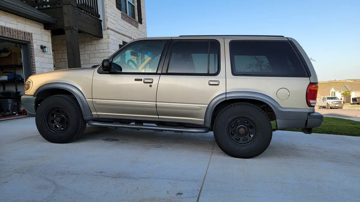

Ok, finished up with the rear end, lol. Had to get a bit innovative on everything, LOL. Ended up wedging one of my smaller floor jacks between the frame and top of the leaf spring to push it down enough to get the new Warrior shackles in place on both sides :D Worked out pretty well!
I must admit these Warrior shackles look a lot better than the scrap metal that was in place, haha. Bolt holes between where they were in the scrap metal and the Warrior shackles looks to be about 2 inches or so difference, maybe a little more.

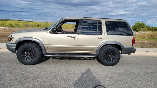

Quick before and after photo... before Warrior shackles and after:

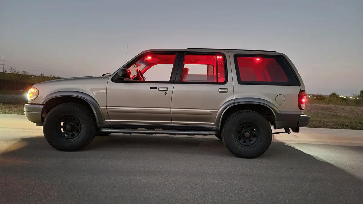

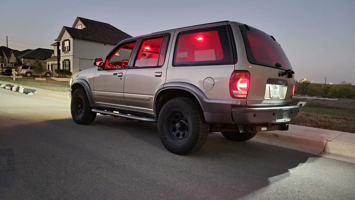

And a few photos I took with the interior and exterior lights on for fun:
